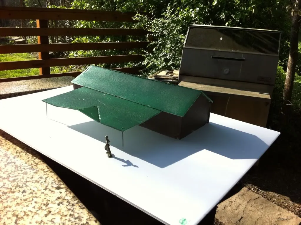

Alright, a cheesy model but I'm just trying to wrap my brain around this long shed roof thing.
Would make it easier to design if we just would put a 10' deep covered deck on front and a 10' sleeping porch on the back, but the other family likes the idea of having the sleeping porch along the front.  You would walk through the sleeping porch out to the deck.

Put a gabled roof in front and it looks much more proportional to me.  Could have the front as a large covered deck and move the sleeping porch back to the rear.
Not exactly sure how to support the front deck/roof since it will be 8 feet off the slope.  Would you have the roof structure go all the way to ground or do you build a beefy deck and support the roof on it?  Or both?  I'm sure this part I would contract but just want to have an idea of what I want before I talk to him.

I think you might try sticking with the shed roof in front. Just from a construction perspective it seems a lot simpler.  But I also think it could look great. I do not think your models do it justice on how it could look. Plenty of old country houses in the South have that kind of long porch across the front.  Of course, yours is deeper so you need to factor that in...but should try some decent sketches. You have anybody that can sketch be good to pay a few bucks and sit with them a while to doodle and noodle it. at this point i don't think you need any fancy floor plans..get the shape you want for the function and then start playing with it.
flyingvan
I'm partial to the gable, but if your preference is having the porch come off the height of the wall there's no reason the wall can't be 2' higher the width of the porch.  You could take porch beams from the ridge straight out to the far end of the porch.  You'd have a little kick out wall on each side where it meets the main roof

Why not shed roof front and back...to me the gable roof in back looks odd. Like it is stuck on...does not flow with the house.
