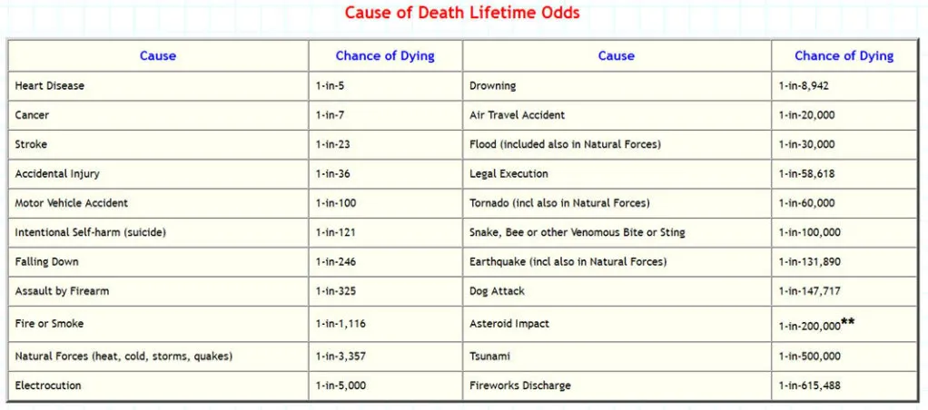

What are the chances of dying in a storm? How does it compare to other risks? A reasonable question to ask, is it not? Life in general is filled with calculated risks we choose to take. Every time we get in the car or board a plane we are counting on being one of the lucky ones who end up at the desired destination.
Here an interesting article on just such statistics...
http://flatrock.org.nz/topics/environment/tornado_season_underway.htm
