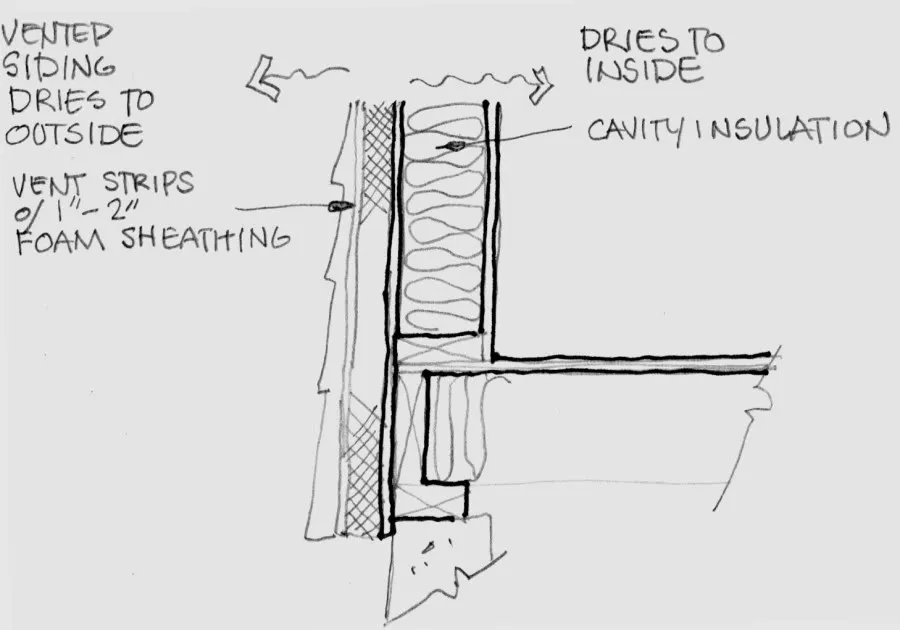

With so many material options and potential issues, it can get confusing. What you want to avoid is condensation happening at the wrong place.  IE: moisture laden air being cooled enough to condense out water inside of materials that can't dry out.
In this example wall system - which I think is about as close as we will get to a relatively low-cost high-insulation universal wall - note where the air barrier/moisture barrier is. It is at the exterior sheathing and the foam board insulation. This is where moisture will stop and potentially condense - but wait, both sides of that barrier are kept warm and snug by insulation. Even with strong vapor pressure it would take some antarctic temperatures to ever cool these surfaces to the dew point. And even if it could happen this wall could dry out. On the inside you would refrain from adding a poly vapor barrier thus allowing drying to the interior. On the outside the siding will get wet and when the sun comes out the warmth will drive moisture out the backside that could potentially be a problem. But we can vent this moisture by using 1/4" to 3/4" vent strips that hold the back of the siding off the foam.
Exactly what levels of foam to use and what to put in the cavity can be another thesis problem but that one boils down to climate, fuel costs and economics.
