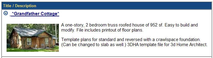

If you get one of the appropriate home design programs (see this article) you can load in the reversed template file and modify the layout to develop your future options. Since the plan is truss roofed the structural layouts are pretty straight forward. If your building department wants more developed drawings your modified template files can be imported into most CAD drafting systems.
