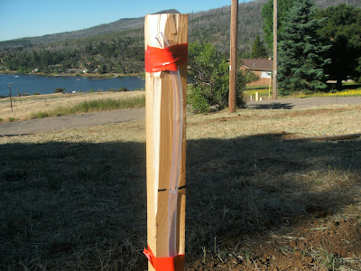

Any tips for setting up batter boards on a sloping lot (cabin will have a walk-out basement)?  I haven't come up with any options other than just really tall stakes on the downhill side.  And would need plumb bobs to set the corner stakes on the two downhill corners.
alex trent
Just speculating, not done by me on #1.
1.  You could extend the batter boards up to the top on the place where that would be level with the other set.  My problem with this is at more than a couple of feet elevation it gets to be a minor construction project and it knocked could be easily thrown out of line as they are tall and likely not all that firm.
2.  Do them at  a foot or so off the ground (like normal for flat ground), but align the strings to be where the top of the corner stakes are when they  are perpendicular to the ground (this means the ground level diagonal will not be the same as the real one). You can still run strings as you need them which is until you get the real posts/corners set. Takes a bit of jockeying, but seems to be a solution. My error came when I did not do a good job of adjusting the string intersections (diagonal corners) to were the top of the corner stake was when perpendicular...so I was off a couple of inches, even though I started out right with the correct and matching diagonals.

SouthernTier
Quote from: flyingvan on June 08, 2012, 10:44:19 PM
If you're going to have a basement, couldn't you dig that first with rough dimensions, then use the flat surface you've created to mark your corners more exact?  If the basement isn't under the entire house, just do that first then measure off that
That would be one way.  However, while I plan to do just about all the building of my cabin myself, one of the few things I will sub out is the foundation excavation and construction (blocks, not poured since can't get a cement truck up there; also, it will be just half the cabin as you suspected, the rear half will just be crawl space).
But since this will be subbed, I would like to be able to be really really accurate where I want them to put the corners of footers.  But I suppose I could get close enough fudging it somewhat, and then tell them the dimensions I want.
Note, I did use a water level for setting the elevations of the sonotubes for the shed I have built first, also on sloping ground:
I handled getting the columns on square by doing some tall corner stakes and diagonal measurements, and then over-augering the hole so I had some leeway as to where I placed the tubes.  And then as a final measure, I made this jig (note, those aren't the sonotubes it is sitting on, those are just the tops I cut off after water-leveling):
which I squared using the diagonal cables with turnbuckles to get the final placement right.  However, I can easily pick up an place a 10x10 jig.  That would be much harder for my planned 22x26 cabin.
And it didn't really work all that well.  While the Simpson brackets for the beams were in the right place thanks to my jig, the tallest tube (yes, it is too tall, but it is rebarred and is sunk nearly 4' below ground so it isn't about to topple over) still ended up off-plumb in order to line up with the jig:
Being off plumb drives me crazy.  I am thinking of putting a deck there just so I don't have to look at it!
But the fact that that corner had the highest off-the-ground corner stake is why it ended up being off, and why I asked this question.
But the water level worked great.  The floor was quite level.
