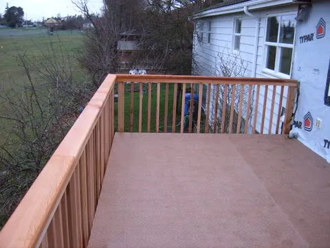

We have done two  similar decks , one is open at the edges and sloped to drain ,
We scuppered it like this , 4 ea. spaced evenly ,   the Versa deck which is a sort of cross between vinyl and EDPM , rolls right uinto the scupper.
Come to think of it that rotten place we worked on last month now has three new Versa deck surfaces , they all drain right of the edge , sort of like the firts photo.
I'll try to get a few photo's of those decks .
BTW the ply under neath is not treated , I doubt Chuck is either, they want a good smooth  face , and come to think of it I did one about ten years ago over in Mount Vernon , Wa. when that stuff was new , they at that time wanted a AC 7 ply , plywood. The last few where just  T&G  ply , 1/2" wonder board over that and floated smooth seams , nail heads etc .
