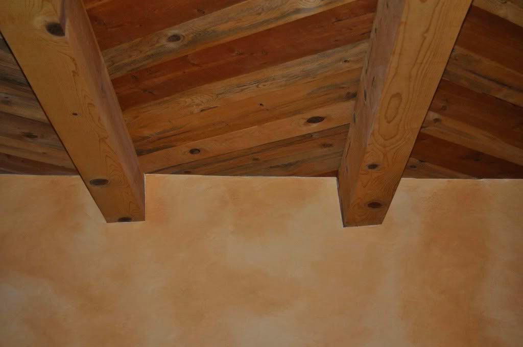

I had this problem too.. with a load of lumber that I bought from a sawmill near Raton.
When I put it up, I was mortified.  The twist seemed incredibly huge.
I boxed in the beams, top and bottom to stop the twist.  They have been in place for 4 years now with no sheet rock cracks.
Here are two pix of my beams:
Once you get the beams up, you can cheat a couple of ways...what is your ceiling surface?
Ways to cheat :
1)   If your deck is wood, herringbone the ceiling like I did.  Cut each piece to only run beam to beam, and you will not notice the uneven ceiling surface....especially with a rough cut ceiling.
2)   Deck it over and keep in planar.  Shim the low spots.  When done, scab a very thin piece of trim on both sides of the beam, and use it to cover the gap.  If you keep this scab to no more than ΒΌ of the height of the beam nobody will ever notice it.
3)   If you must even it up, measure the twist, chalk line the high side, and rip it off with a beveled saw.  Use a straight edge to rip this, or you will definitely notice the rough edge.  This is by far the hardest of the three options to get right.  Don't try this unless you have a spare beam to discard!
Seriously... this is not as bad as you think it is.  Just make it stable and run with it.
