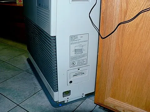

The manual minimum low setting and pump primer is on the side.

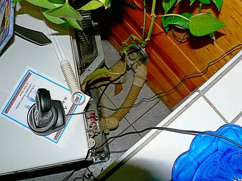

Heat exchanger exhaust and fan looking from top down in back of the Monitor.

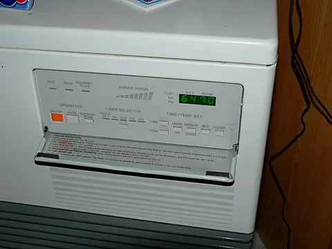

Programing panel on the front - top right corner for easy access - you can set manual temp from here and return to automatic program easily.

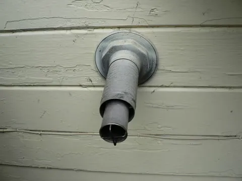

This is all that sticks out the side of the house -the large intake pipe is about 2" dia.  I think there is a longer distance optional heat exchanger pipe available.

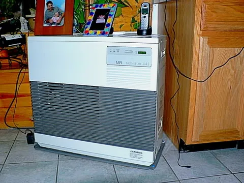

It looks very nice.
And the top remains cool enough that you can keep pictures on it.
