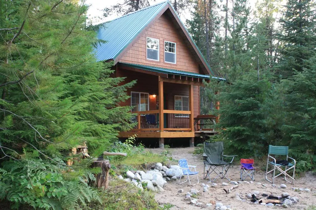

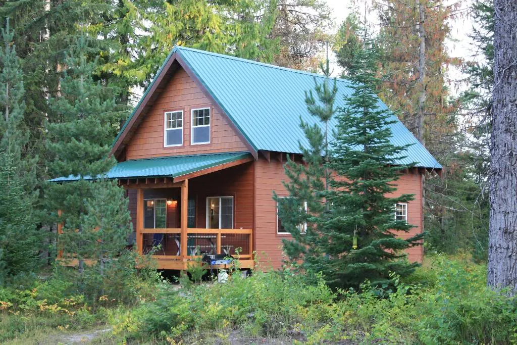

I thought I would post some updated pics with the front porch we added this summer.
Hey Micky, that looks very nice. I bet you hate to leave there.
Looks terrific!  what did you use for the horizontal posts (newels?) between the wooden posts?
Micky
Sassy,
All the wood for the railing was either 4x4 or 4x6 timbers from Homedepot.  They were green Fir.  I ran them trough the planer to change the look from dimensional lumber and give a nice finished surface.  Gives the Timber-Framed look.  The 6x6 posts were dried S4S Fir.
I used rebar for the balusters that I had powder coated.
