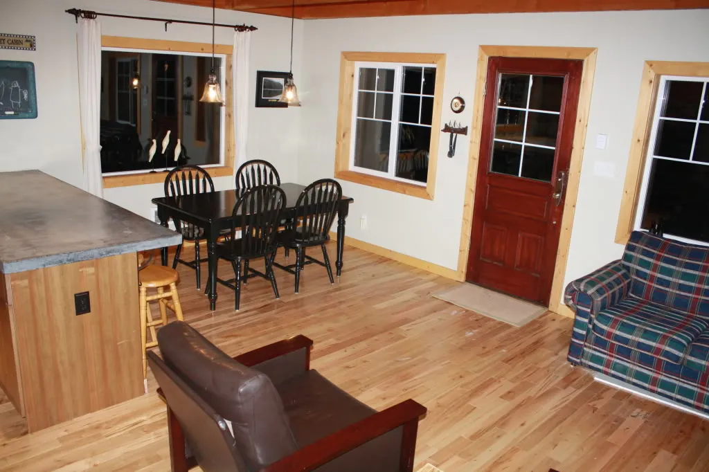

Micky... Thanks for posting the inside photos. The place looks great and I'm sure your family is enjoying it. Are you planning to add any porches to enjoy those northern Idaho summer evenings?

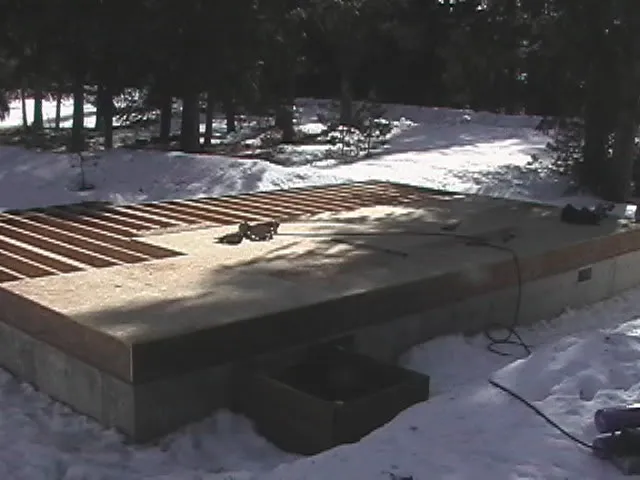

I also did the crawlspace.  I agree with your Dad that it makes the plumbing & electrical much easier to run.  I think the crawlspace also gives a little more buffer incase high ground water becomes an issue.
I paid Jim Holland $4130 for the foundation work (including materials).  I also paid Kevin Storro $935 for the site prep & backfilling.  It wasn't cheap getting the concrete all the way up there.  Jim also needed to use a pumper because the ground was too sandy for the trucks.

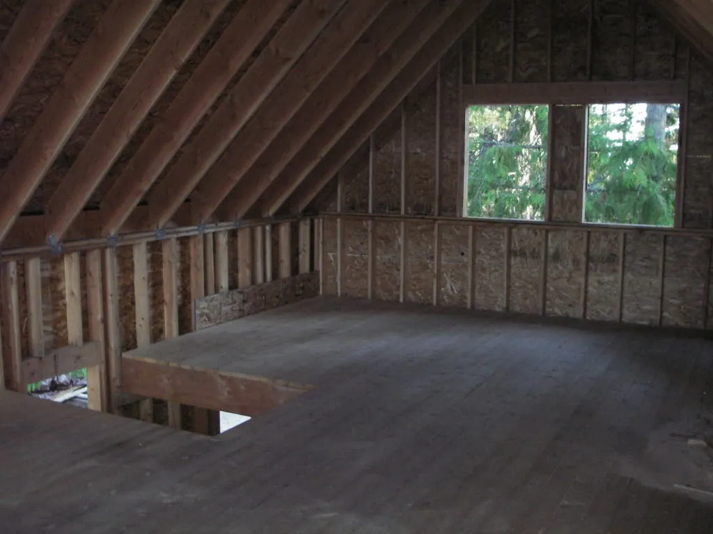

I hate to take you back in time Micky but is there any chance that you have any more photos of exactly how you installed your second story (loft) joist to the outer stud wall?  You mentioned in one of your first posts in this thread that you used a ledger and in one of your photos there is a far away shot.. but I wanted to see it a little more up close if this is possible.

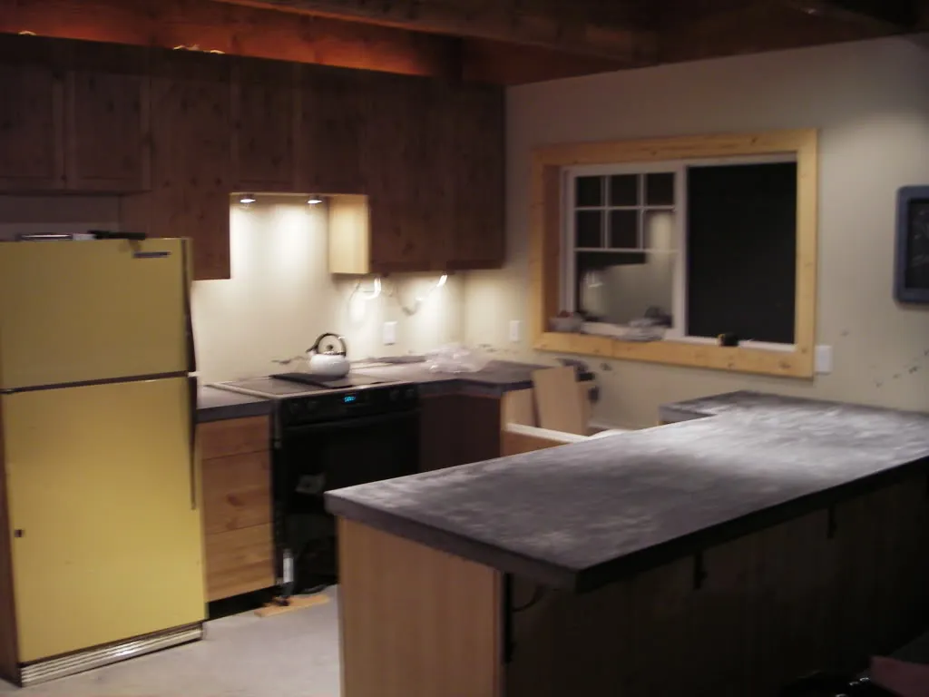

What type of flooring did you use?
What type of cabinets? Love that big sink!!
and.... what type countertops are they?

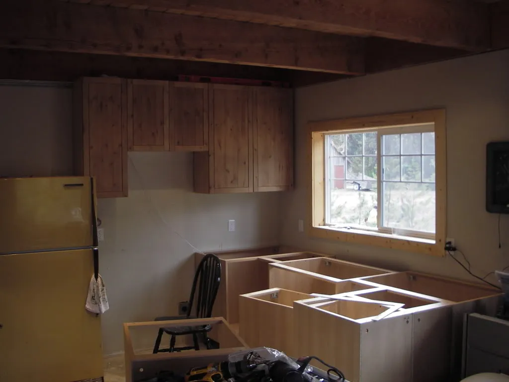

Micky
Thanks,
The flooring is solid "rustic maple".
The cabinets and sink are both from Ikea.  They were a great price and well engineered.  Ikea is fairly good quality for the money.
The countertops are concrete.  I used Buddy Rhodes product. //www.buddyrhodes.com  He charges a lot of money for ready-mix, but I think it was worth it for a beginner because it is all designed for the application.

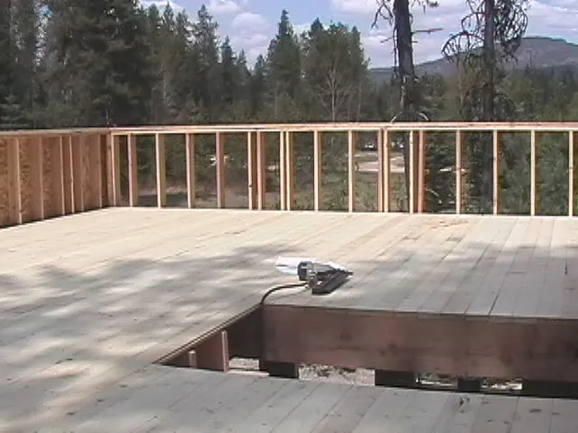

Micky, I have a couple quick ?'s for you. What size joists did you use for the 2nd floor and are they 24"OC? Also, do you place the 2nd floor joists on a let in ledger? It looks like you notched the studs out and set a ledger in there. What size was the ledger? By the way the place looks fantastic!!!!!!!!!!! I hope mine turns out as nice as yours. Thanks Pete
Micky
I used 4x12 douglas fir.  They are on 48" centers  You are correct with the let-in ledger.  This ledger was a 2x6.
All per John's plans.  I think there has been other posts with more details on this method.

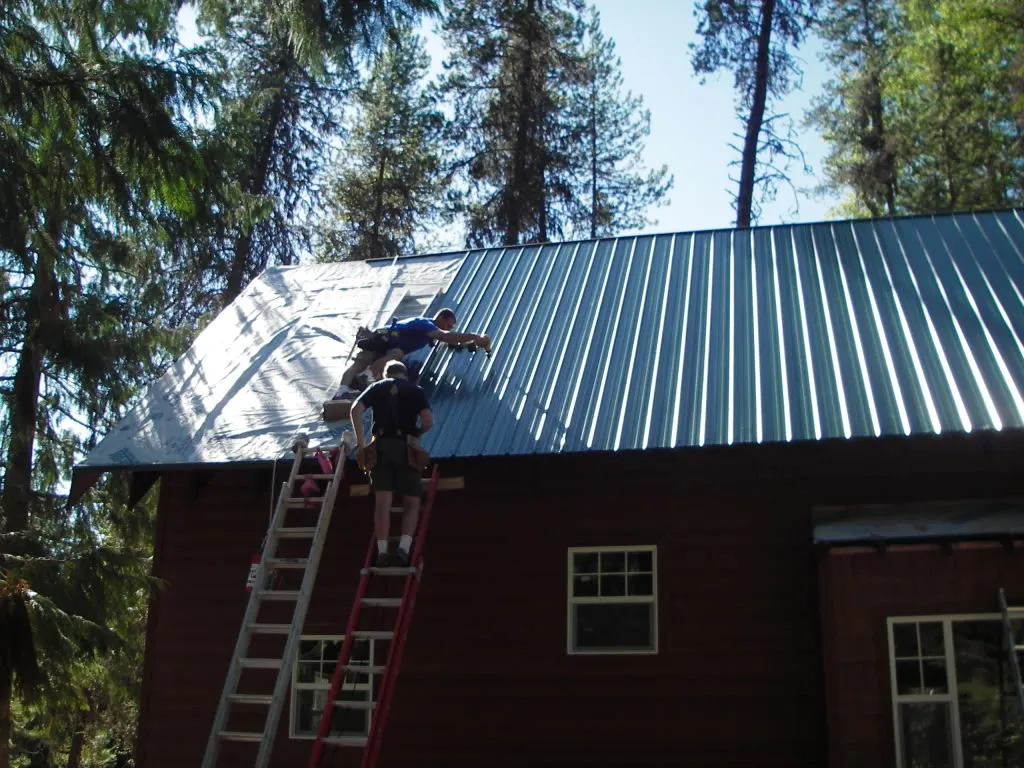

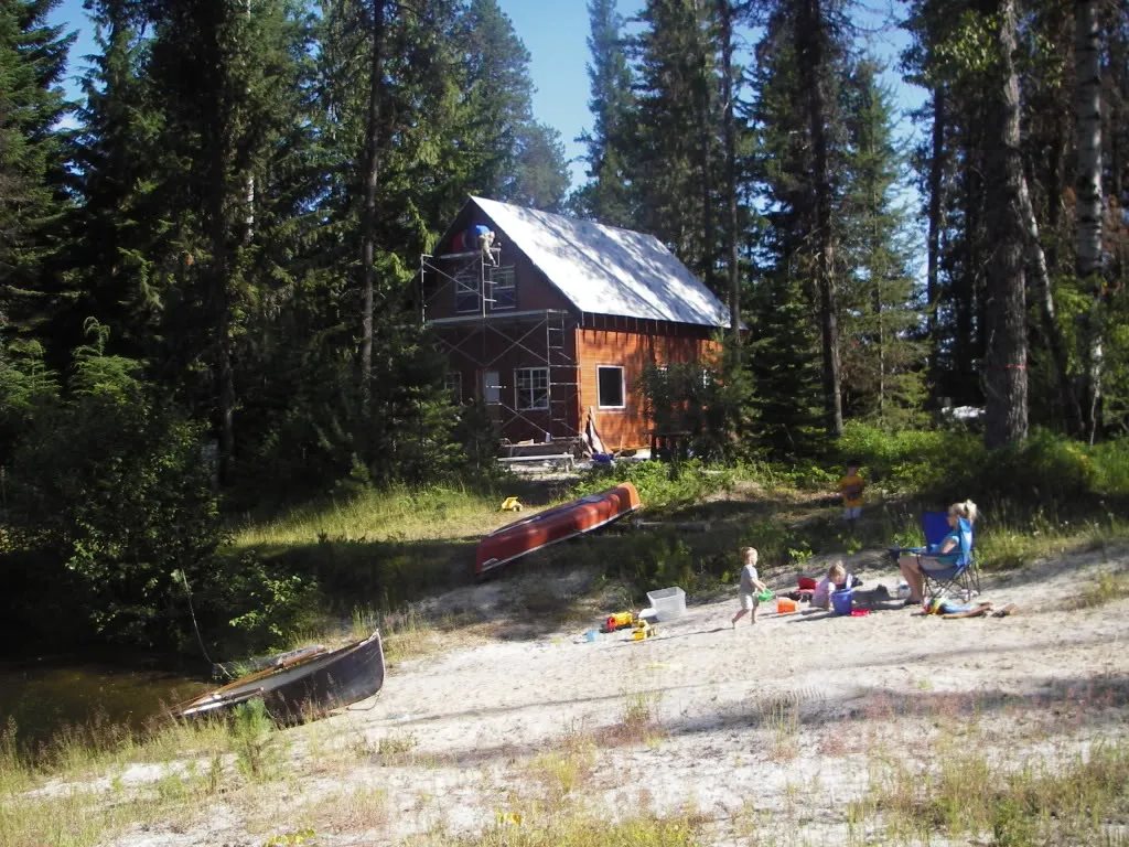

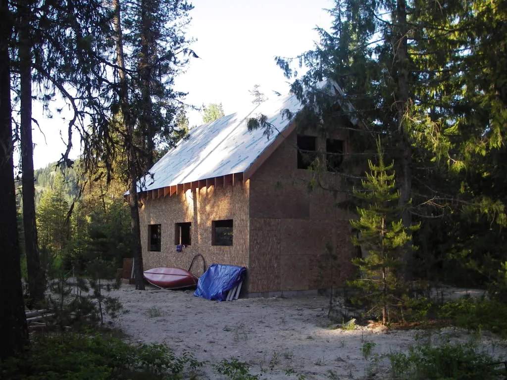

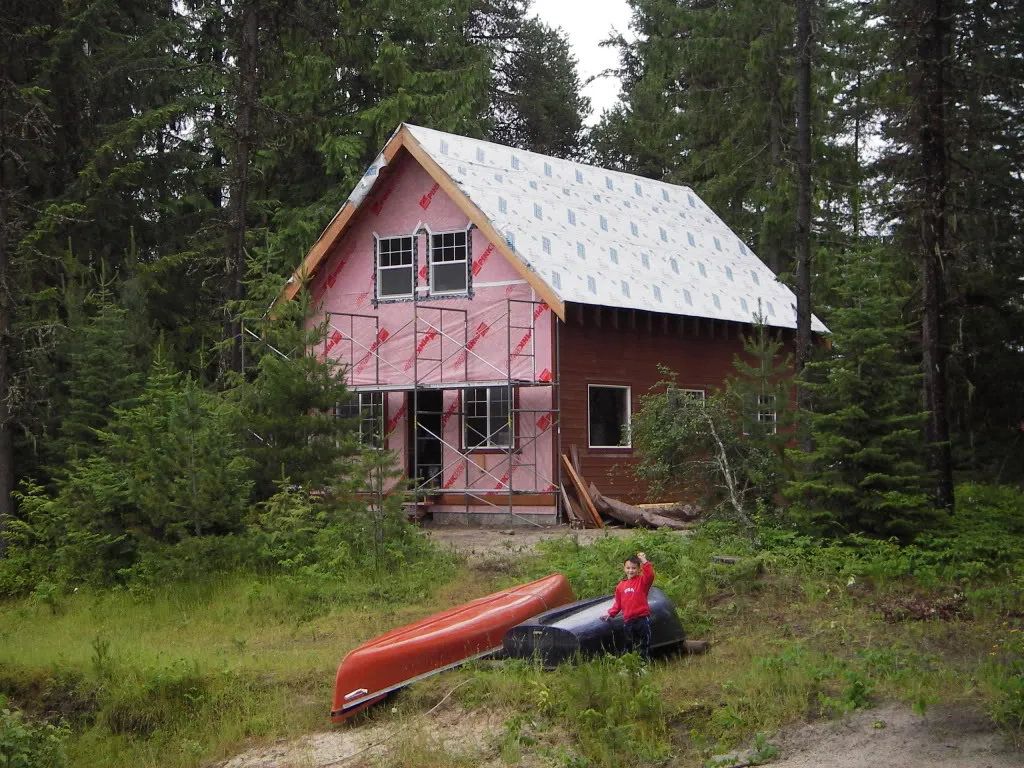

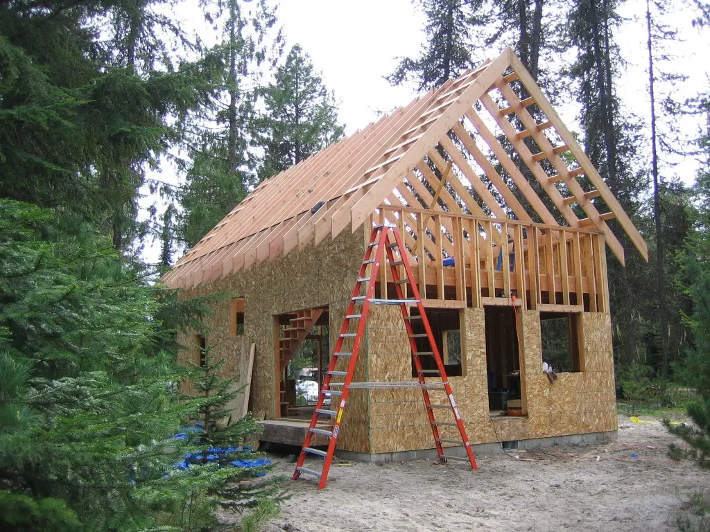

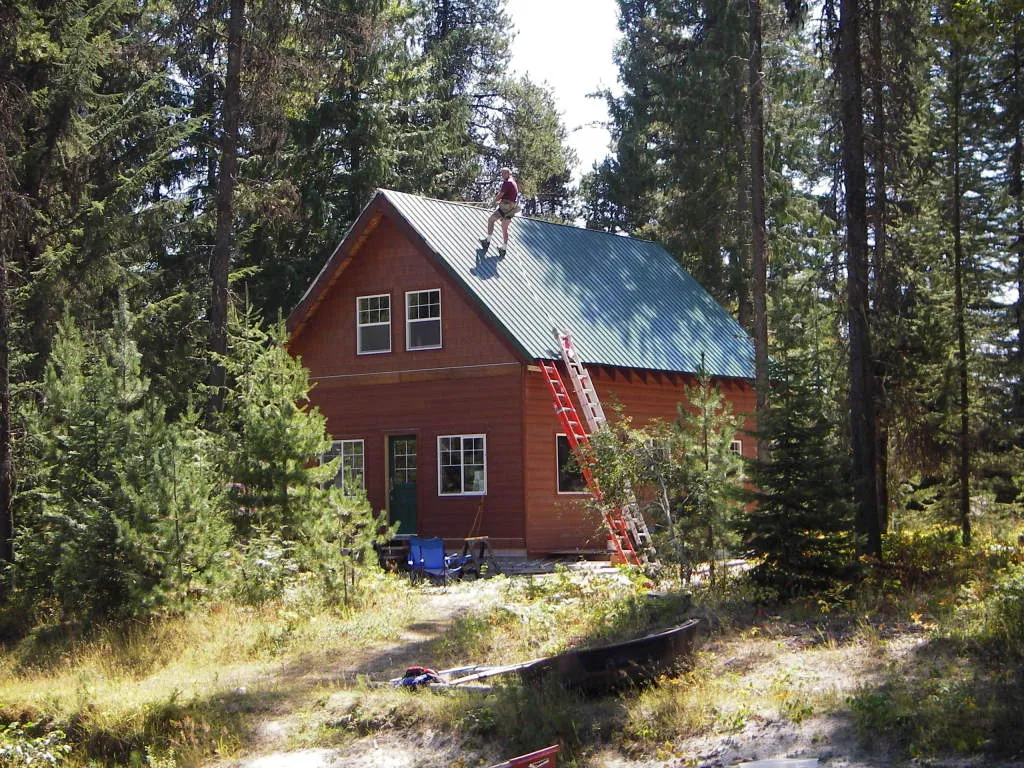

It has been a long while since I posted an update.  It also looks like some of the early posts of this thread were lost.  So I thought I would add pictures of the progress and give some background.

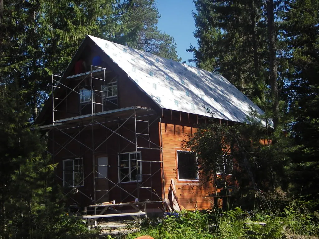

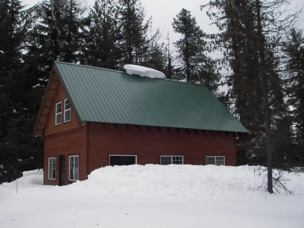

We started building the 1-1/2 story in Spring of 2005.  We made a lot of progress the first couple of summers.  Our pace has relaxed the last couple of summers now that it is mostly done and livable.  The only two major projects left is the front porch and finish the stairs.
We have stuck mostly to the original 20x30 plans except for:
- 12' walls to give more livable space upstairs
- Increased length to 32' to give a little more room
- Add a bump-out to increase the living room space (saves room by not needing a big couch)
I would say John's plans are amazing.  We have done all the work ourselves starting out as very novice builders.  His plans are simple and very efficient.

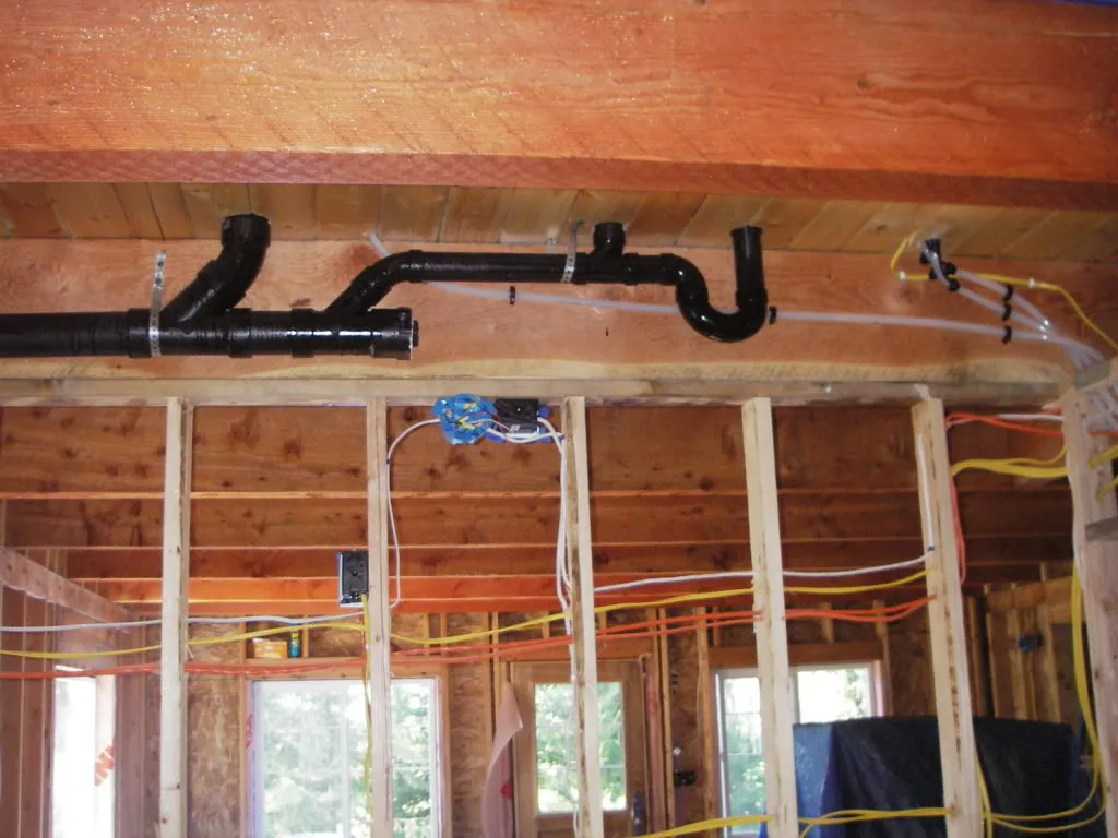

The exposed wood ceiling looks great.  We found a local mill that supplied rough cut 4x12 DF.  This really set the character.  However, it did make adding the upstairs bathroom a little tricky by needing to hide the plumbing.  The stairs are also very steep, but this is a good tradeoff for not taking up much room.

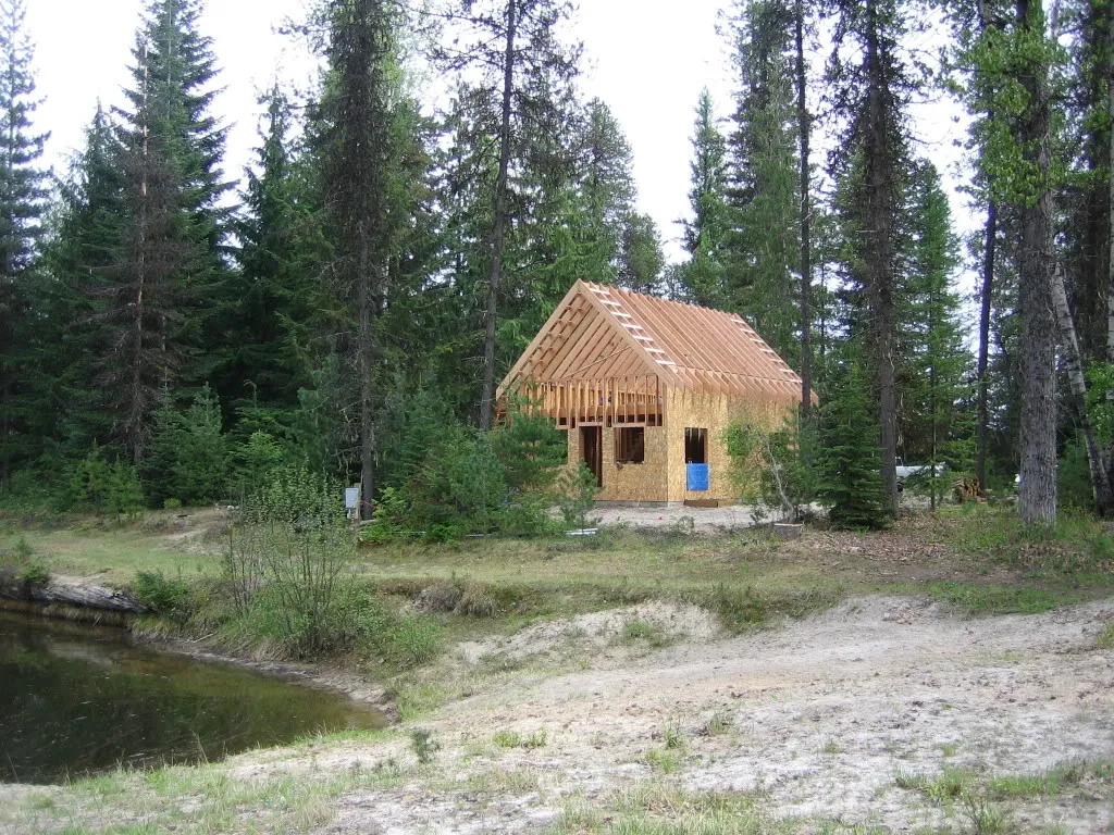

The foudation was poored just before as winter came.  It is ready for Spring Build!
Started framing March 5, 2004
Wall raising part!  April 2, 2004

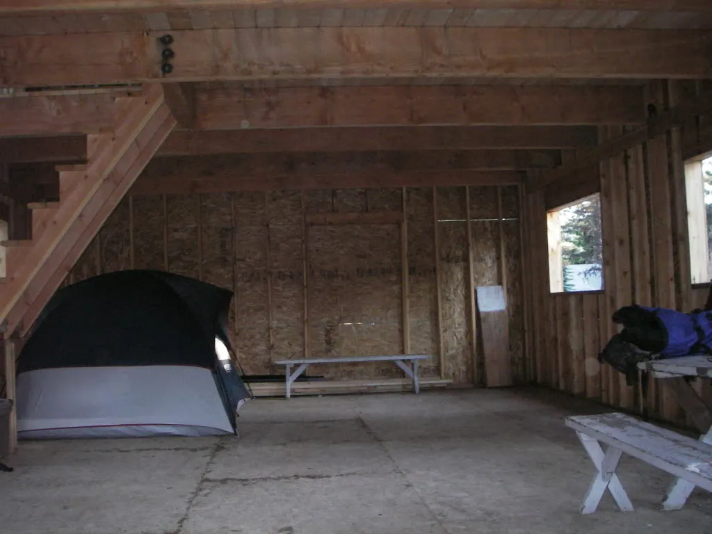

Does it count as being "dried in" if we had to sleep in a tent?  June 20, 2005

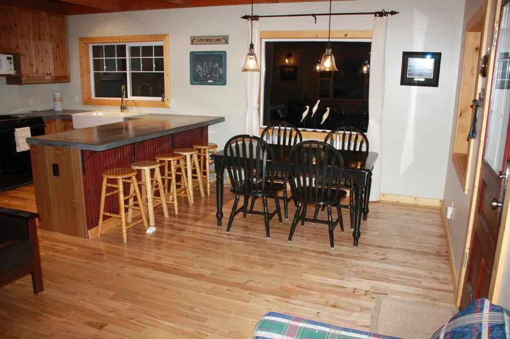

Micky
#73

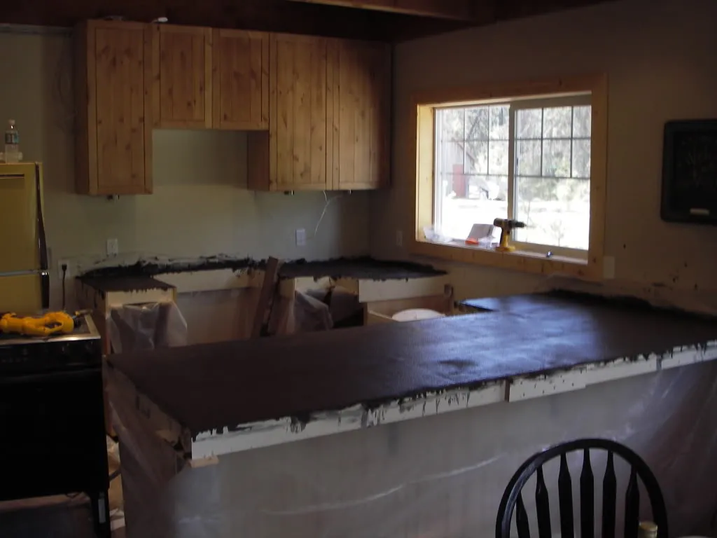

Here are some pics of our work on the interior...
Kitchen from Ikea.  Great Bargin and fair quality.
Pouring the concrete couters.
Hardwood floor help.
An attempt an a pamoramic picture of the living room...
