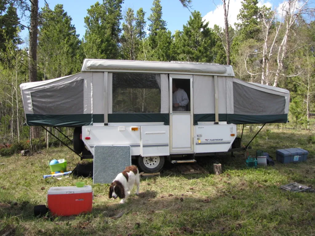

We also moved a pop-up onto the property

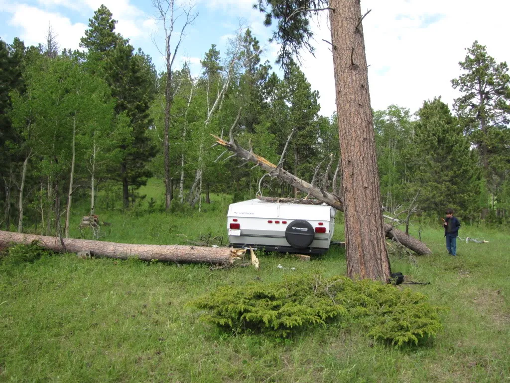

The second weekend after I hauled up the camper, we pulled into this  :(
Well I know what you all are saying is "Why would you set up anywhere near a dead tree" d*.  All I can say is that after the initial set-up I realized my error and plan on moving the camper this weekend.  My stupid logic was that the tree had been there for 30 years, whats one weekend more gonna hurt. ouch.  After talking my wife (off the ledge) and explaining to her "at least we weren't sleeping in there" (didn't help things) she calmed down a little.  The upside of things were that the tree was so punky that it only stabbed 5 holes in the ceiling and did not affect the operation of the camper so I mended it with flashing and roofing silicon.  The downside is that our $4000 camper value is a big loss.  Insurance won't cover it :-\

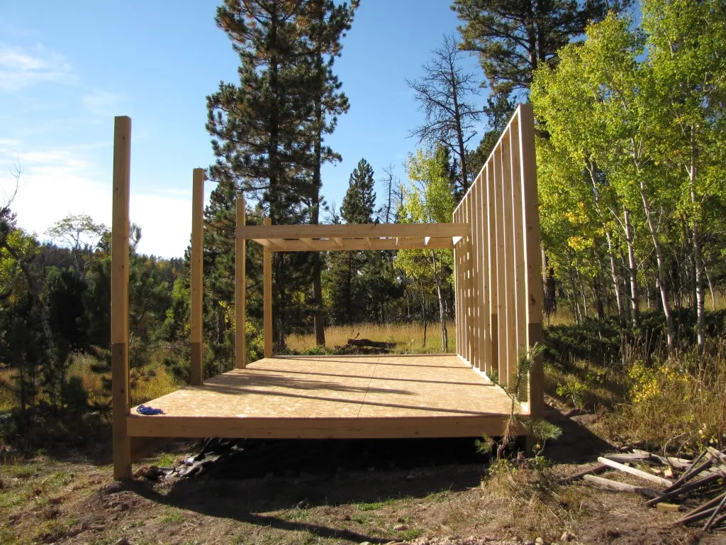

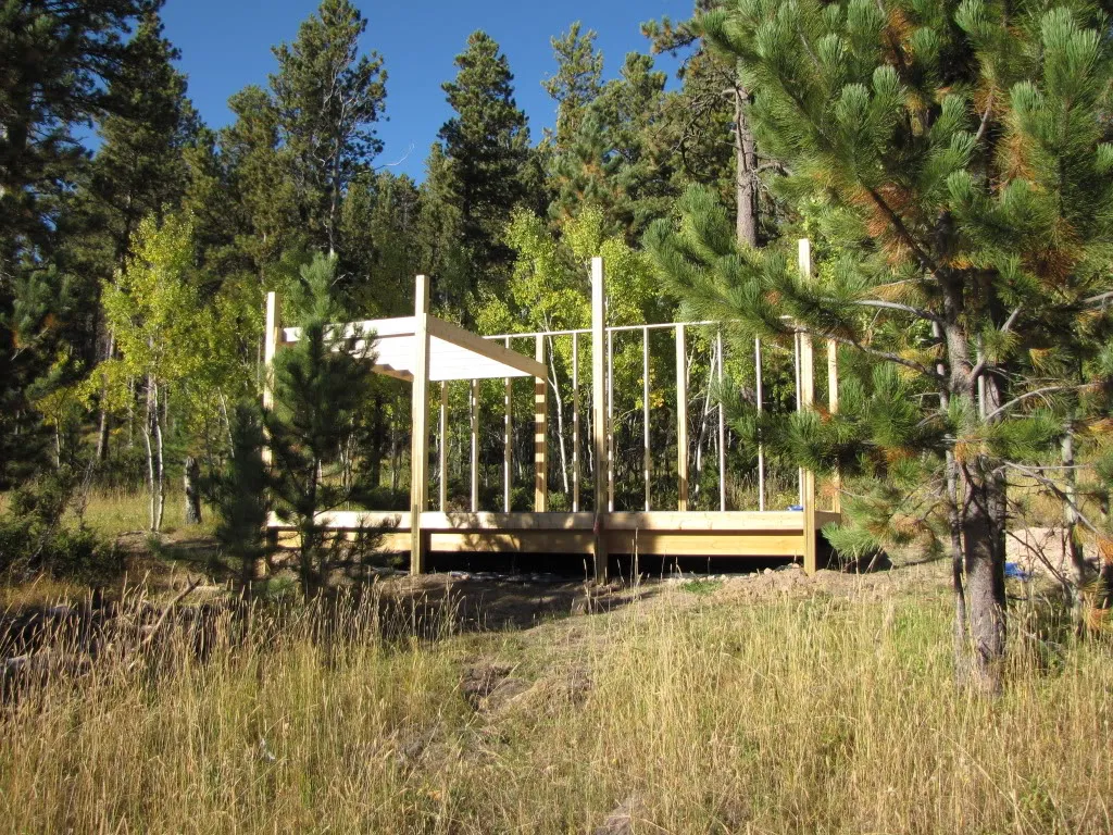

After locating our build site I got started a few weeks ago.  My hope is to be dried in before winter sets in.  I purchased the "Whole Enchilada" kit from this site last spring and it has been a great help.  The only major change is that I am using the post frame method.  I finally remembered to bring the camera this last weekend so here is my progress:
Front view lookin north:

That certainly is a well braced "pier" to work from. Any more detail photos or descriptions of the floor system connection to the posts would be appreciated.
We built 7 houses out there one year, almost bought some property, I really like the hills. Where are you near?
mpls_ham
The holes are 46" deep with 4" of crushed gravel.  The posts are 2x6 glued and spliced together. The 24' sides of the posts have a 2x12 lagged into the inside. A 2x10 joist system sits on top.  The cabin is not far from O'Neill Pass or about 22 miles west of Deadwood.

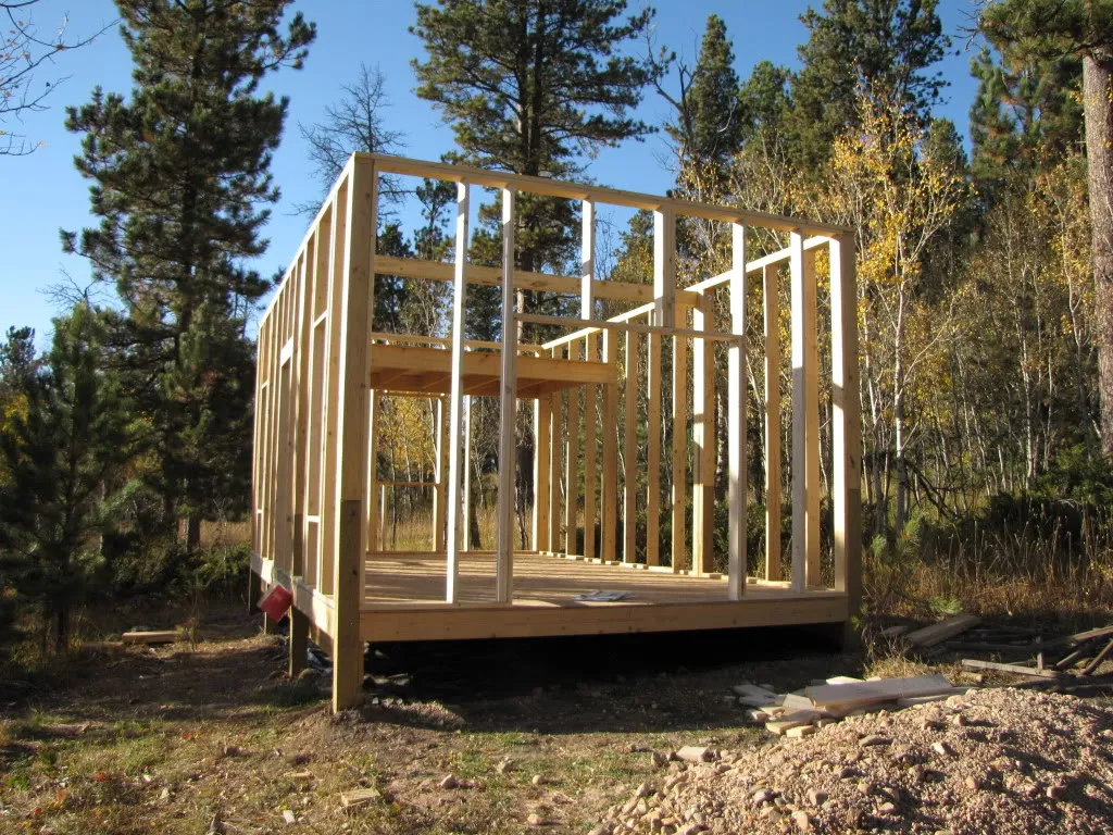

mpls_ham
#5

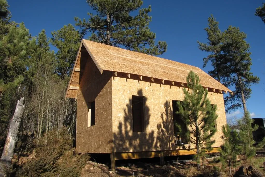

Ready for sheathing.....i think.  Weather permitting, I hope to have it knocked off by tomorrow.

Nice looking area.  What a time for a snag to decide to fall.... [waiting]
A nice spot. Going to be a nice cabin too. Hope the future firewood falls further away next time.

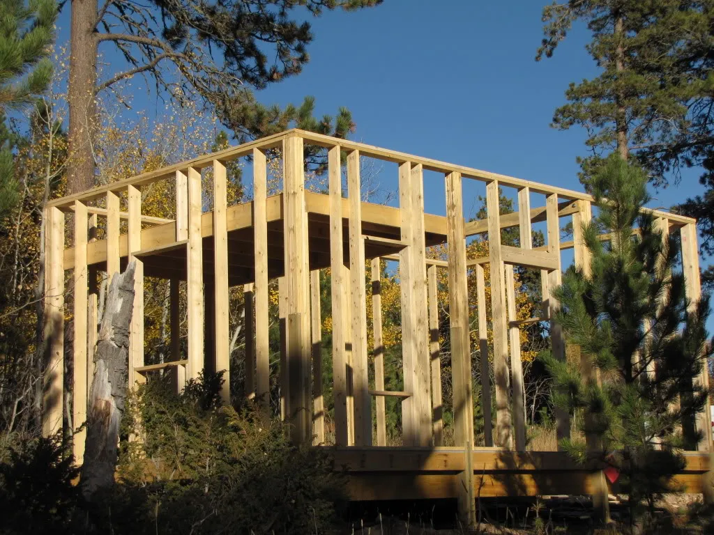

mpls_ham
#9

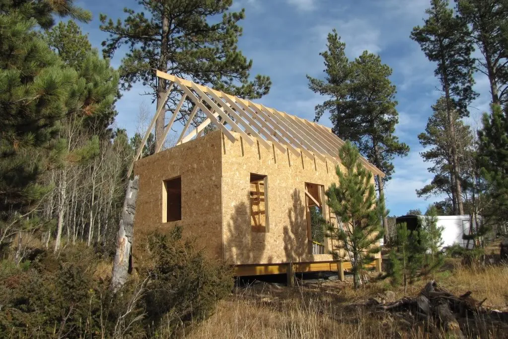

Here is my latest progress as of last weekend..... I hope.  We have had 48 hours of 40 to 50 mph wind gusts and I have a sick feeling that my rafters have uninstalled themselves.

nathan.principe
Its really shaping up to look good! I think your fears are typical of a builder, I often second guess everything I do and have a phobia that I will return to my place and something will have collapsed, but I wanna say that you did good by installing the sway brace, that should hold things in place
cabinfever
+1 to what Nathan said. Actually, I still pull in thinking I'm going to find a disaster or some sort - it doesn't necessarily end once its built!

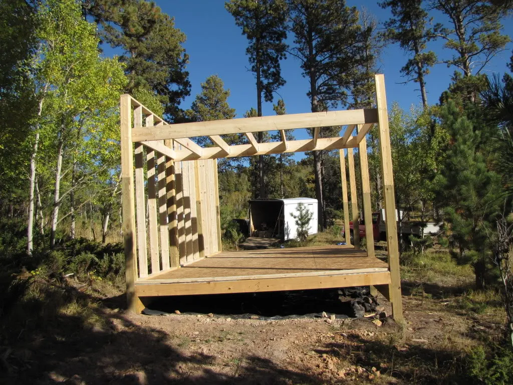

mpls_ham
#13

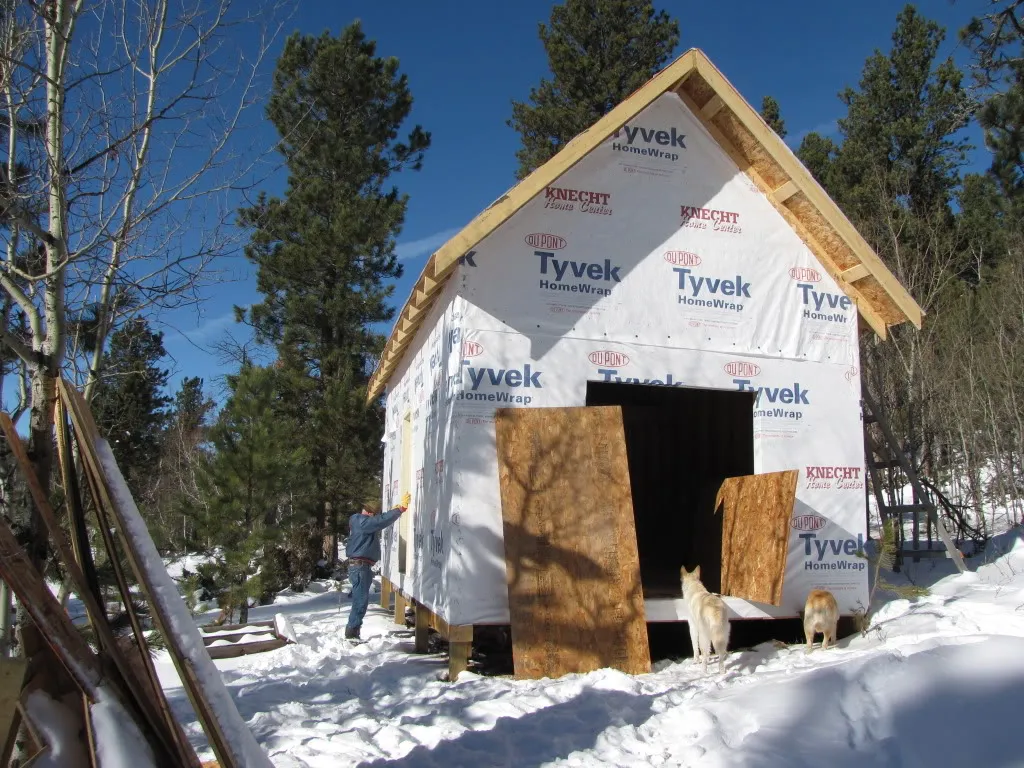

Well I drove up to the project today expecting to salvage what was left of the rafters and beam and to my surprise it held up.  Had to chain up the truck to get through the drifts.  I spent half of the day shoveling out the cabin and the other half putting up the upper gable studs.  Not much progress but still elated and relieved to be moving forward and not back.

PA-Builder
Project looks great MPLS !
Glad you didn't suffer any damage.  Once you get the roofing on, everything will be much more secure, and you will be able to rest a lot easier.
OlJarhead
Glad to see you survived the winds and snow!  I remember racing up to the cabin (4 hrs one way) to check tarps and pray...only to do it again if I didn't get up to work on it....was a fretful time but we survived and I'm sure you will -- enjoy the experience!

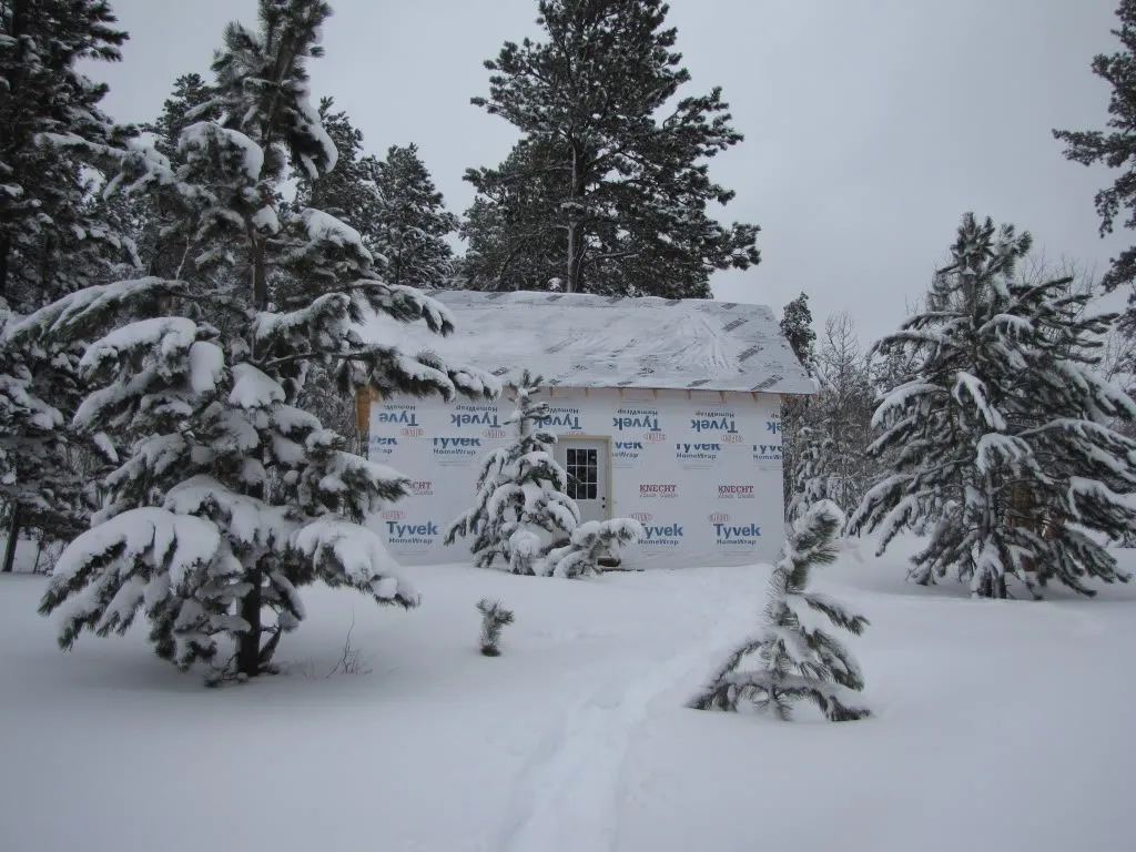

Well I got the house wrapped about 3 weeks ago and just made it.  The snow is too deep for my pick-up.  I plan to ski/snowshoe in periodically this winter to check on it.   c*

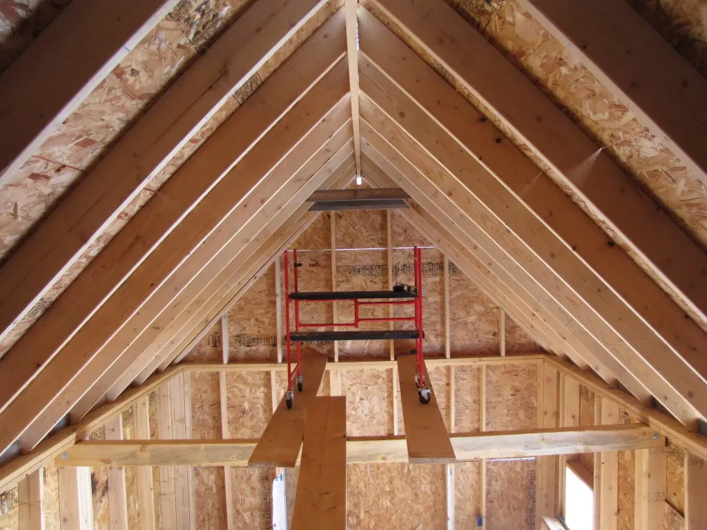

Question: What is the easiest way to install rafter ties as level/straight as possible?  I attempted to nail up the two ties at the ends and run a chalk line.  I plan to use T&G knotty pine on the ceiling and I want to be sure it comes out relatively straight.  Will an inch or more of variation bite me in the butt later on? :-\
