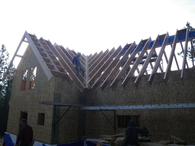

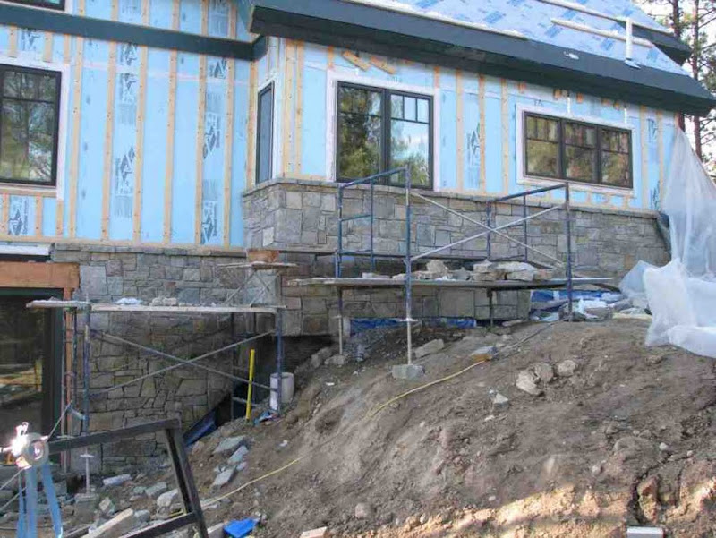

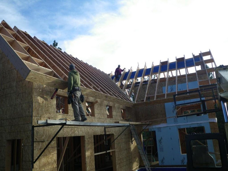

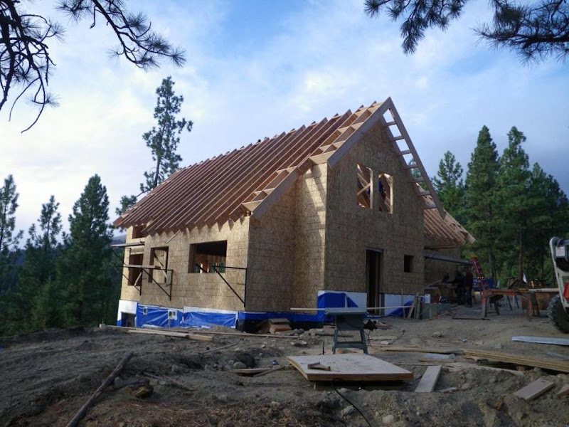

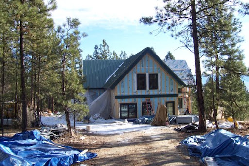

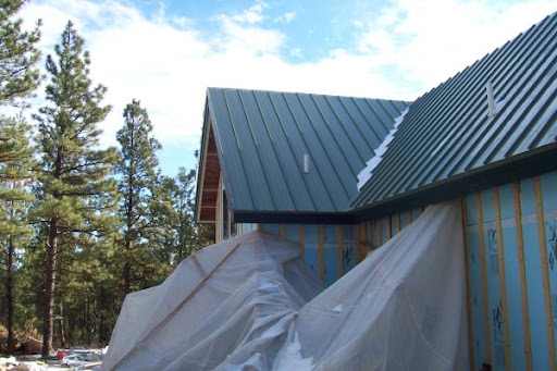

Framed and ready for the roof
Roof is on and stone work has begun. Late October 2009

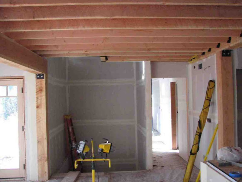

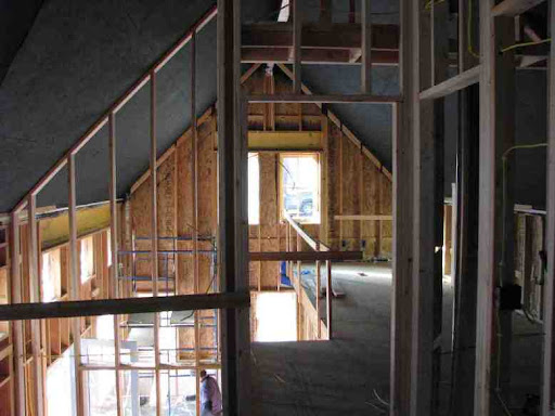

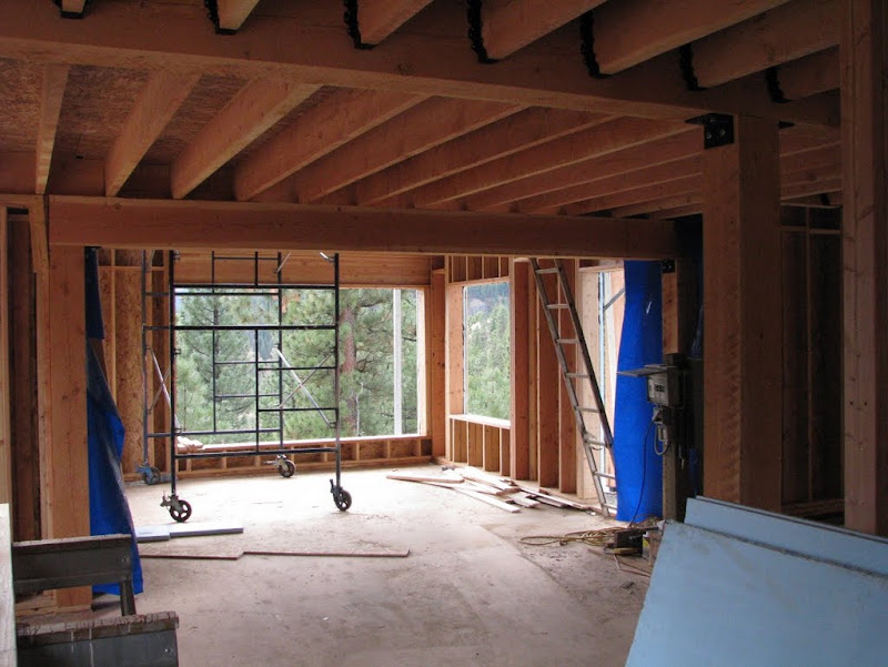

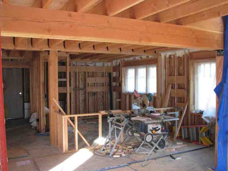

Inside photos
Master Bedroom and  Loft
Future kitchen and eating nook
Lots of wood
Living Room from kitchen area
Fast work to hall to Master bedroom

I am very envious! thats a nice place you got there :)  I must say I have never seen I Joists used for rafters, we dont worry about snow loads in my neck of the woods.  Keep up the good work!

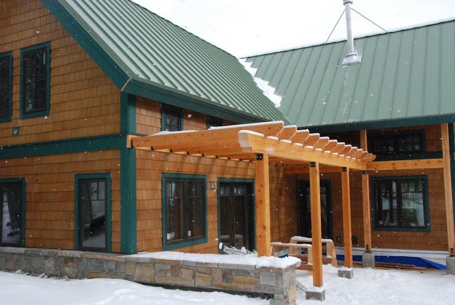

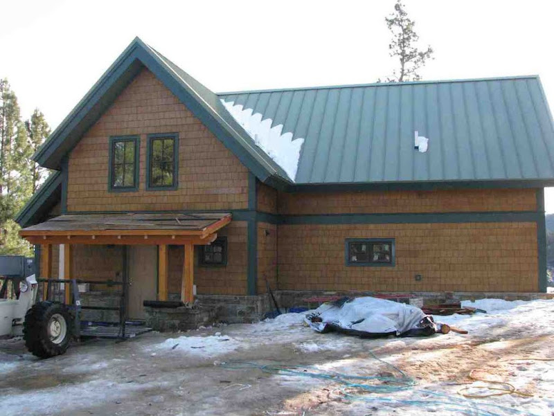

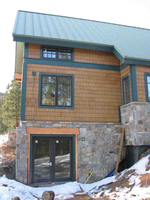

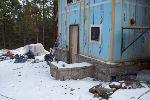

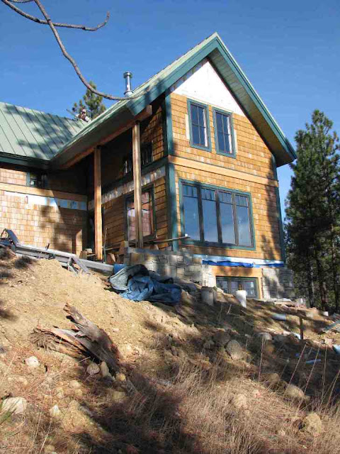

Okay moving along with the exterior.  The walls are all insulated with cellulose with a 2" rigid covering and then cement siding. Originally I wanted clapboards and then shingles in the gables, but I also wanted to use Nichiha siding.  so I compromised and went with the shake look completely.  I am really happy that I did.
Some more photos with it mostly sided and winter coming

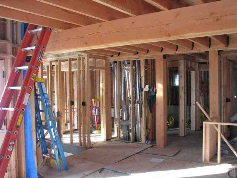

Inside photos of some of the steps along the way.
The good news is the house is finished  (mostly) and everything we tried to do has worked. Dec temps averaged 19ºF and we used only 1200 KWH  for all the electricity- heat, lights, refrig, and air exchanger (at .5.4 cents a KWH is good  Thank you CoOp)
During the summer  we would leave the windows open at night and closed during the day and the temp never got above 78 even when it was 95º outside.
In the early fall  when the temperature ran between 32º and 55º  for  2 days we reversed the window thing and the temp never dropped below 72º.  We never turned on the heat.
Because of the air exchanger  we always have fresh air so it does not get stuffy.  So far so good .  Okay I am getting ahead a little bit so here are some more photos

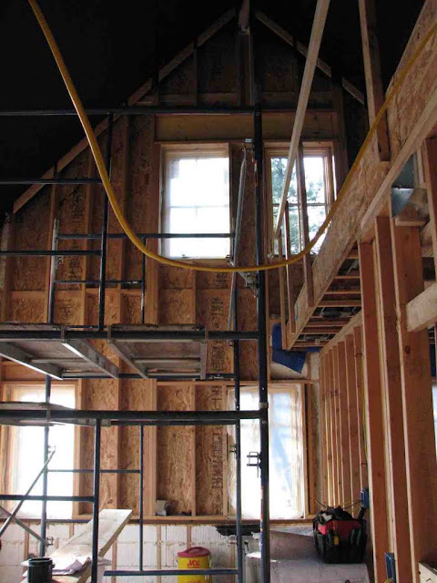

Living Room Ceiling - the ceiling is rough sawn fir which is nailed to the sheathing. the sheathing was painted black  so when the planks shrunk you get an nice uneven effect.  Wait to see latter photos.
Master bedroom loft

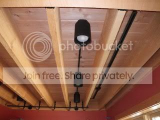

Lights in the kitchen.

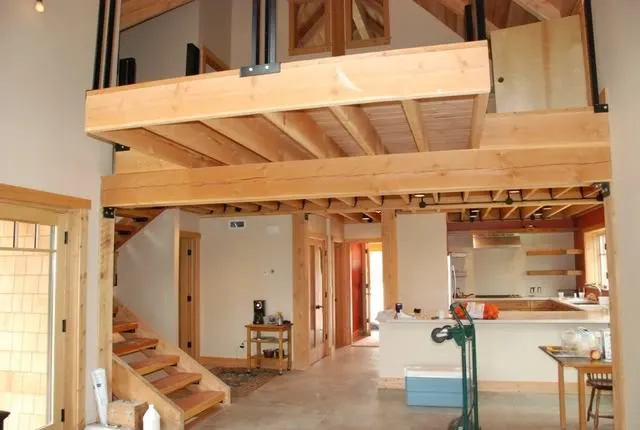

Living Room

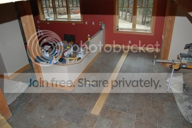

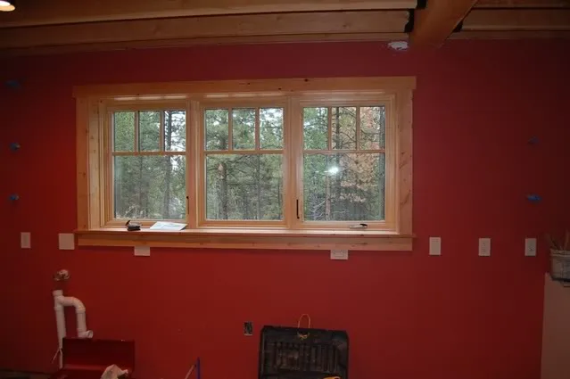

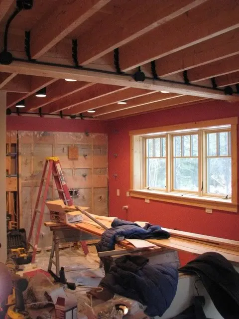

Kitchen soon to be sink area  looking east

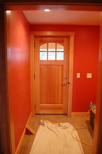

the mud room

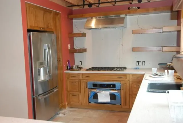

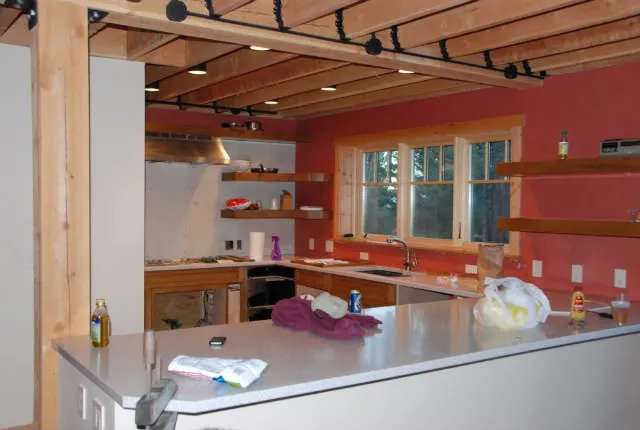

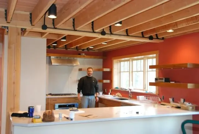

So to the kitchen which is the final chapter to all the kitchens I have made and/or helped design and could be a show piece for the industry and hardware, cabinetry, and accessories included in it
One of the most memorable field change was with the 11' (read 132")  by 42"  peninsula top.  The top, made with Wilsonart Solid Surface and is Greenguard certified,  was 1-1/2" short.  Tab Black spun his magic and with limited tools and assortment of handmade clamps he fastened 15 pieces to the end of the top.  After 5 hours of clamping, routing and sanding (4000 grit)  I challenge anyone to see the seams.  It was truly unbelievable.  If Wilsonart was to give an award for fabrication hands down it should go to Tab.
Other than the usual tight fits scribes the rest of the installation went flawless except for a slight miscalculation for a pipe in the waste cabinet. This is the one cabinet that included the Blum Servo-drive opening feature.  We have re-designed it and I will install it in June.
The kitchen called for no wall cabinets and only drawers in the base cabinets.  All the drawers are the latest Blum version of the TANDEMBOX Intivo with several drawers, especially the Space Corners, using the Design Element and others using the Boxcap.  I chose the black systems with frosted glass to keep with the industrial look of the kitchen and house.  All will be fitted with Blum's ORGA-LINE utensil,  plate holders and food storage.  Next month.
As mentioned there are no wall cabinets only fixed shelving with accent lighting. All the shelves have the latest state of the art Hera LED dimmable lights and are connected to a transformer and a remote control.   17 in all. The handles and knobs are wrought iron from the Berenson Rhapsody series and the one small 8" tall pantry next to the refrigerator is the Scalea series by Fulterer.  Not surprisingly the pantry got the most compliments form the Hogs because of its ease of use, quality of materials and soft close.
The kitchen, although not quite finished, is everything I thought it would be.  I cannot say anything more except thanks to all, Mark and brother Tab, and of course to the companies mentioned above who listened and worked with me with some modifications and who manufacture some of the finest quality products I have ever seen.  Enough said as now it is time to enjoy it.

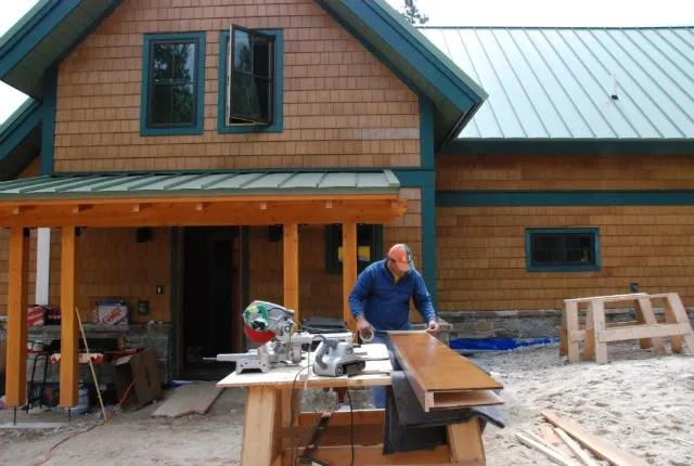

Photos  of work in progress

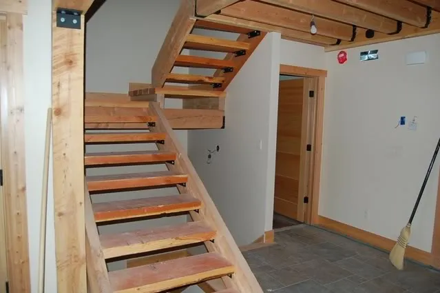

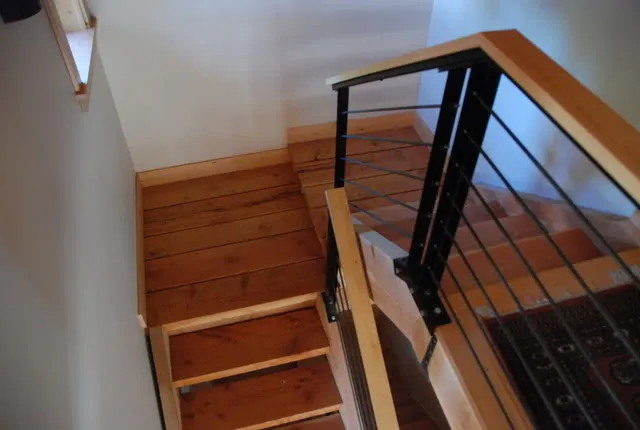

The stairs now I can post side by side photos.
I am getting the hang of this

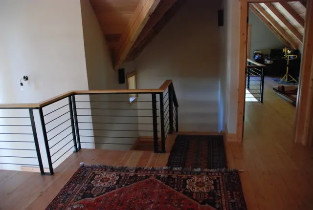

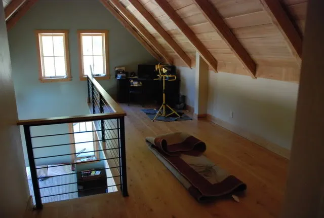

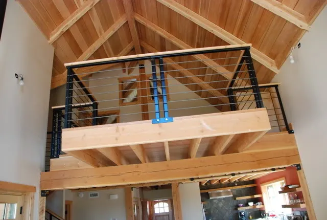

Loft Railings
