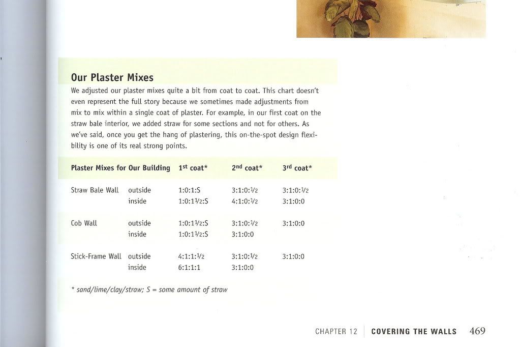

MaineRhino
In the book "Building Green" they described their earth/lime plaster mix as 4:1:1:1 or 6:1:1:1 sand/lime/clay/straw, with best results using soaked straw.
It's a great book with loads of pictures and various building methods.
Here is a chart of the plaster mixes they used.
Looks like a good formula.  Most decent earth building uses 70% sand and 30 % clay average .. plus the rest stuff to be a plaster.  I made one similar that is holding up well about 7 years later.
