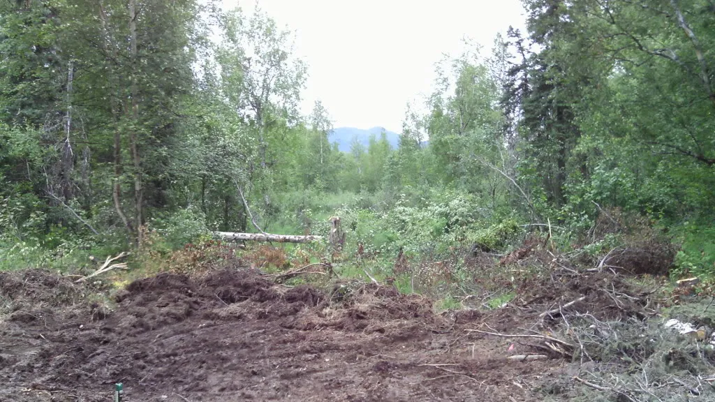

This is what the site looked like before preparation

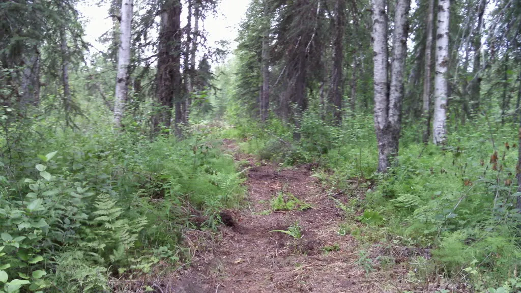

The trail to the site was put in using a mini-excavator and a chainsaw

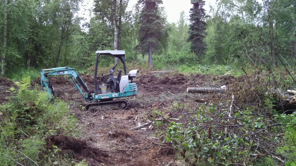

I used a friend's mini-excavator that he had previously brought in on the river.

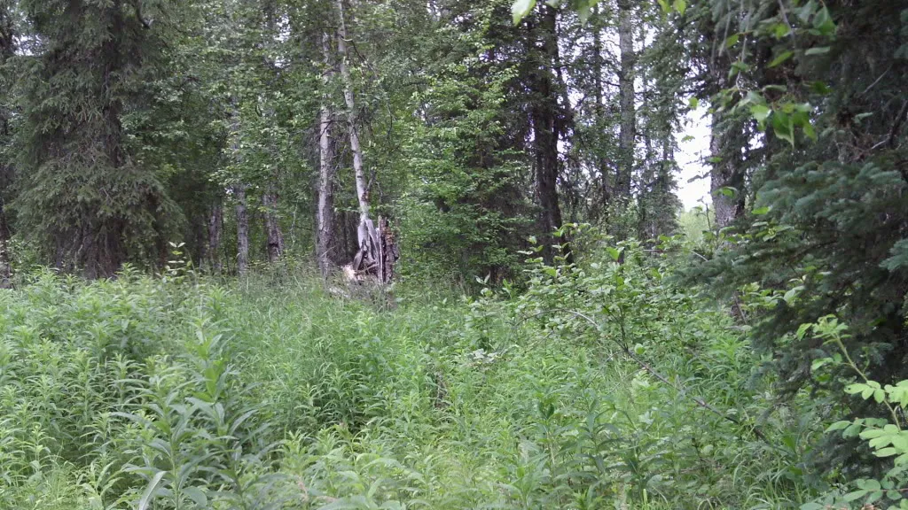

After cutting down about 40 trees, I was finally able to see Mt. Yenlo. This will be the future view from the living room

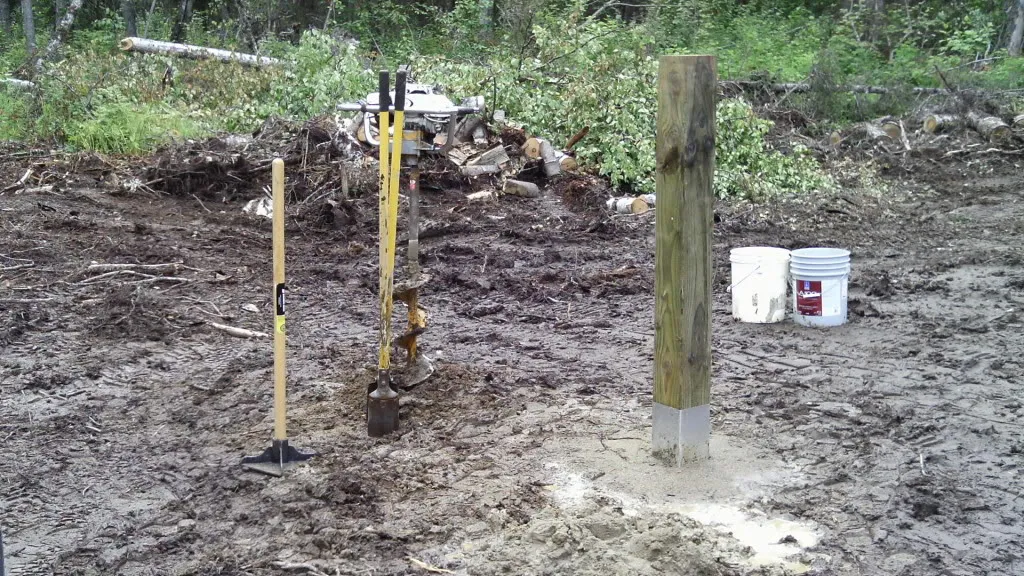

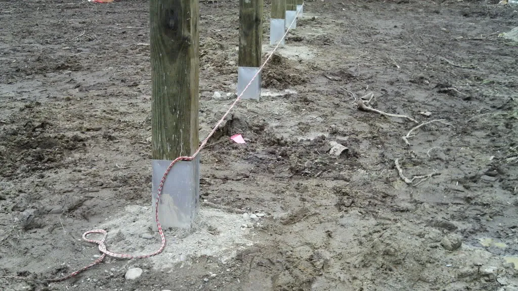

This is the first post in. Notice the aluminum wrapped around the AWW 6x6 to prevent frost jacking. The ground here is very wet. Water bearing sand/gravel is hit at about 3 feet. I placed the post on top of a large concrete paver and packed clean gravel around the post.

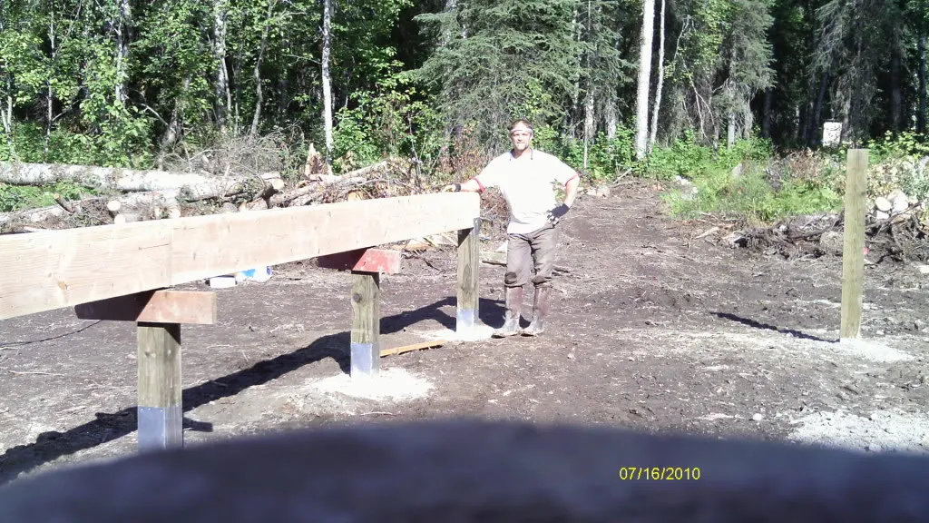

Note the cross braces on the posts. I used these to build the beam more or less in place, as I am working alone. I would have had a hard time lifting that thing into place.
