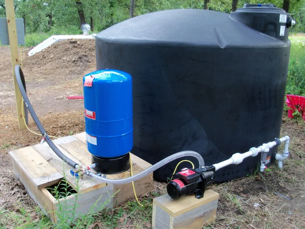

Hello astidham -
You have built a beautiful place!  I am in the process of setting up a cistern too. Obviously it's been a couple of years, but I wonder if you could help with some of the plumbing details?
It appears from the image that there are two outputs from the tank and one appears to have a filter on it, is that right? Also, presuming that the pump is an "on demand" type, could you possibly advise the specs on the pump?
Your work has such quality - makes me step back with pause.
Thanks very kindly,
Shawn in Paso Robles, CA.
Quote from: astidham on September 24, 2012, 01:50:09 PM
Its been a while since my last post, we have finished most of the kitchen cabinets and tin back splash, and are waiting on drawers.
we started finishing the exterior, got the cistern installed, and have learned a lot about hauling water.
a pic of the hauled water cistern.
That is all for now!
SouthernTier
Well, I am not Astidham, but I am contemplating something similar to this.  There is only one output from the tank.  The filter is just inline with the exit.
The pump usually is controlled by the pressure in the pressure tank.  When the pressure in the tank (which is the same more or less at the exit port from the pump - it looks like the settings are set right at the pump) gets below the low pressure set point, it turns the pump on to raise the pressure to the high pressure set point.
In my case, I will have a cistern higher up on a hill near a spring.  So I will have a second pressure tank between the cistern and the pump.  The first pressure tank will maintain water at a pressure equal to the hydrostatic pressure I get from the elevation difference.  I have to have the pump draw from that tank rather than all the way from the cistern, because the pump could pull too much of a vacuum over the long run from the spring, and then you'd get cavitation (formation of vapor droplets) which destroys the pump impeller.
This all said, I would love to hear what Astidham has to say about all the components between the cistern and the pump.  I see a filter, fittings on either side of the filter, but then a big bulge.  Is that bulge just to dampen vibrations of the pump?  Or something else?
astidham
the pump is a 3/4 hp jet pump from tractor supply.
it comes with a preset pressure switch that turns on at 30psi and off at 60psi. the pressure tank is 25 gallon. when the pressure tank is full and reaches the 60psi the pump automatically shuts off.
the sediment filter came from lowes... and the bulge in the pipe is a back flow preventer (ball valve from lowes), because the pressure tank will push the water back into the tank without it.. and on each side of the sediment filter is a union, so the entire filter unit can be removed.
what is missing in the picture is the shut off valve that was added later, and the ball valve has been replaced with a well point threaded inside the tank.
one of my upcoming projects will be moving all the cistern components into the garage less the tank, and moving the tank to a place less intrusive.
basically all the things southern Tier said!
Shawn, Thank you for the complement, however a picture can hide a lot of imperfection..  :)
I might not have covered everything you asked, so let me know if I can help..
Todd

shawninpaso
Hey guys, thanks very much for your replies and terrific help.
My area is in a major drought, and my 5,000 gallon water tank sits idle. Seems now is the time to re-configure the water source (an underground well/pump) to feed the tank - and then draw from the tank rather than directly from the well.
Very much appreciated.
Shawn
