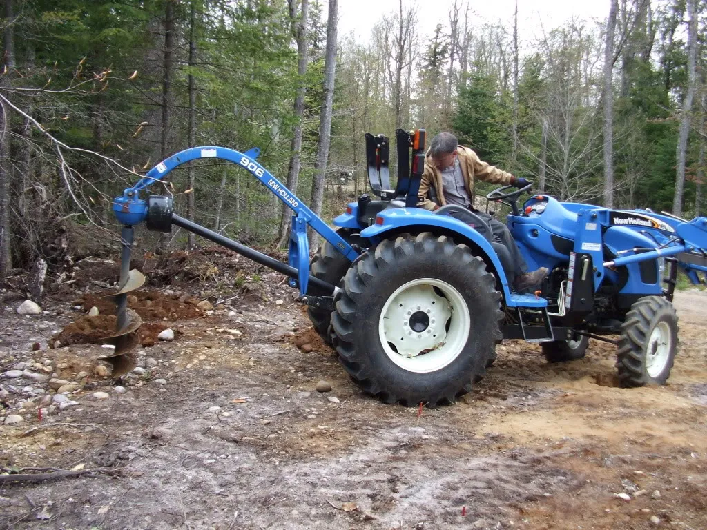

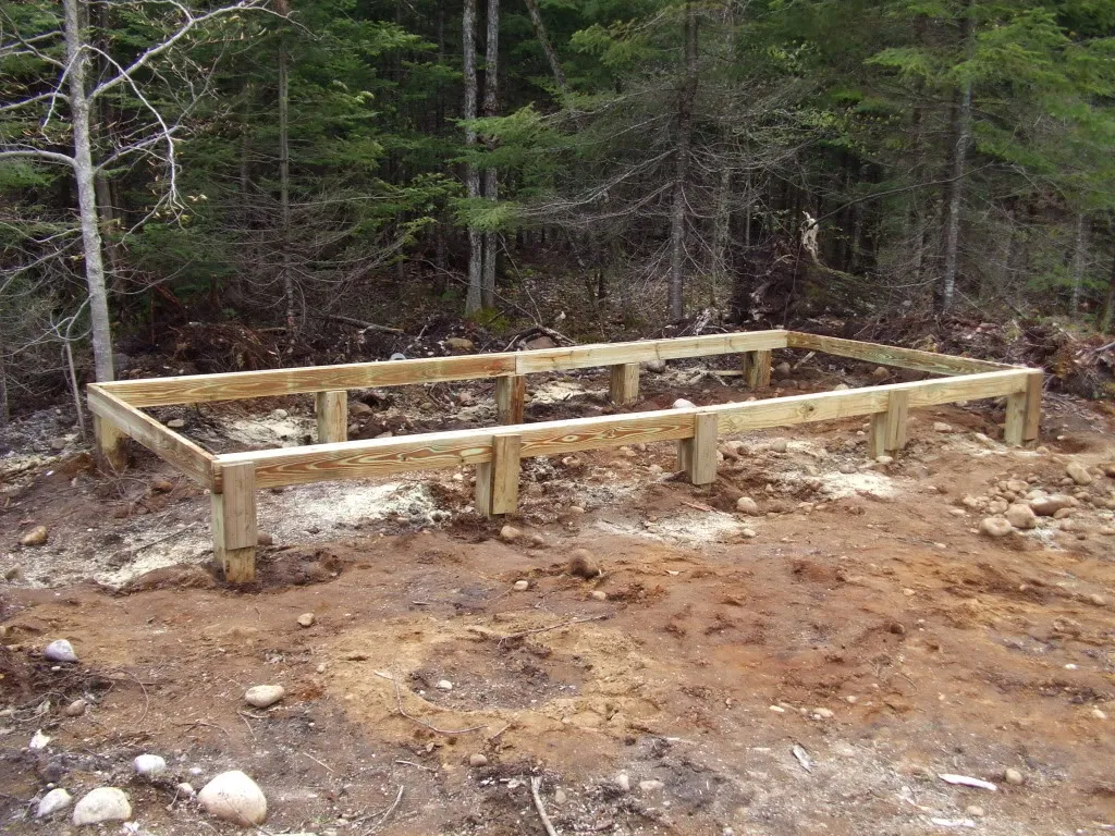

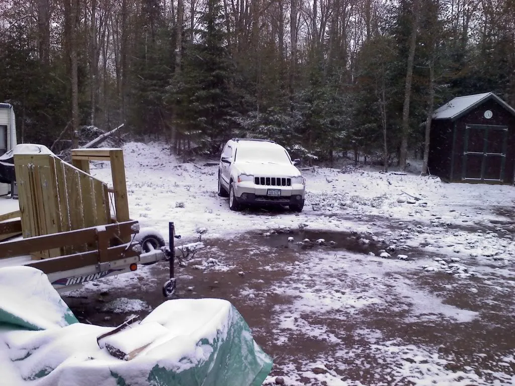

Went up a couple of weeks ago to get the foundation in.
Woke up to this
There is no better way to "dig" the post holes
The foundation is in ready for the next step

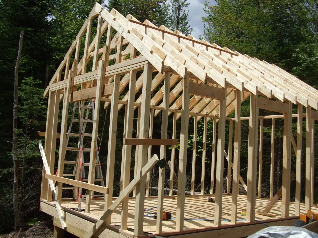

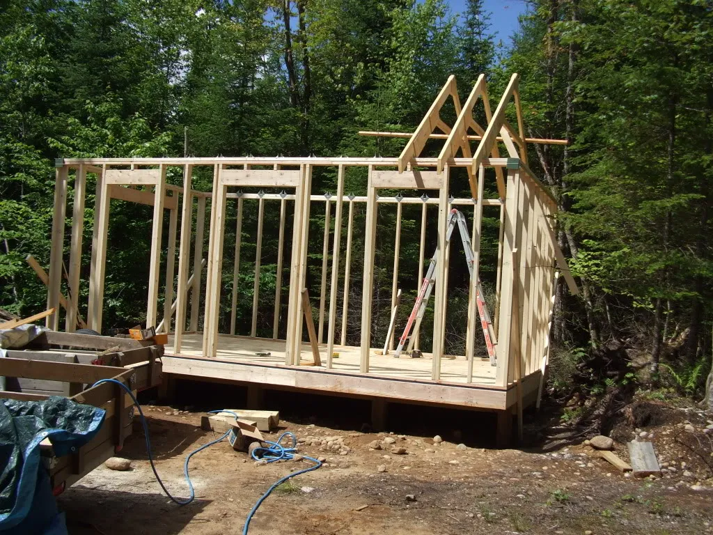

Went up this weekend to get started on my project
Started with this on Sunday afternoon after it rained all day..
I was working alone for most of the day and had to figure out how to stand up walls and not have them fall over.  I used a 2  4 frame to stand the wall against and then plumb them true.
After I put up the walls I ran a string line to make sure the walls were stright.  I also started to put up the rafters.
I had to figure a way to get the end trusses up by myself so I attached a temp 2 x 4 and slide them up the walls.
Even though I know it is not a race I went from the base to this point by 1:30 in the afternoon.
I had precut all headers, Top and Bottom Plates and all studs so it went fast.

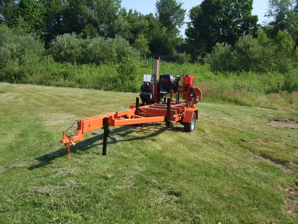

I also spent some time sawing lumber at my brother in laws.   I Plan on doing some wainscoting in my cabin and I am sure we will cut our own on his saw mill.

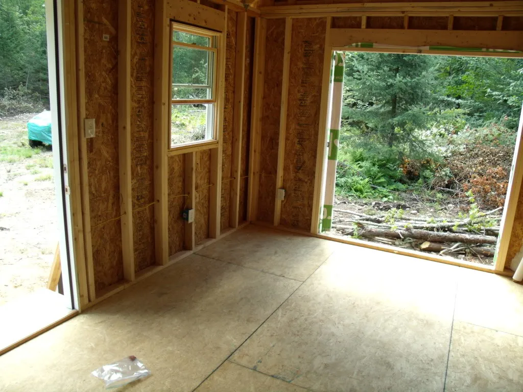

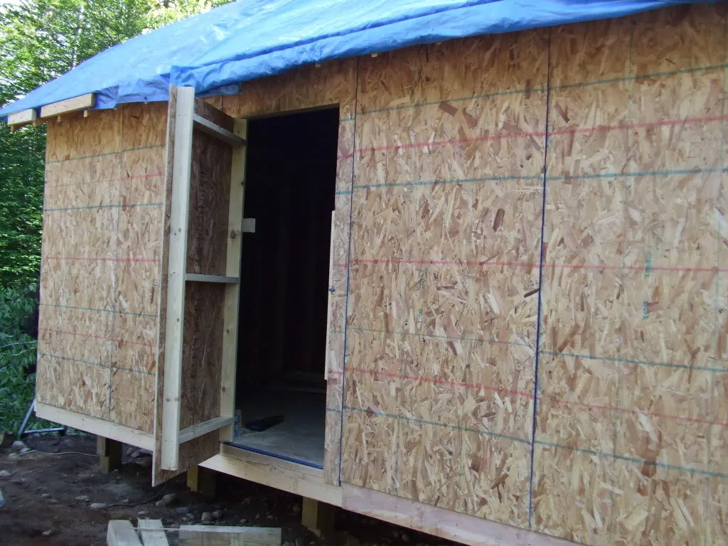

I had the week off and went up to spend some time working on my project  and relaxing.

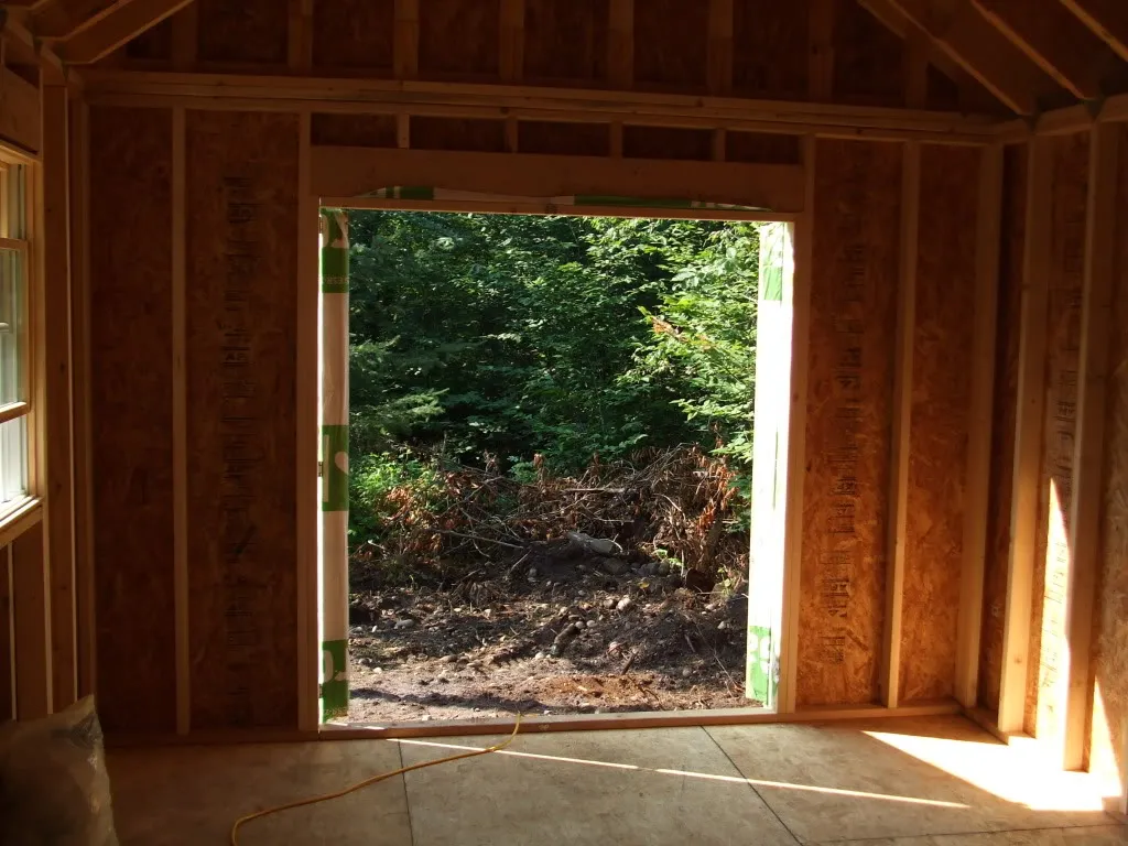

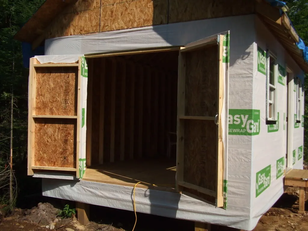

I got the windows and door installed in front.
I made temporary doors so I could get large items in and out of my building
This is the view from the inside.

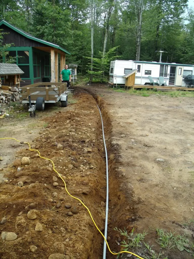

This weeks project was to get power to my storage building.
If it would not have been for my brother i would still be digging the trench.
I took my time and drilled every hole at the same height to pull the wire thru.  I ran three circuits two for power and one for lights.

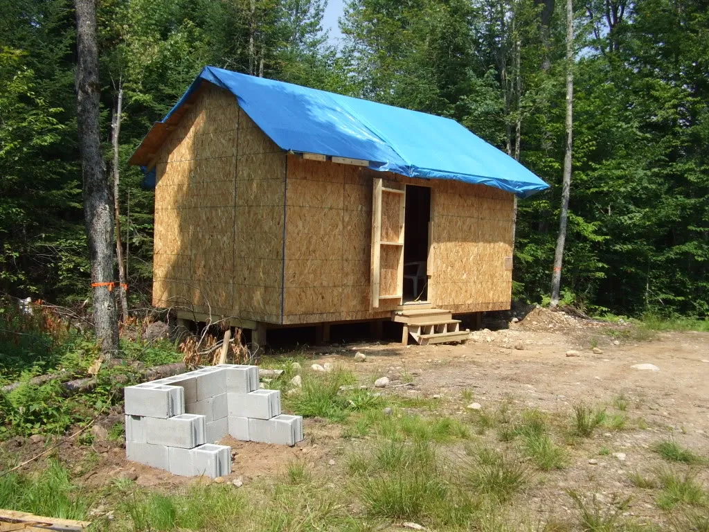

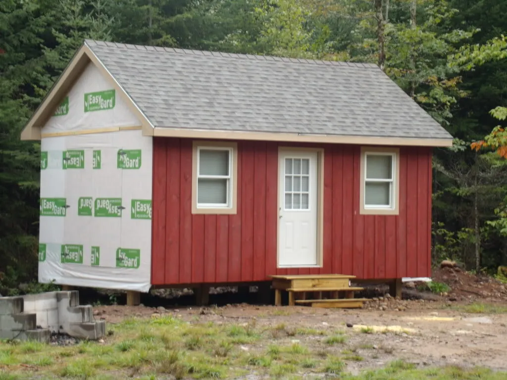

Spent the last week at camp. I got the roof on and finished siding the front.
I have set up the inside as a tool shed.
This picture shows a view from last years project, the screen house, towards the tool shed.
