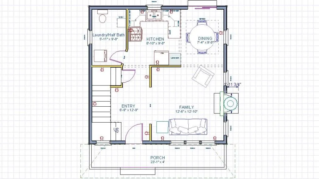

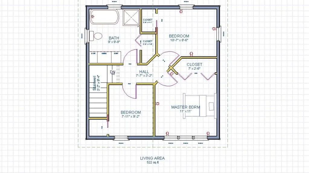

I have decided, after months of listening, talking and planning, to begin my venture into housebuilding. I have settled on a floor plan and hope within the next few weeks (depending on the weather) to begin breaking ground on the foundation piers for my home. I will progress only as fast as I have money to purchase materials since I do not have the means to acquire a loan nor do I wish to have one for this project. When I am done I want to be able to 100% outright say it is mine. The house is 24x24 with two stories. It will be located in east Alabama near Auburn University but in Chambers County. I have no inspectors to answer to with the exception for the septic system (but I hope to get around that by putting in my own system).
I welcome any and all input in my endeavor because this is going to be a learning process while building. Below is pictures of the floor plan as it is today. I know of a couple of "corrections" I will be making such as the addition of a bump out to accomodate a wood burning fireplace and possible additional windows.
First Floor (Updated Jan 19, 2010 8:30PM CST)
Second Floor (Updated Jan 19, 2010 8:30PM CST)

Any idea how the drain piping and water supply piping from the second floor bathroom are getting down to the crawl/basement/whatever??
John_M
I agree with Fred...you generally would like to have your water and waste lines on the first and second floors to be above/below each other to simplify things.  Maybe you could just reverse that bedroom and bathroom.
If this is your first build, you're gonna want to keep things simple.  Good luck!

   Yes, the plumbing would be of concern . . .   You could eliminate the wall between the 1/2 bath and the utility room. . .   It would really open up such a small area.  Also, you could tuck the water heater under the stairs.
  I am a "sucker" for a formal entry, like on your plan.  I dislike walking directly into the living room.
  You are building a three bedroom.  Probably a house full of people.  I wonder if the dining room is large enough to accommodate everyone.
  Out of curiosity . . . Why is there an electrical outlet in the linen closet, upstairs?    ???
  Limited closet and storage spaces . . .
  You may want to put windows in the two back bedrooms.  ;D
sgleaton I have to agree with others concerning the plumbing and the 2nd story windows.  In addition if that is a woodstove in the corner of the livingroom you may want to try to get it closer to the center of the house to avoid a tall and supported flue near the exterior.  If the flue extends past the highest point of the structure by at least 2' (minimum) then the flue will be long and additional support will be needed on the eve side of the house not to mention having to maintain it annually.  Additionally the flue as it appears will go up through the bedroom floor.  Although not a problem if you would incorporate the chase within a bedroom closet.  Maybe some reconfiguration of the closet will help.
If the stove was moved to the wall adjoining the entry (adjacent to tub on 2nd floor) then it would be much easier.

Thanks guys! I will make the corrections you suggested and repost the above pictures. I don't see that there would be any changes in the sizes of the rooms, just make that back bedroom a bathroom and the bathroom a bedroom/office. I can put a closet where the shower currently stands. I have already removed the wood stove and am going to put a wood burning firebox along the outside wall where I currently show the TV.
Not a full house either, just me. I am doing 3 bedrooms because if I have sleepover guests and will also utilize one as an office space for computer and crafts. I have no idea why there is an outlet in the hall closet. This was auto-generated. I had not noticed it and it will be removed. I am also going to remove the door placed in there and make that a niche instead. I don't think it is large enough until I start building for any kind of storage. Storage has been planned out and although not shown, the couch and chair has storage underneath. I found a place online that makes such furniture and is comfortable, practical and I think very neat. Windows have been placed in several places including the back bedrooms. I will replace the above images with new ones this evening.

I have now revised the plans from your suggestions guys. Please comment further if you see anything. I just updated the photos above instead of adding repeats.

Scott, you certainly have picked a cost effective footprint.  Not many try to make a square house any more, or even make both floors the same size.

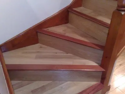

I would suggest that you put a riser in each landing of the staircase.  That will give you another 10" of living room without losing the large entry.
I don't see the point of angling the wall and door into the laundry/bath.
I also don't see the point of having such a shallow porch.  I like the idea of having a roof over the entry, but a useable porch would want to be at least 6' or even 8' deep.
Scott I really don't want to sound redundant but I am not sure you understand the concept of the woodstove flue being situated near the middle of the cabin.  I am not sure what pitch roof you are planning but with a 10/12 or 12/12 pitch on that size structure with the flue being situated on on the side wall you are going to have a extremely high flue from the point that it clears the eve until it stops at the minimum 2' above your ridge.  If you are going with double wall or tripple wall pipe then it would mean that the pipe will be protruding some 10-12' or so.  That will require intermediate bracing.  Then there enters the maintenance of cleaning which is going to be extremely difficult.
I have a side wall flue and a couple summers ago I had to extend it another 6' feet to enable a proper draft.  And it was about 7'wide and 2' thick of block. Still it does not meet the minimum 2' rule but I did not want that much masonry standing alone and bracing would be useless.  It does now draw probably 90% but the extra 10% would have been nice for downdrafts.
Just my $.02 worth to try to make life easier.
Scott, it might be more education to readers to see the evolution of a design. By that I mean leaving the drawings and adding modified ones as they are generated and placed in new posts.  Just a thought.
Re: chimney. This is a full 2 story if I interpret the topic title correctly. So it could be built with a 4:12 roof, which would make it easier to have a proper amount of chimney height.    If you are building the chimney all outside a method that would make cleaning the chimney easier would be to put a cleanout at the bottom where the through the wall section turns 90 degrees and goes up.
And I ditto the porch comments. A 4 ft deep porch leaves no room for chairs and easy access to them. $ feet deep though would be adequate if it was simply a stoop, a covered place to be out of the rain when getting the front door open.
I can't tell what sizes the bedroom windows are. Fire code doea require minimum ingress/egress sizes. That is not only for a person to be able to exit, but for a fireman to enter. Of course the fireman carries a big axe.
The minimum free opening area is something like 5.7 sq ft, min 24" high x min 20" wide. (IRC 2006) Even if you are free from code encumbrances I think this would be an area to be real safe and follow.
It would be good to check what code your design would fall under.

  It looks like your home is really coming together!  Flipping the bath and bedroom works well . . .
  You may want to "stack" the toilets directly above each other. . . It makes plumbing easier and helps with draining and venting.
   Again, I like the large open entry/staircase.  I can just see a bench in the U-shaped part of the stairs for putting on shoes.
   How about a couple of pocket doors between the entry and living room!
  As suggested, straighten out the wall at the bath/utility room.  You could then install a pocket door between the kitchen and entry.  That way guests wouldn't look directly into the kitchen.
  I missed it. . . But agreeing with the others, the porch should be larger.
  Here is a crazy thought!  What about a fireplace in the master bedroom.  Directly above the living fireplace.  Make the stack above the roof a little larger to accommodate the additional flue.  Move the bed to the inner wall.
  One more suggestion, if I may . . .  You could really open up the second story stairwell by removing the bedroom walls and then installing railings.  A couple of columns, if needed for support.  But still retaining the closet.  It would make a great office or family area . . .

Don - Windows: I think they are standard size windows. 28 or 30". They are of code. I know that a lot of the information is hard to see but I am learning the software and do not know exactly how to get all that information to display. I am sure that a some of the plan will change or redevelop as I start the actual building process and am ok with that. I intend fully on making everything to some code whether or not I have an inspector, which where I live I will not have to answer to. I think I have the pitch of the roof at 6:12 but probably, through your suggestion, go to a 4:12. I like that better actually. Thanks for telling me about posting showing the evolution of design.
redover - Chimney, flue - I removed the wood stove and have changed to a wood fireplace box with an outside chimney. I have always wanted a fireplace and this will work. I am happy with that placement as it puts a fireplace in the living area and still gives me the floor space I need versus the wood stove. I understand about the wood stove flue but was not willing to go on the inside like you suggested. I wanted to come through the outside wall.
poppy - not exactly understanding what you are telling me; however, my intention on this house is to do it in the Craftsman style and the stairs will be solid with risers.
bayview - thanks for the headsup on the toilets. I had not even looked at that when I corrected my plans last night! I like the idea about the fireplace in the bedroom and had not thought of that until now. Would I just increase the size of the chimney box to accommodate that flue as well? I ABSOLUTELY love the idea of pocket doors between the entry and living room. Thanks for the input on the half bath wall - how about a two-way swing door insted of a pocket door? Don't you like that idea for between the kitchen and entry? Gives the home and old style feel. Bedroom walls? are you talking of the wall with the front small bedroom facing the stairwell?

Here is kind of what I was suggesting; putting more risers in a smaller space.  Of course, if you plan to put a big craftsman style bench in that "U" then, well never mind.  :D
   how about a two-way swing door insted of a pocket door.  Don't you like that idea for between the kitchen and entry?
  Yes, you could make the chimney box wider . . .  You could offset one of the fireplaces and run the living room flue along side the bedroom fireplace.  Or, with a couple of 45 flue fittings you could stack one on top of the other.  Others may want to chime in here on this construction.
   A swing door could work between the kitchen and entry.  But, still consider a pocket door. . . There is a lot going on there with the  door under the stairs and the door to the bath/utility.  You would have that door open normally anyway except for company. . .
   Removing the bedroom walls at the stairs and building a railing would really open up that area.  That little bedroom would otherwise seem awfully small.  Keep the closet. . .

That is kind of the type of stairs I want anyway but cannot find how to build such a stair. Does anyone know of where I can find how to build these stairs?

Mcspin and whomever else has suggested, I kind of like the idea of opening that room with a banister. I will keep that in mind as I get to building. It would cut some costs since it is a railing versus a wall.
bayview - I see what you mean about the doors there at the junction of entry, half-bath, and kitchen so, yes, a pocket door.
