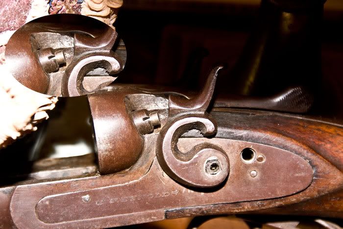

The right lock was working fine but the left has some issues. First the hammer was loose. That means someone has rounded it some or the spindle has rounded a bit. Easy fix. The hammer was twisted to the right too far and I suspect that's the cause of the loosness. Last, while it will cock and the trigger will release, something is keeping it from making the full travel to the firing pin. I'll need to pull the lock to see about that.

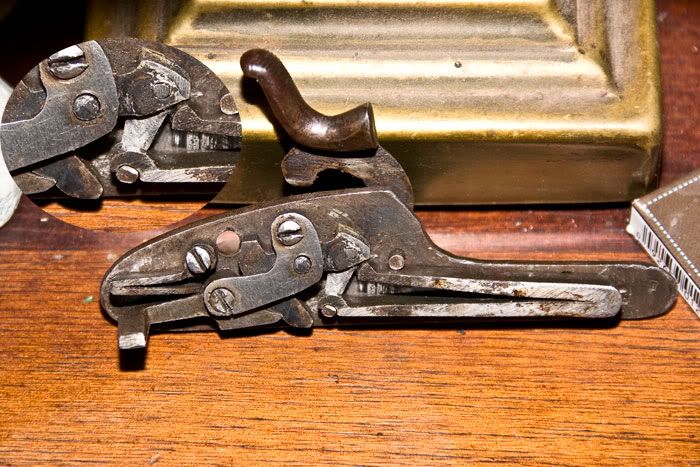

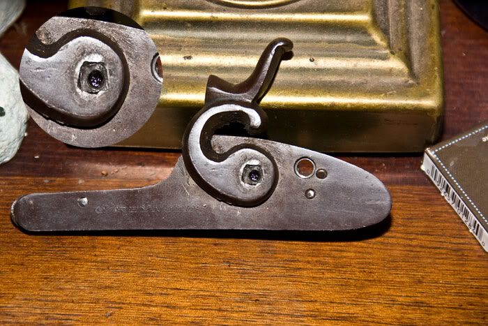

Pulled the locks off and like I thought, the right lock is OK.
Both locks have been rebuilt and as far as it went, a pretty good job. It looks like whoever did it, got tired and didn't finish the left. There are some other problems with the left also.
Problem number one is that the hammer retaining screw is stripped and it looks like the hole in the tumbler is also.
There are a couple ways to fix that including making a new tumbler . I expect I'll just reweld it and rethread since I don't know if the rebuilder hardened the parts anyway.
The next problem is the hammer is bent. That's an easy fix. It's turned slightly inward and back. I'll just heat it and realign it, then bend it down far enough to hit the firing pin.
The left firing pin has been replaced also and it wasn't fitted correctly. That shouldn't be a problem after I get it out. I've never taken one of these old pins out before. I suppose there is a special tool to remove it.
The only other problem I found was the screw that holds the extractor in place is sheared. that's just a drill and tap job.
