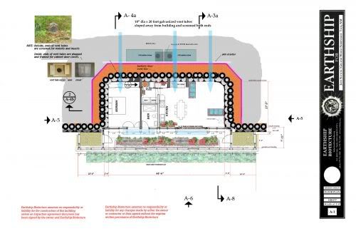

It works fine in southern states as well as northern.
Look at the Earthships built in New Mexico.  They use vection to help cool during hot summer days.
How it works is they have conduit burried under ground on the bermed up norther side of the structure and skylights in most every room.  When it starts to warm up, they pop open skylights, causing the warm air to vent upwards and draw cool air through the underground conduit.  A lot has to do with the front (southern) windows and the angle they have towards the sun also for winter heating.
link:  http://www.earthship.net/

I,too live in SC and want to build around Walterboro. The answer suggesting "earthship", really appeals to me, especially the cooling aspect to help keep cooling cost down. I wonder if I can tap into the earth at about 4-5 foot without water problems. I'm from the midwest and we all had basements but I understand that is not a good option here. Solar heat, solar hot-water assist and cooling ventilation and solar light tubes might save a lot of energy costs. Also want a greenhouse to start plants in and extend growing season.
