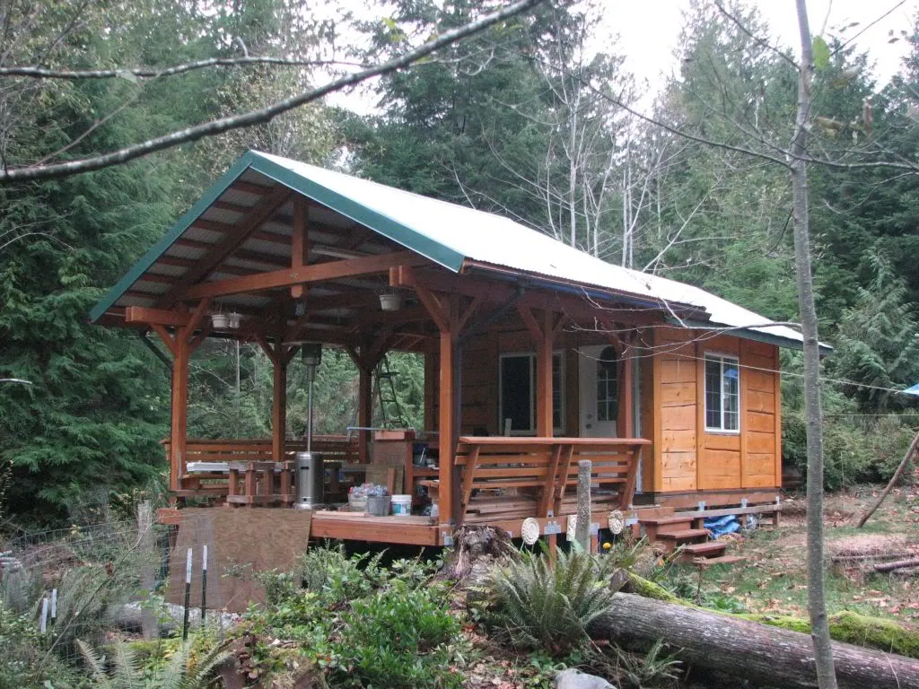

I wish I had found this place four years ago when I started this project...
As it is, I got an acre of land in western Washington, near Puget Sound, and then bought a load of western white pine logs so I could build a cabin.  Used inspiration from James Mitchell's book "The Craft of Modular Post and Beam"
If anyone is interested, I can go back to the beginning and describe the process.  Here is what it looks like this week.  Got the roof finished three days ago.
Looking from the northeast
Here is a view from the southwest
The cabin is 14x14 feet and the covered deck is 16x16.  The deck uses lots of store-bought dimension lumber, but the bulk of the cabin is from wood that started out as these logs...

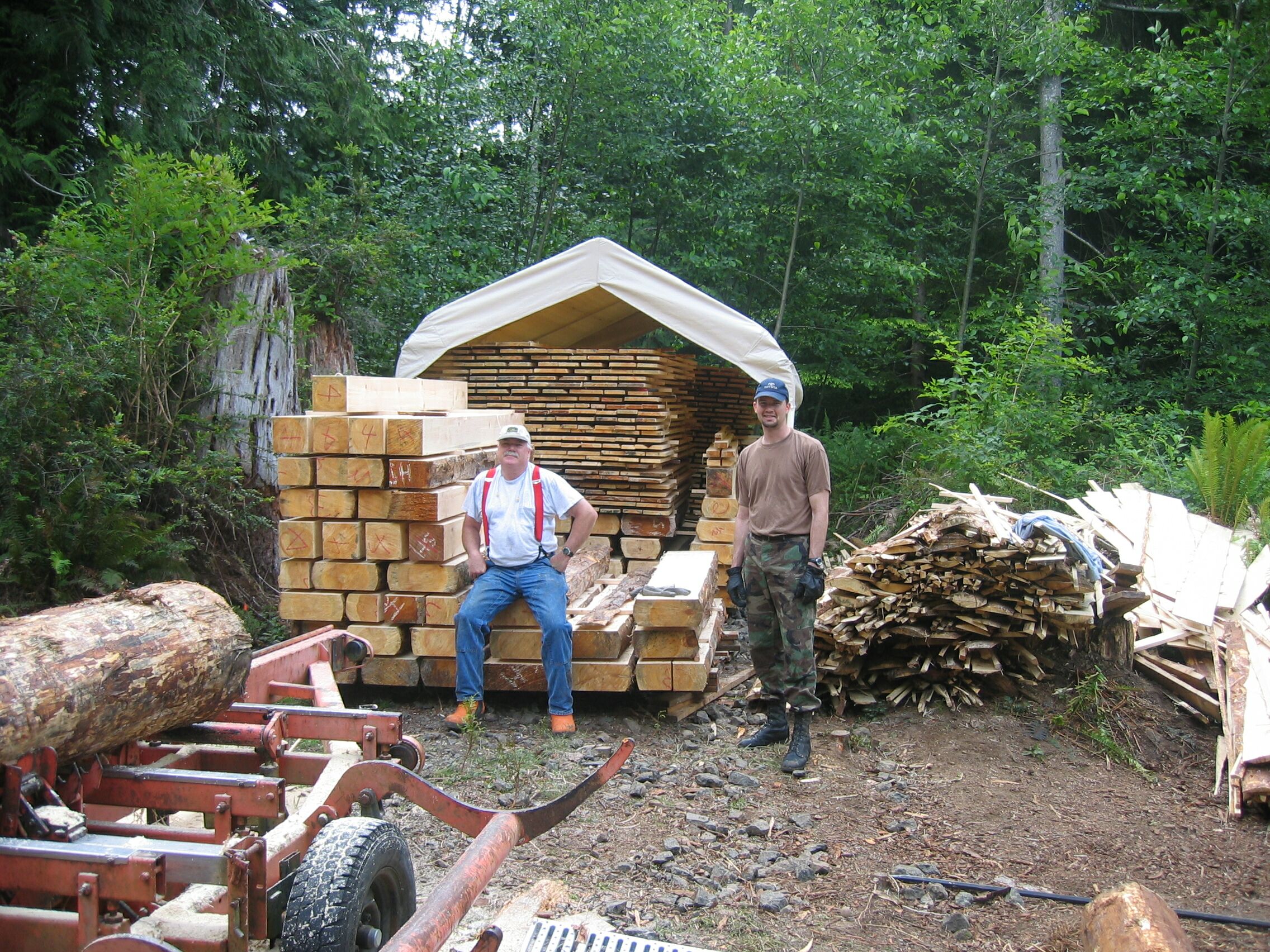

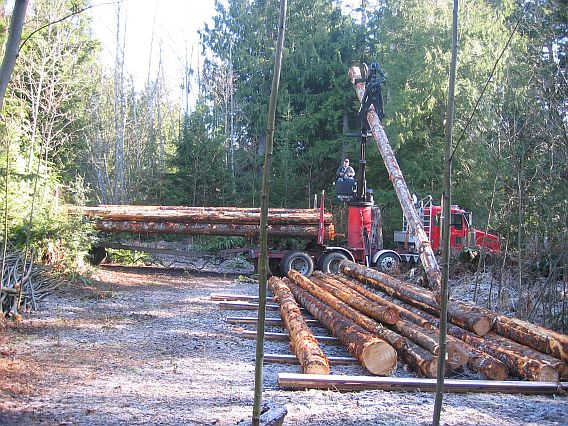

In the winter of 2006 these logs got debarked by my wife and I, cut into shorter lengths, and then a friend with a Woodmizer portable saw mill sawed the sides off to make 8"x8" posts, 6" thick wall timbers, and lots of 1"x? lumber in late June 2006.
That process looked like this...

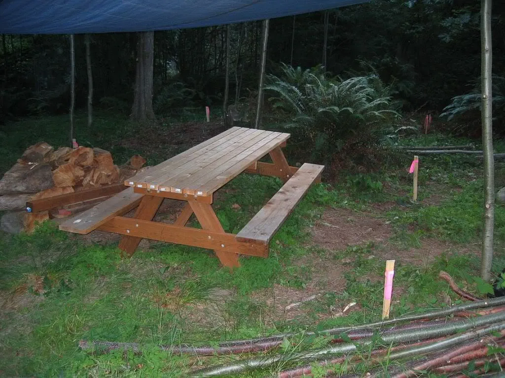

Every building project has to start somewhere, and this one started with a picnic table.  The stakes with pink flagging indicate possible cabin corner locations.  To see how I liked the site, I would set up the picnic table "inside" the possible cabin location and see how I liked it over a week or two period.
The final cabin site ended up in the background of this photo, about 30 feet north of where the picnic table is in this picture.  Choosing the building site is worth a bit of effort...

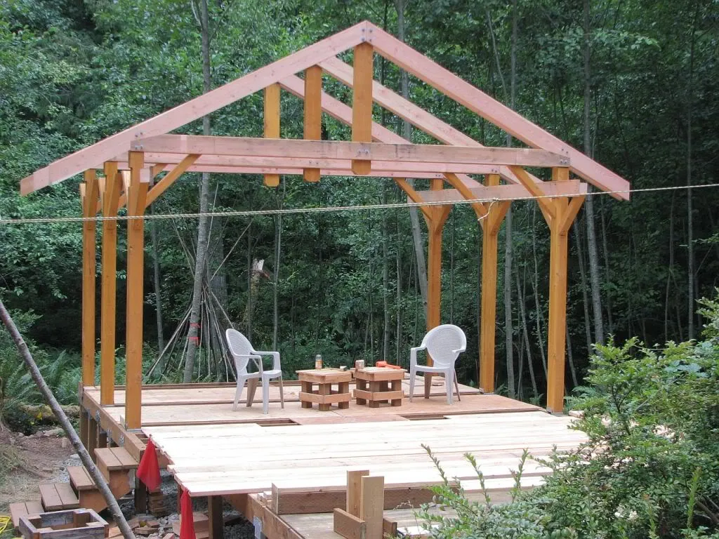

Here is a picture of the covered deck (in progress) and the cabin foundation
The deck roof is made of three timberframe bents made with a mix of mortise and tenon joints, bolts, and inset recesses in the 6x6 posts to hold smaller 2x pieces.

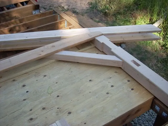

Here's a look at a stack of knee braces ready to be used to build the deck timberframe.
Pine Cone
Test fitting a 4x4 knee brace in one of the 6x6 posts.
Pine Cone
Test fitting one of the deck timberframe bents before drilling for bolts.

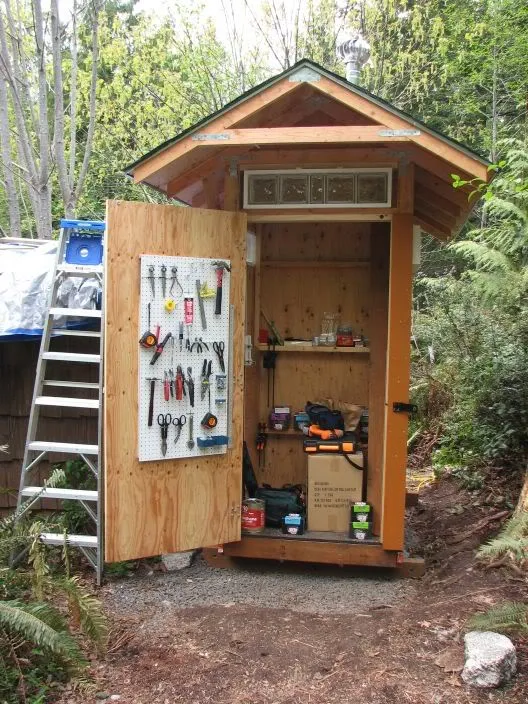

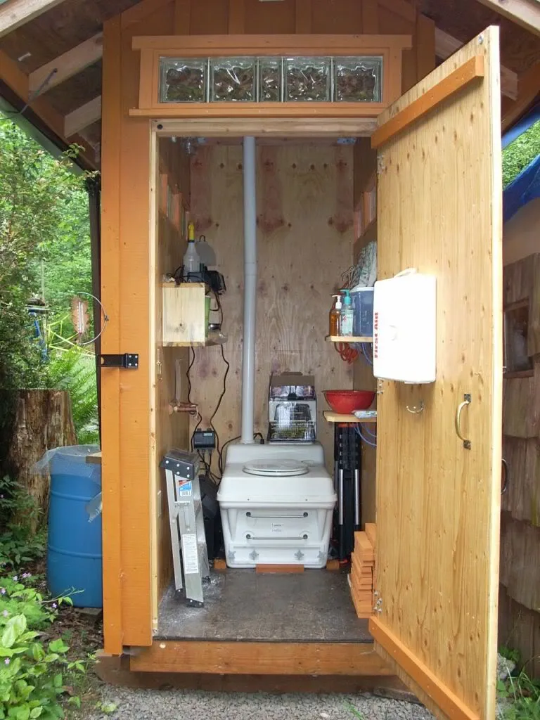

Here's some pictures of a small outhouse/shed that I build in 2007.  It is 4'x8', build on PT skids, and houses an Sancor Envirolet composting toilet on one side, and a small storage shed on the other.  I think the split is roughly 4x5 feet for the toilet side and 4x3 feet for the shed.  Used glass block to build windows near the top of the wall.
The siding is rough-cut western white pine milled while making posts and cabin timbers in June 2006.  Note the rain-water collection into 55 gallon drums.  My wife and I like to garden and this helps give us plenty of water for gardening as well as small amounts of concrete work. The old outhouse is on the right.  It will get torn down sometime next summer after I build a storage shed.  The cedar shakes on the old outhouse were split from wood on the property by the previous owner.  They are in pretty good shape, but the roof has leaked for years and so there is rot in some of the framing and floors.
Here is what the toilet side looks like.  Note the first aid kit on the door.  Luckily I haven't needed it too much ;D
This is what the shed area before I added shelves.
The property came with an old trailer with a shed roof over it built from 3-5" diameter poles cut off the property about 30 years ago by the previous owner.  I had to re-roof it, but that was all it really needed.  The old outhouse/shed would have taken too much effort to rework, so I decided to build a new one that would house a composting toilet.
Once again I went back to my forestry field experience for building inspiration.  The board and batten exterior reminds me of an old shack I saw out near Hyampom in1971, while the plywood interior must have been on at least half a dozen buildings I have lived or worked in.  Most of those didn't have any finish on them, but it seems prudent to varnish the inside walls on this one.
Decided to use plywood for the basic construction, the 4x8 size is from the sheet of 3/4" pressure treated ply that makes up the floor.  Lots of termites and carpenter ants around here so I'm using PT wood near the ground on all of my projects.  I'm also putting down rock on the foundation areas so I have a clean surface to crawl around on as well as an easy way to see termite tubes and other pest problems.  Used 3/4" clean basalt under the shed and 2" drain rock under the deck and cabin.

Is that Envirolet toilet hooked to electricity?
Pine Cone
Yup!  It is their hybrid model, has a fan that runs all the time on 12 volt DC, and has the option of running a heater (for the compost to keep it warm and dry it out if needed) that can run on 120 volt AC.
http://www.envirolet.com/hybrid12v110v.html
We've been running it for about  2 years now and it works very well.

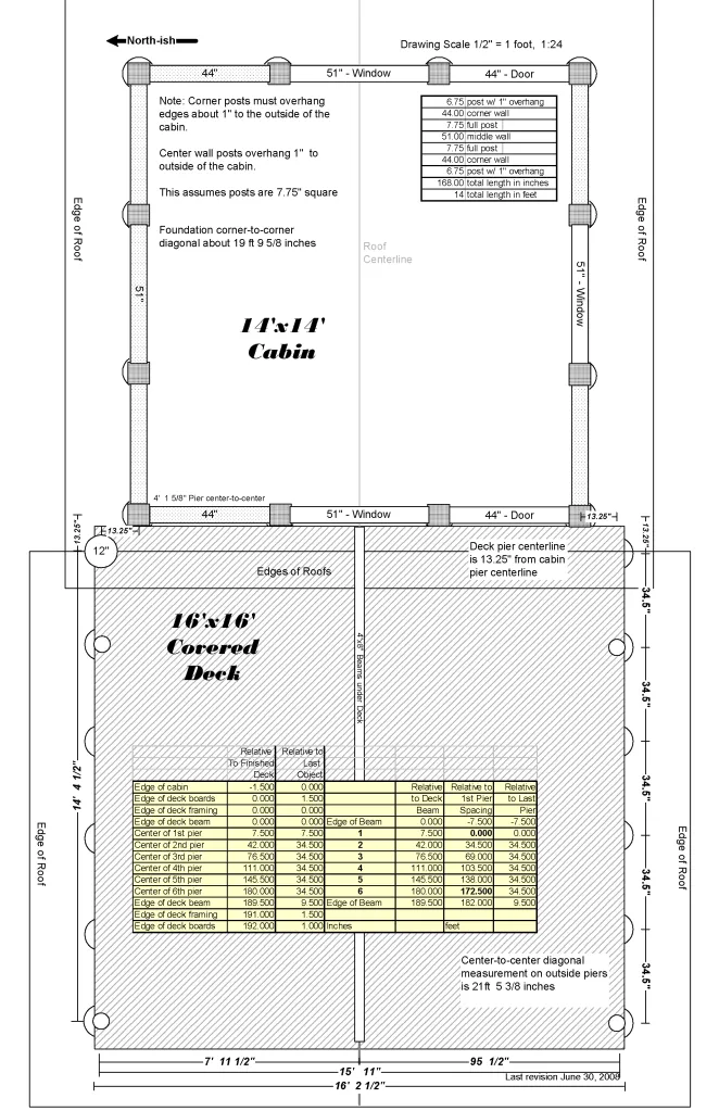

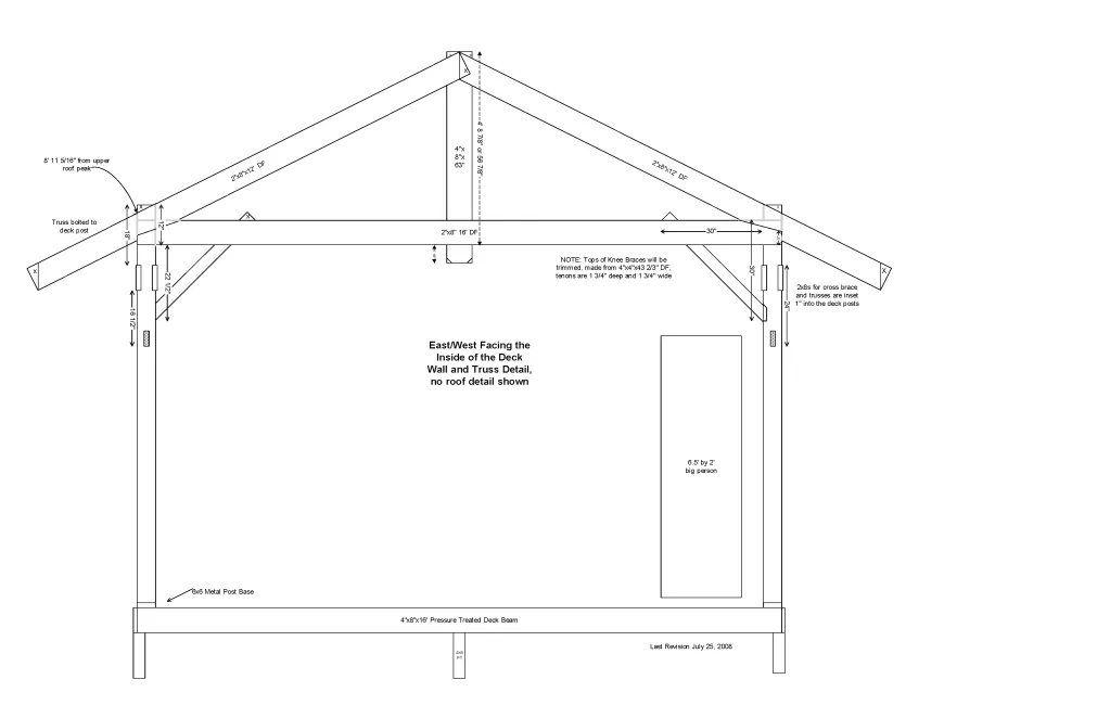

Here are a few of the design plans I drew up...  final as-built versions are slightly different of course ::)
The basic floor/foundation plans
Deck wall timberframe design, one of 3 bents
Deck wall side view (3 bents bolted together)
