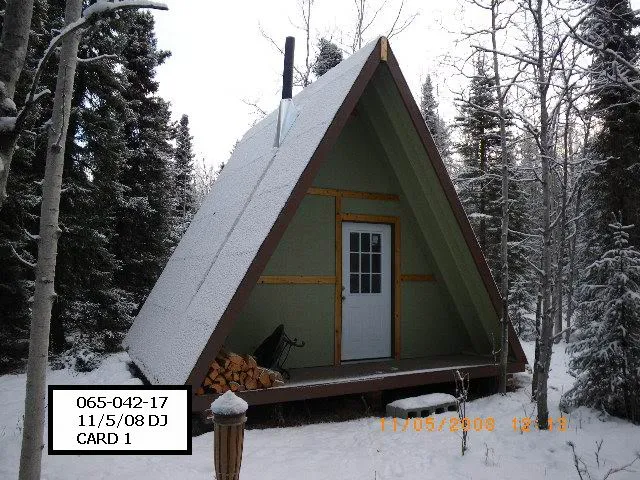

but I just bought this cabin *link* up on the Kenai Peninsula in Alaska. It's pretty much just a camping/fishing cabin. I go there pretty regularly to go fishing, so what the heck!!!
I bought it through a divorce situation for next to nothing. I bought it sight unseen, but am familiar with the area/neighborhood that it's in. I'm basically not too worried about my investment. It sits on just over a 1/4 of an acre.
What I would like to do is to get it onto a different style foundation. Post and Pier? My goal is to design a private family campground style vacation location. Add a bath house/utility/kitchen facility, septic, bring in power/water, maybe add a couple more small cabins to it.

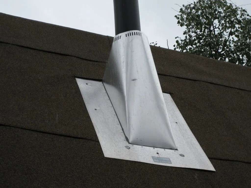

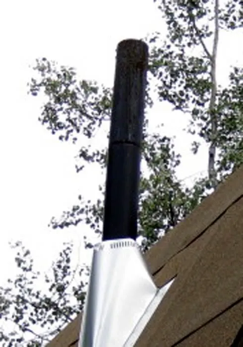

thats a neat looking place, sounds fantastic as a fishing shack.  I like your plans of building up a camping compound.  I do have one question from the pictures, it seems to me the roof asphalt shingles should come down over the flashing on that vent stack.
Does it stay dry and tight as it is now?  I am just asking the question as this is not something I have to do just yet and am hoping to get an answer mostly for myself.

It's not readily apparent to me what sort of foundation the cabin sits on. ???
My question is what is wrong with the present foundation? Why do you need to change it?
Muldoon, to me it appears that the upper edge of the chimney flashing is inserted through a cut slit in the roofing material. That would help keep the water out.

Like I said, I bought it sight unseen. I'm not to sure about the flashing around the stove pipe. That would be another project is to get rid of that rolled asphalt roofing and put on a colored metal roof.
As for the foundation, I believe it's on sitting on cement pier blocks. The kind of block that you level out and lay the beams on. They're not sunk into the ground. I was thinking more of a post style foundation and get it up off the ground a little more and enlarge the decking.

If it seems stable you might want to think about leaving it.  Replacing foundations cane be a bit of a task.
With roll roofing like that IF there is sealant under the roof jack it should be OK. I would have stuffed the jack under all of the roofing that was sliced so a upside down U cut out of the upper strip. Laid over the lower strip just as it was done. Lead the water to day light aways.
  What it really lacks and need is a storm collar that attaches or wraps around the round pipe , just above the roof jack. As it is water can / does and will run down the pipe all the way to the stove top. Which IF the stove is heated up isn't much of a issue except the sizzle sound , but when it's not heated the water will cause rust and run off the stove top and / or into the stove , possibly on to the floor.

You might grab a tube of asphalt sealer from HD or Lowes run it between the flashing and the rolled roofing to hold it down.
Well, shame on the rest of us, me especially, since I've installed two similar flashing in the past couple years.  d* d* d* :-[ :-[ :-[
There appears to be a gap between the chimney pipe and the lashing. And as PEG stated, there is NO Rain or Storm Collar.
Not only that, a second hard look has me wondering if that pipe sticking out of the flashing is really black pipe as it appears to be. That could explain the gap. That's not right and would be a fire waiting to happen if that's true.
Dang, have to look at the details better.  d* d*  Good one, Paul.
Yep, that sure is black pipe, probably single wall. Look at that gap in the blow up of one of the other photos. A very bad thing.
That black pipe should be replaced with insulated pipe following all the proper clearances. And a storm collar and a pipe cap added before any fire is built in the stove.
Thanks Don I was wondering what I was not seeing; but I knew it was not right.   ???
I am sort of ashamed I did not catch that...Those old stove pipe chimneys like that some times will work great.  That said when they don't it is tragedy just waiting to happen.  Don't take the chance.... they are never safe.  I know there are a lot of those old sourdoughs that will say "By Gawd they are!!"  Then there are some that literally have lost everything and I mean everything.  To bad they are not here to say they are not safe.

There's no doubt that chimney would likely channel the smoke from the stove to the outside. It's what might happen someday with a hot fire, or someday down the road after some wood that has been exposed to high temperatures, finally gets to the point where its ignition temperature has dropped to unsafe levels. If anyone wants to get into that discussion there is an old thread lurking around here someplace about improperly fitted steam heat pipe causing a fire after decades of service. MikeT brought it up I believe.  ???
Stay Safe!
Especially important for a new cabin owner that may not know the history and what can go wrong.

  Anchorage here. Just got my cabin warm and dry. You really need to evaluate that piping before lighting it off. Did they install some kind of thimble in the roof? Mine is Double wall Metalbestos, then a round ring, then a square box where it goes through the roof.
   Your foundation is fine for the KP. Many are done the same way. If you wish to raise the place you can just add some blocking and bracing. The KP has very little permafrost. If you are in clay you may experience some frost jacking. If so, it is accepted as normal and adjusting should be as easy as possible.

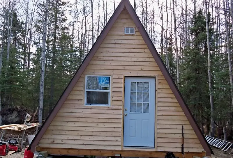

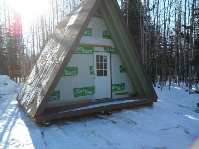

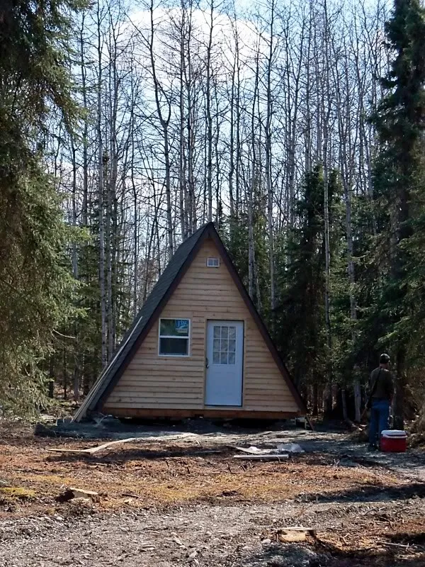

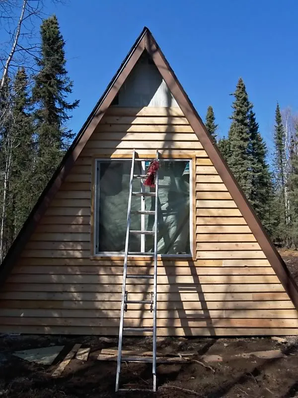

An update to an old thread.
I bought this cabin 2 years ago from a divorce situation sight unseen. I bought it for I think a pretty reasonable price and I immediately put it back on the market to see if I could turn a little profit. I gave it one year, and if it didn't sell I would run with it and turn it into a learning experience. Well it didn't sell so I started to have it finished. Due to logistics, I have to have it done for me and I think I have found a good and reputable contractor that is doing the finish work.
So far I've had the inside of the lot (0.26 acre) cleared to make it accessible. I had a driveway cut in and basically the middle of the lot opened up. I also had a "floating" foundation poured and had the cabin turned 90* clockwise and moved back 26' towards the back of the lot. Re-roofed with 5 tab contractors shingles. Had the front wall moved out leaving a 12" overhang. Floor was cut out, sealed from the inside, insulated, and new floor sheeting installed. There was only one opening window on the back of the cabin, so I had another window installed on the front for some cross ventilation. Sided with rough sawn spruce siding, and the last thing for the exterior is a deck the full width of the front (16') and 8' out.
Progression shots...I'll post pictures after the stain and paint work is done.
What it looked like when bought
Sitting in its new location
What it looks like now...
Back side before and after...
