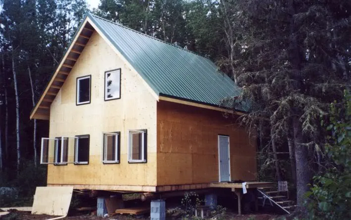

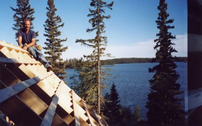

The first wall covered with Hardie Plank, 28 ft from ground to peak.
Finished siding this summer and added a roof over the deck.
It was too much work shoveling snow away from the door when we can get there in winter.
Prowler
No, it just has bend lines to resemble the gable fascia. Vic West did that for me
when I ordered it with the roofing.
