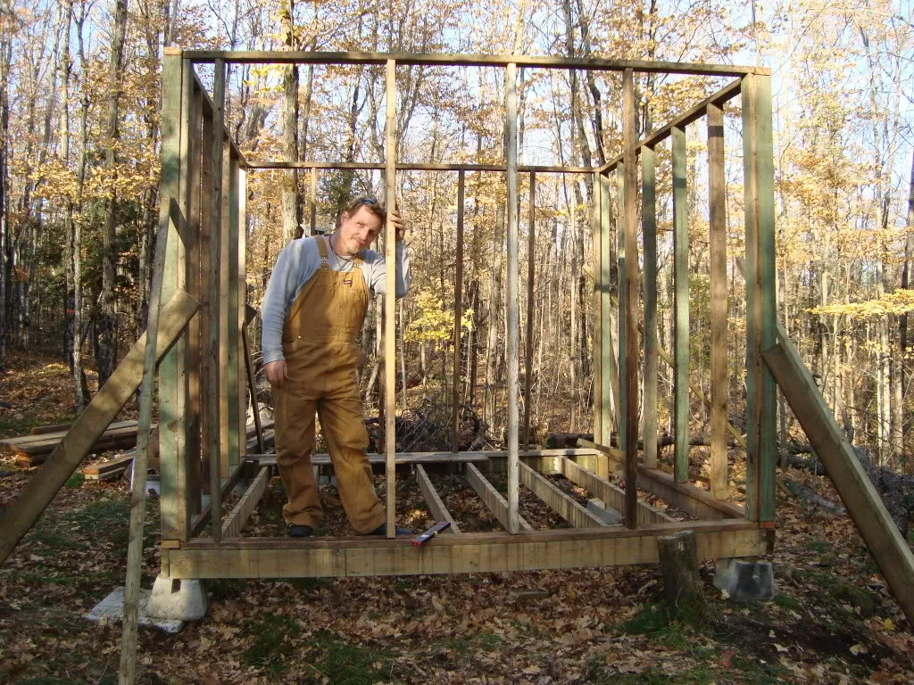

We returned Saturday and put up the walls:

Grover I was just curious on why you framed the walls before the floor?  Generally (but w/exceptions) the subfloor is laid on the floor joist and then the walls are erected.
grover2044
Hey Redover,
I really don't have any good explanation as to why I did it that way... the biggest reason, was at the time the floor was "undetermined" and we were kicking around ideas of roof sheathing, or the cedar slabs for the floor... After picking up all the plywood yesterday, I am thinking that I will take down the walls and place the floor on as you suggested... If I don't I will be putting in a 2x4 on its side for further support of the walls... Some times as the dream becomes alive we miss some of the simplest details...
