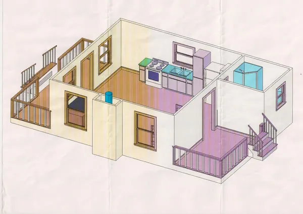

OK what if building a 20X20 single story what size beam would be needed and what kind of weight are we talking?
Here's a pic just for example:
A little single story house like this would most easily be built with a truss roof system or a standard framed rafter system (with rafters tied together with ceiling joists).
However, if you want to do a more expensive ridge beam supporting a single rafter (cathedral) ceiling, then you need to first determine the roofs (pitch, which way the ridge goes and what it lands on). You have to design a roof before you can trace the loads.

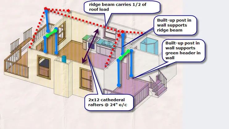

4/12, cathedral, over fireplace and kitchen... Can you explain "trace the load"?

Here's a mythical load trace on this house.
In a 20'x20' design the ridge beam is carrying 10' of the rafter load (5' from each side). If we are in a 30 psf (pounds per square foot) snow load and we add 10 psf for the dead load weight of the roof structure, we come up with 400 plf (pounds per lineal foot) falling on the ridge beam. Looking in a nearby table for glulam beams I find that a 3-1/8th inch x 13-1/2 inch glulam will span 20' and carry 427 plf. A 5.5" x 12" will also work. The short headers over the doors must also be checked as they are carrying over 4000 pounds that lands in the center of the header. A built-up solid post under each end of the beam and the sides of the headers carry the loads down to the foundation wall.
If the foundation is pier and beam the piers need to be located and sized to get this into the underlying soil.
