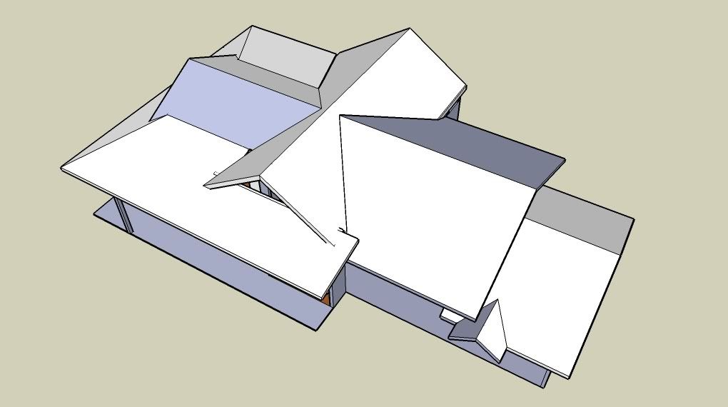

I've been playing with a somewhat similar cruciform design for a (I hope!) client.  This is a screenshot of where the roof is at the moment. This might give some roof ideas if you haven't gotten that far yet.
I've sketched the main gable in at 8/12, the cross gable at 6/12, the porch at 3/12. The site is very sloped but we can drain both directions from the foundation corners so I'm not too worried about moisture. The main gable on this is post and beam, 4x10 rafters on 4' centers with a 4x10 tie across at plate level, 2x6 T&G decking and sips above, wrap and strap would work there as well.

That's a pretty busy roof. I originally was going to go 12/12, just because I like the way it looks, but I'm re-thinking that. I've done two renditions- one with cross gables, and another with a 4/12 shed roof over the parlor and bedroom. Not nearly as stylish, but a lot easier to build. If I extend the main gable out over the back porch, the shed roofs could go along the same line, so there wouldn't be any valleys to deal with. Due to the lay of our land, only visitors will see the house; it won't be visible from the road. Our friends and family are coming to see us, not the house, so I really don't care about external appearance all that much. So much has to do with what we have for a budget, which won't be determined until we sell our current house.
