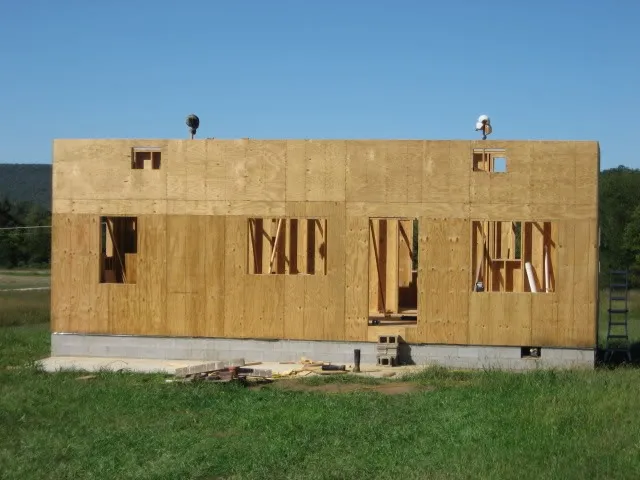

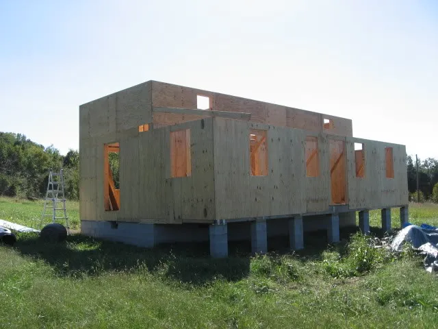

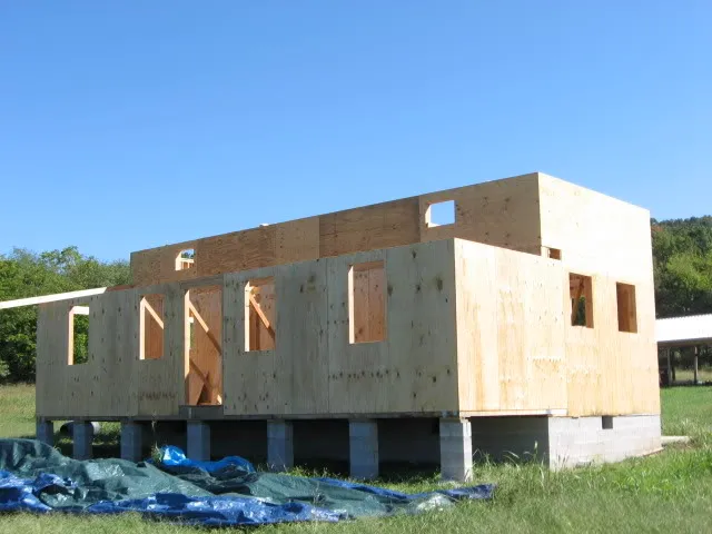

The weather has been perfect lately and I've been able to frame and sheath the north porch.
I'm having cedar posts milled for the south porch and they should be ready later this week.  I also picked out my rafters for the gable and both shed roofs so framing should start on that early next week if the good weather continues.  I completed the let-in ledger today.  The loft beams should be in by the end of the week.
I finished cutting out the windows including the awning windows that service the loft space.
Those are not security cameras poking out of the roof but the supports for my tarp.  I have a neighbor that just built a garage/living quarters on his land and unfortunately his door was kicked in and all of his tools were stolen.  I'm sure I got cased but maybe the would be thieves thought they were being watched!  ;D

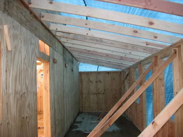

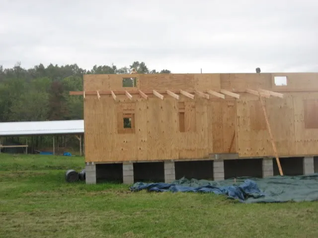

Over the past 2 weeks I've added rafters to the north porch.
and covered it with a tarp

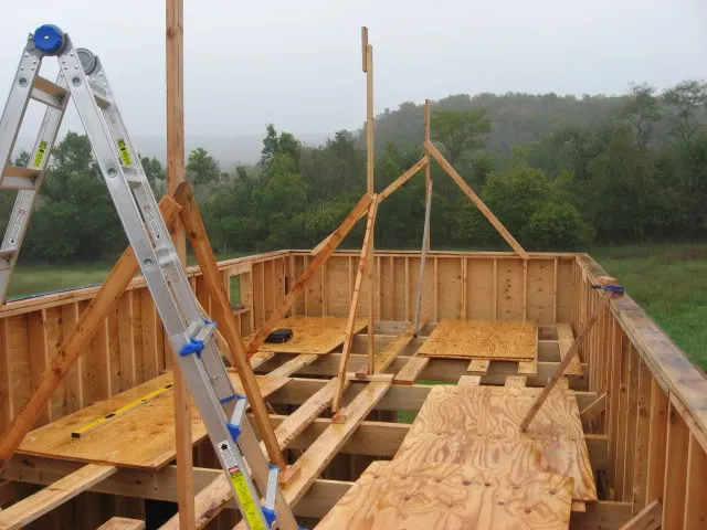

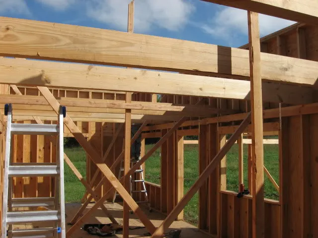

We placed the south porch/sunroom posts and added a built up 2x6 beam.
The 4x10 beams were set on the ledger and bolted to the studs- wow, were those heavy!  My wife and I managed to lift them into place without injuring ourselves.
and a temporary floor was placed- well, sort of a floor.

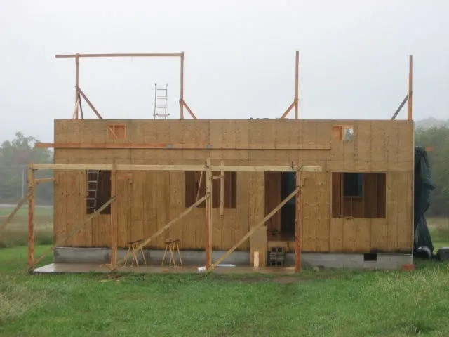

Today I added the supports for the ridge board and later this week we hope to start cutting rafters.  The 2x4  is not the ridge board- I was just experimenting.
I cut a mock up rafter and decided to go with this cut down of the rafter tails.  The real ones will overhang about 8-10 inches.  We'll use the h 2.5 clips to secure them to the top plate.

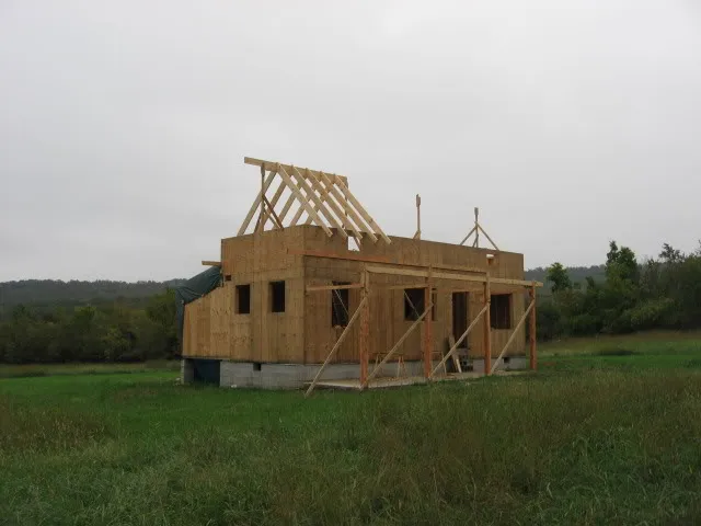

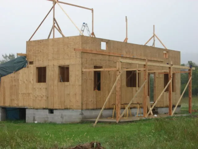

Got a few rafters in place yesterday. It was a rather cold and windy day so that put a bit of a damper on the fun aspect. I'd cut more rafters but we went slowly since we've never done any roof framing before.
My wife did a great job holding the rafters plumb while I nailed them to the ridgeboard
Getting them in place was fairly using the thrust block technique recommened in Carroll's Working Alone book.  The rafter just sat in place waiting to be nailed.
At least the house is now starting to take some shape and not just look like a box.

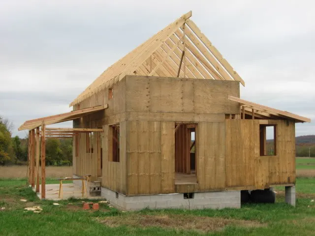

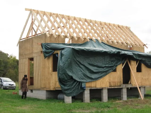

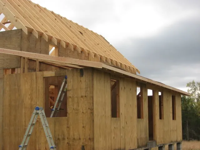

Well, we made out goal of getting the rafters up before Sunday!  ( I have to work tomorrow)
Still have to add subfacia, barge rafters and plumb cut the tails before sheathing but we're happy!

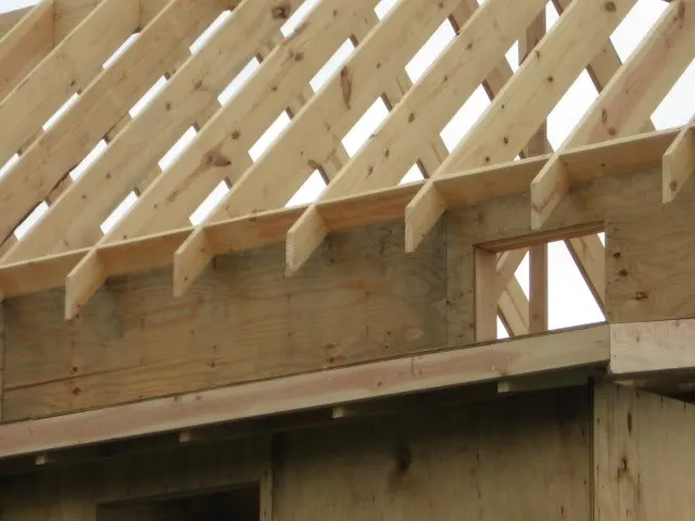

I did decide to pre cut the let-ins on the end rafters for the lookouts.  I felt that it would be easier to use some sort of template to mark and transfer the cut outs on the plywood rather than climb the 12/12 pitch with my heavy worm drive saw to do it in place.  I think I will take Redoverfarm's advice and install the barge and lookouts preassembled.
Several have commented on the thrust block.  My wife and I were talking today and we can't imagine how much harder it would have been if we hadn't come across that one.  Trying to hold the rafter in place and turn it so it's plumb with the layout lines--impossible!  There are many other gems in John Carrolls book, Working Alone.  I can't recommend it enough.

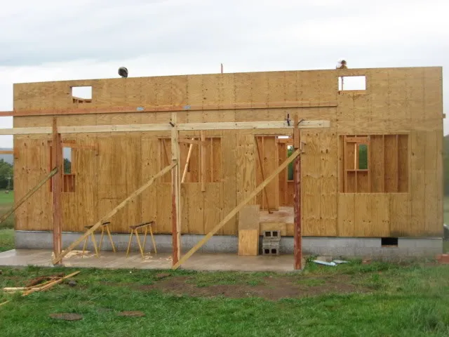

Don- I did manage to get 2- 14 ft 2x4's at each end crossing at least 7 rafters each.  We also added several 1x4's to the other side.  Should that be enough? It feels very stable.

I know that feels good. Yup you should be able to take some wind. I get nervous if just the braces on the poles are holding it all in rack. Until its sheathed its probably at its most tender stage. Looks like y'all are having this cold snap too, we're supposed to clear out and warm back up next week.
My way is definitely not for everyone but I install the lookouts a couple of inches long, chalk a line and trim them all to that in place straight line then install the subfascia. I use a lightweight sidewinder but its still not the safest move.

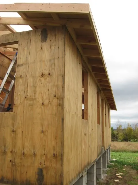

We added blocking and cut most of the rafter tails to size.

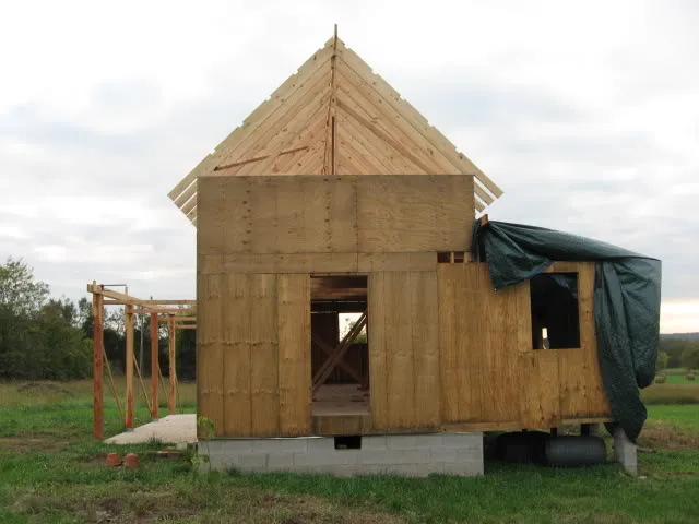

Got the barge rafters and subfacia attached to the north porch and started adding some sheathing panels.  I forgot to purchase the  H clips so I could only do one section.
And we also added rafters to the south porch/sun room.

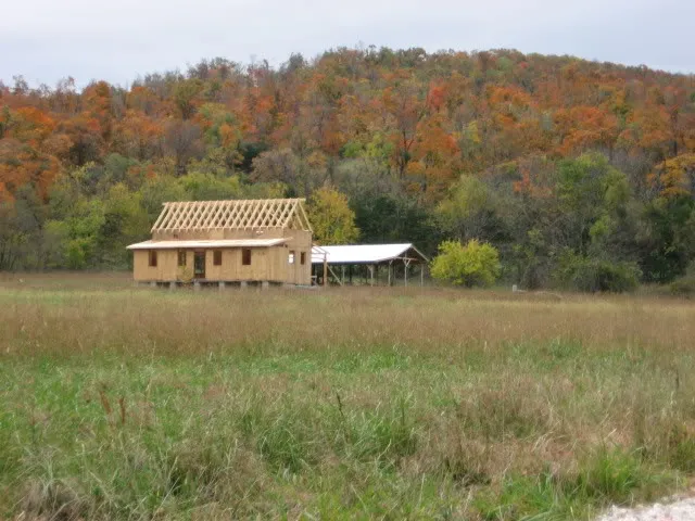

This is the scene that greeted me as I arrived early this morning.  Can't wait to wake to to that!  Our bedroom will be upstairs facing east.
The fall foliage has peaked and many of the trees are now shedding their leaves.  Still a little color around to enjoy.  There are a few maples up on the hill.  It's been beautiful fall.
I'm really looking forward to getting this thing dried in.  Colder weather's just around the corner.
