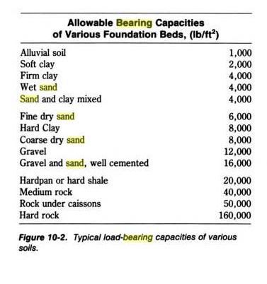

Possibly of use here when we think about footings.  I don't like to bury the poles - I had three with problems - the only 3 I buried.  You don't want preservatives in your living space though so a footing with a pin is what I went to.
from  here
http://books.google.com/books?id=1rxKLpO0kyIC&pg=PA130&lpg=PA130&dq=weught+bearing+capacity+sand+square+foot&source=bl&ots=5Hpg3yUFBa&sig=KjElCFuuzJVYyY96D0EOhIYnbXU&hl=en&ei=42UPSqWeB4rwswOQwrGSAw&sa=X&oi=book_result&ct=result&resnum=7#PPA131,M1

Here the ground was solid enough that I didn't need a footing.  In your case with the sand I would suggest about a 24" x 24" minimum  concrete footing at least 8" deep with a short - maybe 4" min high by 8"round or square extension up to set your post on.
What do you find as the soil type there - dry - hard pack - fine - ?  I was just assuming from what you mentioned earlier.  Larger footing size if soil does not seem like it will support the weight.  This structure is pretty forgiving in that you will be using trees and not expecting things to be more plumb - straight and square than the best you can do with the fine "rustic" standard. :)
I am giving you suggestions of what worked for me but ultimately it is up to you to decide on the safety of any given suggestion.  My soil conditions were such that a tractor would not move a steel ground pin - you have sand.  Still doable with proper modification.  Sand is just small particles of rock. d*  Not as supportive though.
