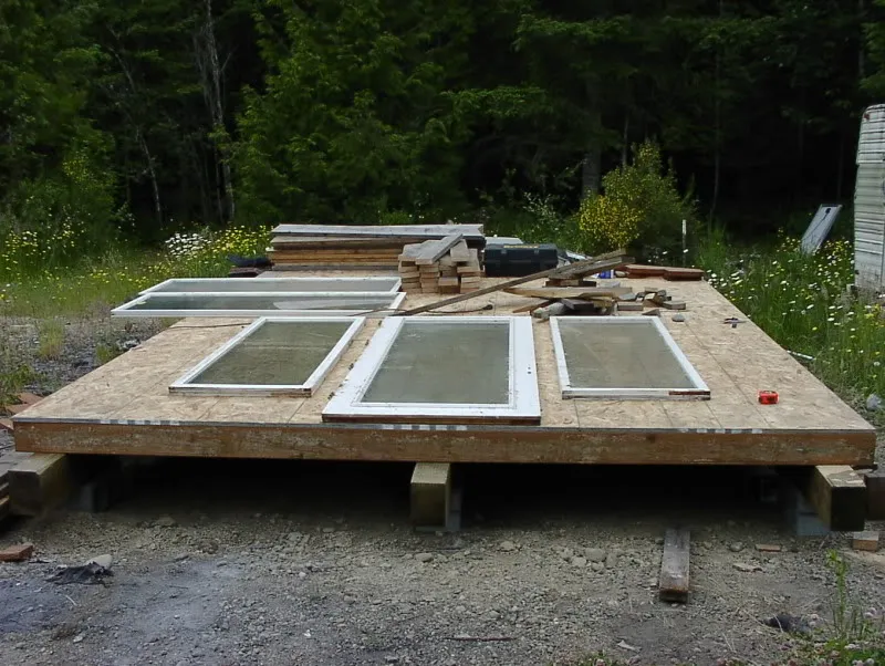

Two weeks ago I set an achievable goal of simply getting the foundation (such as it is) leveled and set, and the 'deck' built. (bear in mind this is all happening 2 hours from home, so I'm pretty much relegated to weekend work) I fully intended to photo and post at that time, but I completely forgot to grab the camera, so this will be a double update.
Completed deck with my truss cutting set-up.
Yes the 'foundation' is only cement blocks, but this structure will only be on-site for a year or two before deconstruction and relocation, and a 30x60 shop is going to be built in it's place, so I couldn't do anything too permanent. (Remember I'm 'pre-constructing' on a friend's land). One of my roommates managed to acquire some full length glass doors from a business remodeler for me that I had originally planned to use for solar air panels. However I decided that the double glazing made them just a bit to heavy for my comfort level, so I spent some time (with my friend working his Auto-cad magic) figuring out how to incorporate all the glass panels into the 'south wall' for the purposes of passive solar gain instead. We doubled the studs on either side of each panel just to be on the safe side for load bearing capability. They wouldn't all fit (roomie scored 7 total!) so we figured out the west-wall entrance/window layout too. Here you can see the door and side windows in a rough approximation of how they will be configured: (yes, the door and window tops will be level w/ each other)
And here is the 'back' door I scored for $10 at the 'local lumberyard sale':

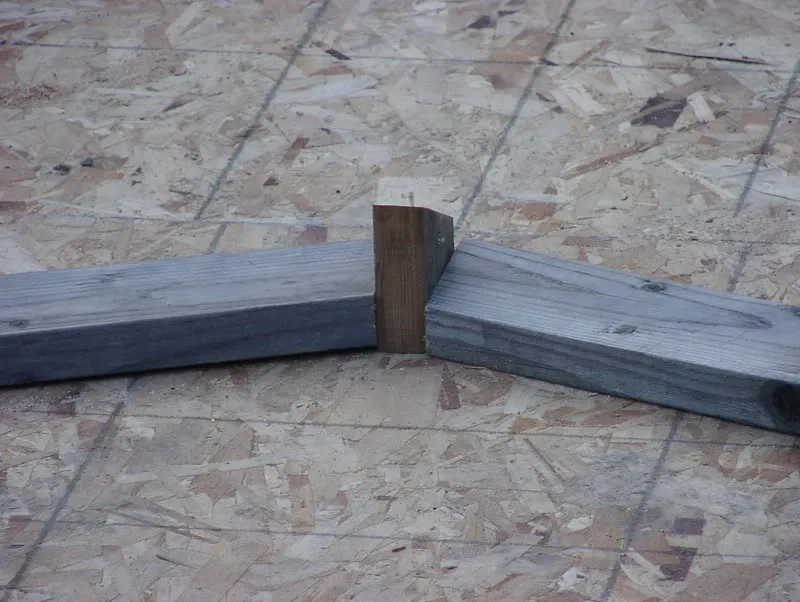

With the deck completed I had a work surface to cut and assemble the roof trusses. 72" sides, and 48-1/8" tops coming together in a nice, perfect peak....at least that's how it was SUPPOSED to work. Apparently the 'pointer' on the sliding compound saw got bumped and the 22.5 degree setting was a tad off. Just a fraction of a degree, but it was enough to leave a 1-1/2" gap at the top:
I had a choice of either refiguring the angle of the cut for the top pieces to bring them together or find some other solution. Fortunately a 2x6 will fit nicely into the 'gap':
...so with a little redesign of the gussets, I opted to go with a full length 2x6 ridge beam. A side benefit of this is that I pick up an additional inch of headspace whereas I'd lose some were I to recut the angles. Having solved that problem, I set about stripping the plywood for the gussets:
I also need to cut some filler blocks to go between the gussets so I have something to anchor ceiling material to (was tempted by some 6"x16' T&G pine for $6.40 each at the sale....one piece would go full length on the ceiling!), but of course both my batteries got drained mid-project. (Apparently those circular saws really put a hammering on the battery). The original plan was to have the trusses sit directly on the upper flooring, but closer examination of the T-111 I purchaed revealed 10' lengths instead of the 8' I thought they were. So we figured in a 19" stubwall for the upstairs (16" spacer w/ single top and bottom plates) This will bump my headroom quite a bit upstairs, and actually improves the overall proportional aesthetics outside.
Once the gussets are cut, and the blocks specced out I'll assemble one truss 'DTFO' and then screw some blocks to the deck to act as a fixture for the remaining trusses. (A 'trick' from a BHM article I've been wanting to try). The plan is to have everything pre-cut and/or sub-assembled as much as possible, then get everything up and dry in one day...two at the most. If all goes well that should happen over Fourth of July  weekend.

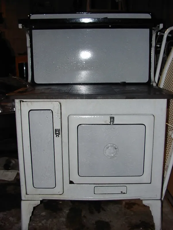

That's really a great looking old cook stove you got there.  Is it wood or gas?
I would like to have an old stye farm sink in my cabin, but haven't found one yet that is affordable.  It would bring back memories of the old farm house I grew up in.

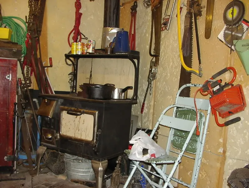

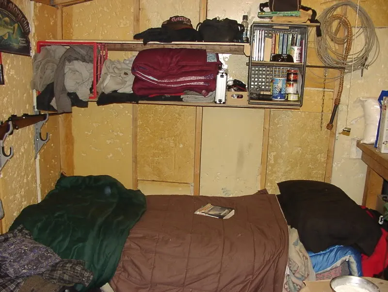

It's been a while so I thought I'd throw in an update on my overwintering arrangements. About 2/3 of the insulation I brought up went into the previously mentioned 'man-shack' and, while I spend a vast majority of the time up at the main house with my hosts, it's now my bedroom/personal space. Unfortunately I only get to occupy about half of the space as a vast majority of my host's tools remain there in storage.
The wood cook stove is a mixed blessing. It's easy to start and I can actually cook things (I've gotten really good at making biscuits in the oven!), but the firebox is small and I can only damp it down so much so I get to choose between roasting (if I keep it loaded) or freezing (in the morning) if I let it go out. It's not a tough choice as I prefer to sleep in a cold room with lots of blankets. It only sucks when I have to crawl out of bed and put on cold clothes. ::)
Whitlock
In hunting camp I sleep with my clothes shoved down in the foot of the bed No t cold in the morning that way.
Cool place,W
And I thought I was living rustic.  Just goes to show that its all relative.  Great pics by the way.  ;)
FYI I found a way to overcome the really cold in the AM problem.  I have a franklin stove/fireplace that cannot be sealed down to burn all night, its no way airtight.  I found these "presto" type logs that are only compressed sawdust, no additives to make pretty flames.  I'm so far getting them at $1 ea.  On a cold night I chuck one on a bed of coals about 9PM, and at 5AM i still have a log of coals, warm and easy to stoke up a new fire.
