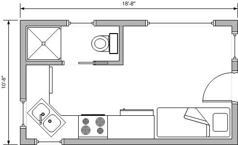

Coming in at 199 feet, everything a single person would need...
Thinking something like this would be very quick and easy to build.  I'm thinking that an under-counter fridge (next to the stove) and an under-counter washer/dryer (next to the shower) would leave tons of counter space, which is one of my must-haves for food prep and preserving.
For HVAC, a mini-split should work nicely.  Not sure about hot water though... is there an all-season option for mounting a tankless heater on the outside of the building or perhaps something that can be installed under the sink?
For the bed, I'm thinking a super-single on a loft frame, with a sofa or desk under it.  A sleeping loft might be a possibility but I'm thinking that a usable loft would make the building too tall.
You can get a small water heater to install under the sink and a heated shower head in Electric as an all season solution.  An outdoor mounted gas tankless would not be able to be used in all seasons if freezing is a problem.

Wonder if anyone else who has considered building a living structure under 200 s.f., considered going slightly larger and putting up with building inspections.  I have a good design at 198s.f., but if I bump it up to 242 s.f. it becomes much, much more livable.  In my area - you don't need a building permit under 200 s.f. -- but the structure is still taxed anyway.  And I have to install concrete piers -- and the cost and time to do that would be the same either way.
Has anyone built a small structure thinking that they won't get taxed - and then find out that they did - and said to themselves - if I had known that I would have built bigger?   I understand some have remote property where no one really is going to check - but in our instance the neighbors question everything that goes on and eventually the assessor will put the "shed" on the tax rolls.

If it is habitable it is never exempt. That under 200sf (or whatever your state uses) exemption is for accessory structures. That is, accessory to a primary residence. It is for an outbuilding not a house. I've seen them removed. Not saying I like it but that is the law and often enough the interpretation, don't build more than you want to lose if you go that route. A camper would probably be a better route nowadays. I've seen my shadow on google earth, I'm pretty sure I could tell you what was in the back of my truck from that imagery.

You would be safer and wiser, when building a habitable house of whatever size, to bring it into compliance with your local codes and zoning laws. The under 200sf thread here was not a recommendation to build that small but just a design challenge for a minimal space to live in.
