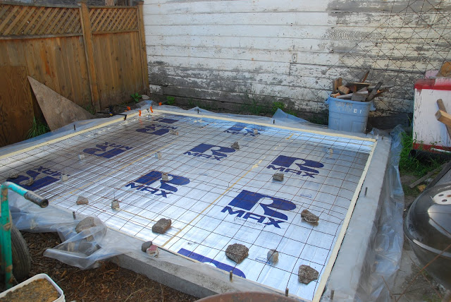

Well, progress continues! Finished pouring the floor slab
6mil poly, 1.5" rigid foam, 6" welded wire mesh. Foam is placed around the edges with a 45 degree bevel for complete isolation from the ground. The house will be passively solar heated in the winter and this should go a long way to keep the floor warm
We chose to do an earthen floor with 1/15th cement. The clay/silt/sand and urbanite aggregate was from on site. The bottom layer is an aggregate rich mix while the top is fines mixed with red powder pigment; this will be the finished floor
End result is pretty good. Has a bit of "character" for sure. Going to take a good while to dry and have the color even out.
Next, framing!

Since it's allready done , there might be no point in mentioning it besides others whom might read.  It looks like the insulation you put down is polyISO.  I don not know of any styrofoam that has a reflective surface.  Poly Iso does not work below grade because it absorbs moisture more the sytrofoam (usually pink or blue in color).  I would think even the poly you used should help a bit anyway b/c I doubt the cells will fill completely with moisture?  If for some reason you feel you are losing heat through the floor you could always add 2 foot of "wing" insulation (Blue board or pink board ran out almost horizontally, with a bit of pitch going away from your frost wall)  This could be done any time after.

Thanks! We winged it with the pigment, just randomly chose a ratio
I was concerned with whether this foam board was suitable for below grade applications so I consulted with the company and they claim that its suitable. Their FAQ: http://www.rmaxinc.com/faq.asp
We'll see though!

sounds like you did your homework then.  Sometimes you hear things over and over and unless someone actually tests who knows.  I know that I have left poly iso out in the elements and although it gained a bit of weight from mositure, it was not saturated.  It will be tough to ever know .  I doubt you will digging up your floor to find out lol.

The earthen floor will be quite soft and easily damaged we have found out.  Though it would darken it a lot, several coats of boiled linseed oil would increase durability.  Possibly water base polyurethane would work and leave the lighter color.
