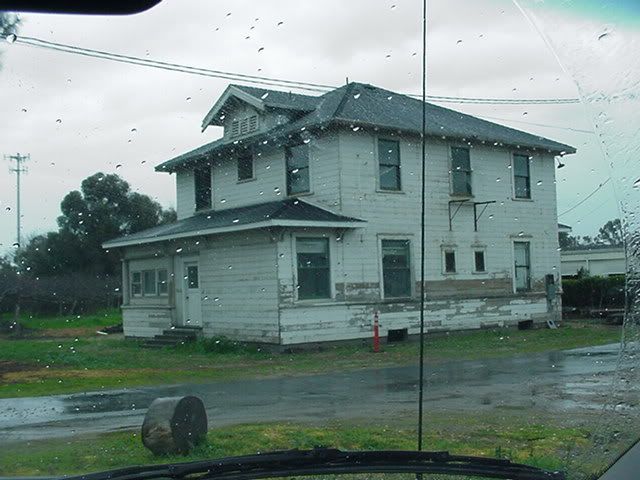

Below is a pic of a 110 year old house a friend bought last year for $1.00. It was the priest's house on the grounds of a historic Catholic church located about 1/2 mile down the road from my friends property. Moving the house, all permits, new perimeter foundation, fees to the power and phone companies and the Highway Patrol for the trip down the road cost another $45K. He had to re-roof the house, rewire it, plumb it to a new septic system, and it needs paint and repair inside from a bad toilet water leak that damaged floors and ceilings in several areas. He also had to either post a bond or deposit $20K in a surety account with the county, refundable upon passing his final inspection and receiving the certification of habitability. They told him they've had too many similar projects that haven't been finished and turned into abandoned eyesores in the past, becoming a public nuisance.
He's 71 years old, and doing the work on the house in his spare time between auto machine work in his on-premises shop. He says he doesn't care if he ever lives in it or not, he's just having fun restoring it!
