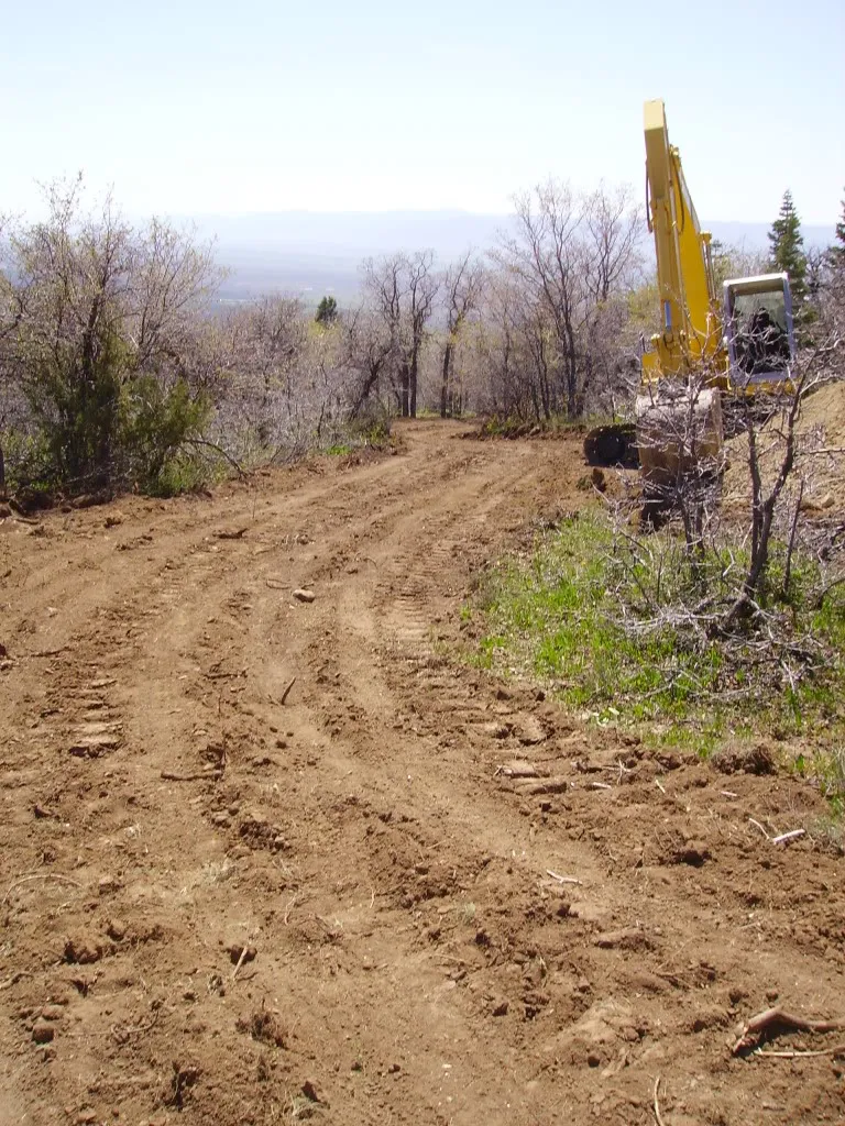

OK I have an update on what has been going on with this project.  I spent all spring trying to get the permits that I needed to start.  This took 3 months to get everything together.  ( Fire marshal inspection, ceptic and perk test, etc)  >:( I ended up having to go to an engineer to design my plans.  My hand drawn plans wasn't detailed enough for the building permit.  So I spend 1300 hundred dollars to make the plans look pretty.  Well I get to the building inspector and they the cabin won't be wide enough.  And I go what the heck.  Well in sanpete county utah you have to have a 20' X 20' minimum.  Well nobody let me know that this was a requirement.  So back to the engineer and more money.  After loosing another 3 weeks back to the building inspector.  I get another building inspector checking things out this time.  Everything breezes thru and I finally got the permit.   :) It only took 4 months and 9000 dollars.  Well now it is to late in the year to get the whole thing dried in so I go to plan B.  When I got the building permit I had them include a 12 X 16 shed.  So I decided to build the shed/bunk house first.  This will give a place to sleep and store our tools next year.  It will also hold the 4 wheelers and over flow of guest in the future.  So now I will post some of my progress over the next few day of where we are at.

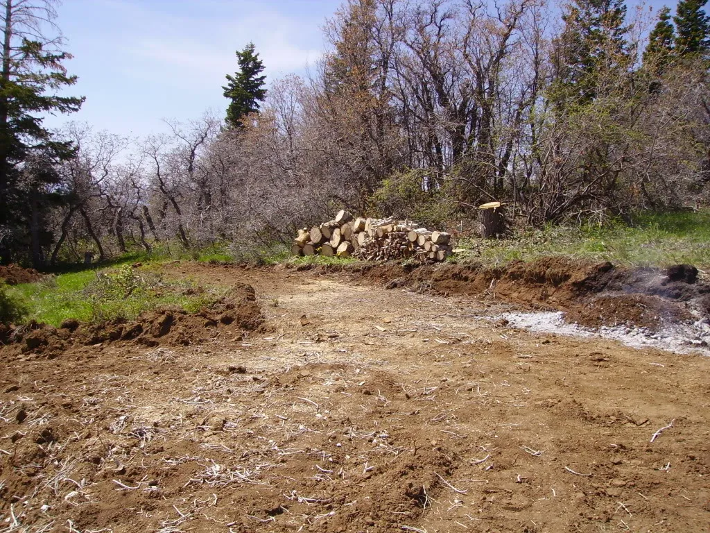

Here is a pictur of the lot before the road is cut in.
Next is the road cut in with the pad

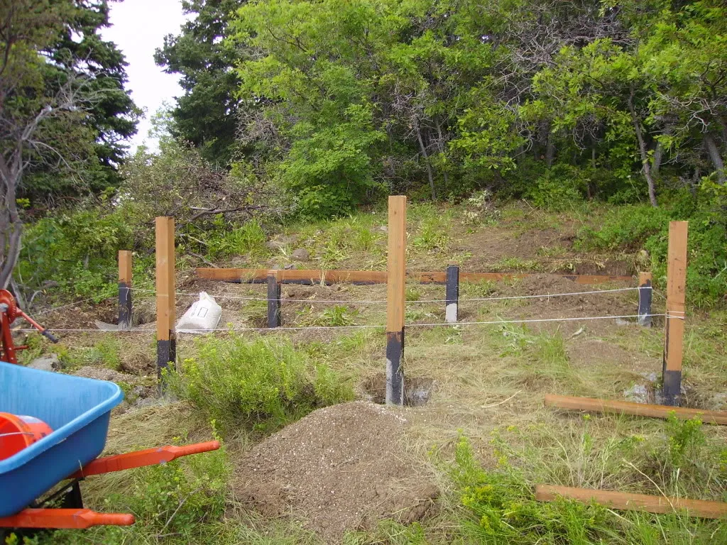

Finally we get started on the bunkhouse.  4 X 4 pt post with a layer of tar in cement.  These should last 20 years.

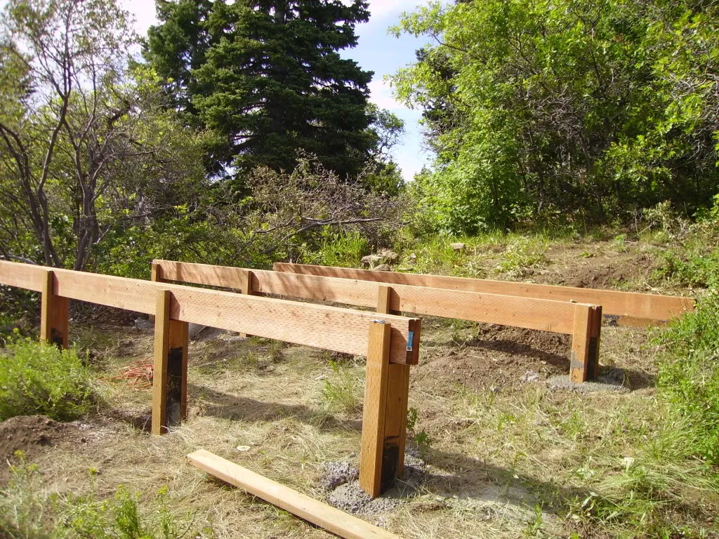

Now for the beams 2 16 2X8 pt

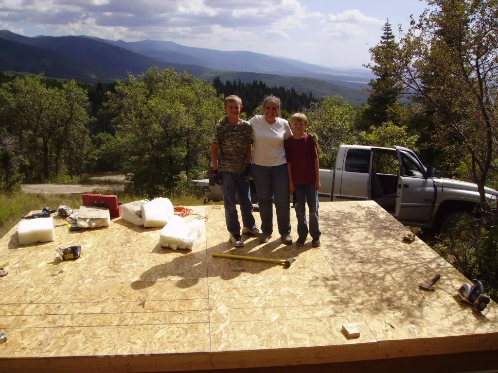

Then finally the deck.  This took 4 weeks to get to this point working only on saturday 6 hours a day.  Boy I wish I had my 30 year old body back.  This was the work crew for the day.  My younger step son out works the old 4 to 1.  O well it is good experience for them.

I'd get some bracing on those piers before I went much further.

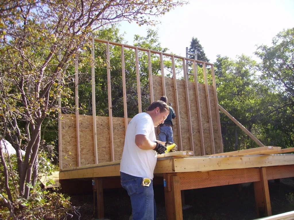

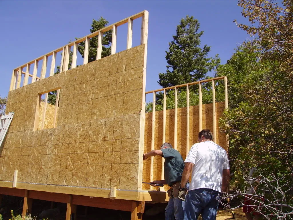

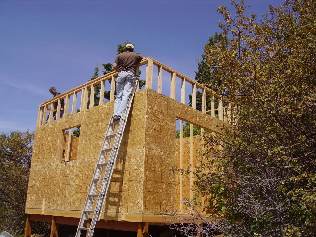

I have a few minutes so I will post some further past progress.  This day my father and brother in law came up and helped me frame the walls.  It was a hot day. 90+ degrees at the end.
by the way if you have the help put the sheeting on for the outside walls before you raise the wall.  it saves a ton of time and work.
Here we are about done at the end of a long and hot day.
