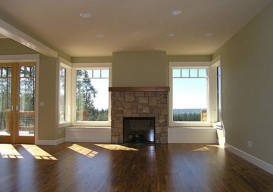

Tall windows with custom grilles can give you a similar look probably for less than a window and a transom.  If you get DH then you have an "openable transom".  When I looked at John's plans again, I see various windows with the custom grilles from 3DHA which I imagine would be the same ones in Chief Architect: craftsman.  You may also notice that the "reality" Victoria's cottage doesn't have all those transoms...could be because of cost too?  Window grilles can be on the outsites of the pane or on the inside and they can make pretty much any style you want so you could probably pull off the look pretty easily.

However, builders have told me several times that the most cost effective way to design for a new house (where new window and doors will be used) is to work with a local manufacturer and have them gang the windows and doors together so they go into a hole as a single unit. Usually such a company has a person who will work with your entire plan and work out the best way to have the transom and grid look that you want.
On a recent house we used Anderson's lower cost series of wood windows and our local representative got a very nice transom look out of the product by ganging fixed and opening windows together.
See the view from the south yard in these photos:
http://www.countryplans.com/bjork/
Then, in another house in the photos below we used single windows that were taller and setup the grids to work as transoms. This is using a 9' ceiling.
If you want to see other pictures of the above house you can download this larger PDF file: http://www.countryplans.com/Downloads/weiner-04.PDF

I think the windows above the french doors and the windows above the windows on the side of the house are separate windows and not part of a single assembly.

Not everyplace is so blessed and sliding doors are easier to screen than french style swingers. The cream colored house has sliders that look like french doors and has removable screens that are up part of the year.
The transoms and main windows on that house were assembled and shipped from the factory. That was cheaper than ordering and then installing individual windows. However they are separated by frames and trim - each is not one glass panel (as it is in the stained house).
