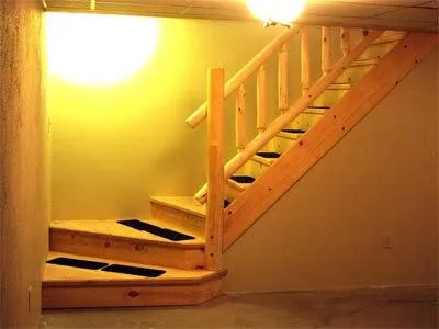

Oh goody, an excuse to post pix. ;)

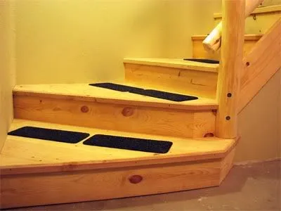

This is a project we did a month or so ago for a friend who finished his basement. The pitch is a killer at nearly 45 degrees... But there wasn't enough headroom above the stairway to extend them out any further. We just added on to the existing stringers and threw on a winder for affect, basically... Not sure how practical it is, but it looks cool anyway. 8)
What's the material on the treads Andrew? Anti skid something I assume.
I like the railing too.
I think he just put down some little mats to protect the wood until it's finished with something.

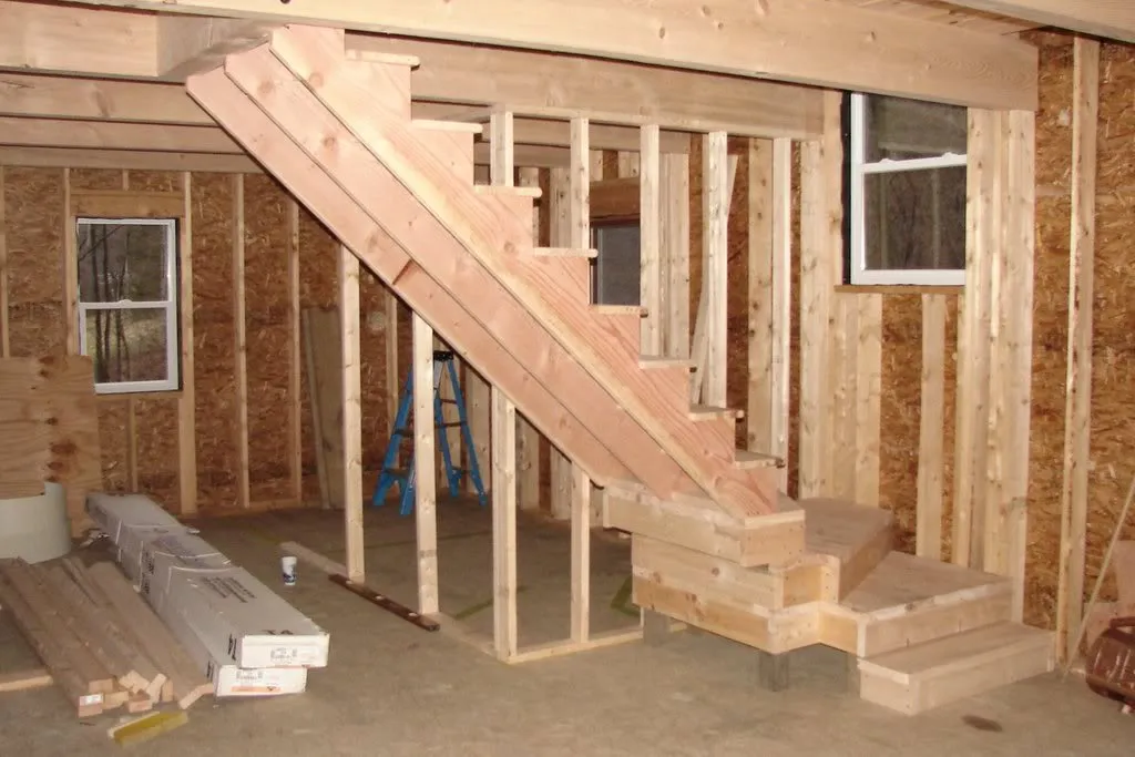

This is what I did for my 18 x 32.  I had to fit the stairs between 4 x 12 beams centered @ 48".

Thanks, they were kind of a pain... :) I like John's method of orientating the tread stock on the winders. Much simpler than trying to cut 60 degree angles the steep way...
It was kind of an interesting situation, adding winders to an existing set of stringers.. Not too difficult to box in, but it took some figuring to end up with an evenly wide tread on each step along the line of travel...

John_M, what are the dimensions on you stairs? Rise, run how tall are the treads and how deep? How much room did you have to the bottom of your floor joist? Thanks Pete

John_M
#13
I had an opening of 44" between my beams.
The bottoms of the beams are 8' from the floor and the decking is 9' from the floor.
I don't know my exact rise and run but I know it meets code.  It is just about the narrowest tread I could go with (run) and the tallest rise I could get.
Even the winders are code as well.  Minimum of a six inch width at the narrowest point.
I wanted to go steeper to save space, but I'm glad the code exists.  I want a safe stairway for my wife and son to walk down safely at night when using the bathroom.....
