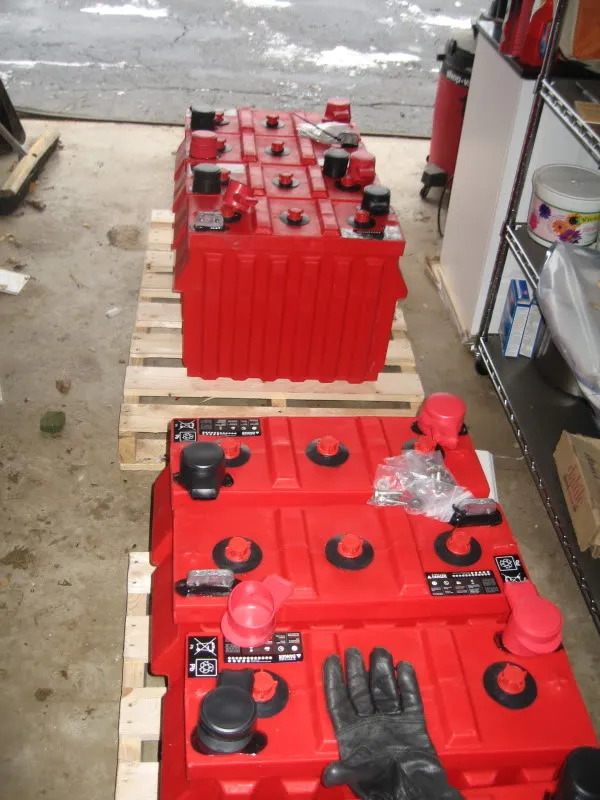

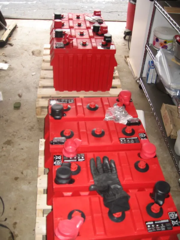

The BIG RED Batteries are here !!!
Surrette 6 CS 17 PS     6V 530 Amp Hour
all 1800 pounds of them
Ordered from the Solar Biz (very good people)  shipping was only $120
Way cool!  Those are the best batteries anyone on here has ever shown as their own.  There should be many years of great service.
Thanks Don for the Solar biz tip -- saved me $1600 over the next best deal
they have a 10 year warranty-- hopefully we will be using them well into the next decade -- supposedly individual (dead) cells can be replaced, too
at 50% discharge we should have 10 KW-Hrs of storage

Wow, those look almost like fork lift batteries.  Impressive.
Speaking of which, has anyone ever considered using forklift batteries for their bank?  I've heard of one instance, but never seen any discussion on the possibility, or not.
