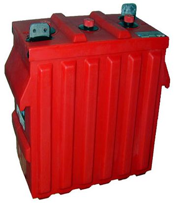

Just got the quote from the Solar Biz for the batteries
(thanks for the Solar Biz tip,  Don)
going with the 6V 546 AH   6-CS-17PS Surrettes @ $710 each
(8 of these for the 48 V bank)
the shipping is only $120  (at least that is the quote -- I think I better grab it before they change their mind)
at over 1700 pounds (220# each) I know I could not get them with the truck for that
This is exciting !
eta
I just noticed there is no handle on these things -- but it looks like there is a molded 'hook' on the side -- anybody know where to get a handle ?
AdironDoc
Wow, moving those around is going to either take some sweat or some thought. I'm not a burly sort and if I had those, I'd slice the bottom off a dolly and spot weld two blades extending forward like a forklift to catch those grooves. You could roll up, tilt back and away you go.
