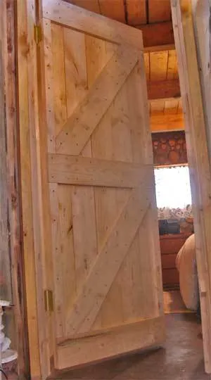

Love that door Glenn! :)
Only exterior wood door I've seen was made for a log cabin we had built a while ago. It was three layers of t&g pine, with the Z bracing in the center. It was a monster, and worked fine as long as we owned the cabin, but we never heated it in the winter and it had a big covered porch, so no rain on it.
We made most of the interior doors in our current house from green, rough cut spruce lumber:
(Before the hardware was installed)
The wood for that door was around $12...
The boards shrank a bit, but we had splines between them, so no gaps. The wider doors move a little, but we haven't had to re-adjust them too much.

It wasn't really made to be heavy - I made it because I had the center slab from my sawmill and thought it was too cool looking to throw away so found some more and made them into the door.  It is about 10 inches thick at the butt of the center slab.
Thanks Andrew.
The hardware -latch and handle mechanism  is made out of Oak with a couple of homemade steel parts - shaft and cam plate --  and has been working with no problem for about 6 years.

Thats a nice door Ern.  I love your door Glenn.  It is very possible to get good service from a board and brace door, but it will never compete in the long run with a frame and panel.  It the planks are not tightly secured with screw or nails, so that they can move, you will have a better chance.
If each plank is secured to the brace with two screws, one of the holes should be elongated, while the other stays regular.  On the outer boards, the outer screw should be static, and the inner one allowed to move.  This will keep the outer dimensions close to the same year round, because they will now be dependent upon the length of the braces, and boards do not usually move too much lengthwise.  The door will not stay as square though, because it won't be braced as tightly.  Then again, I have seen board and brace doors that were quite old.
I guess what I am saying is, go for it!  The worst thing that will happen, is that you may have to replace it in the future, but if you don't spend too much in the first place, that isn't a problem.  You could even replace it with a new door of the same construction if you want!  I was merely trying to let you know about the why's and wherefore's of the door making thing.

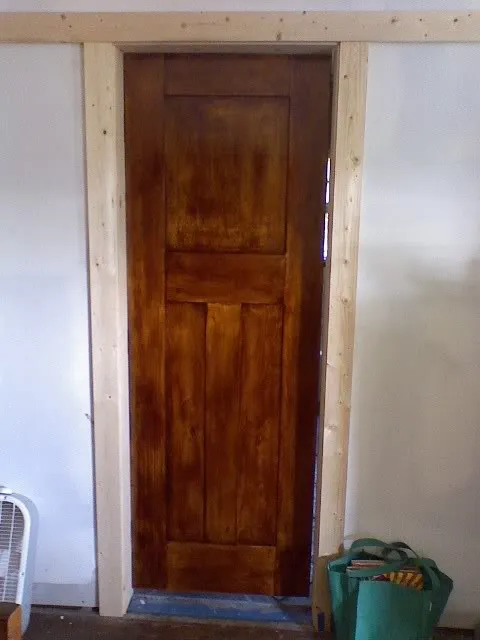

I have made my own casement windows too, and although they are not perfect, I am still happy with them.  If my bathroom door hadn't move to the point that the hinges were squeaking horribly, I would've probably never replaced it.
here is the door I built for our bathroom.
