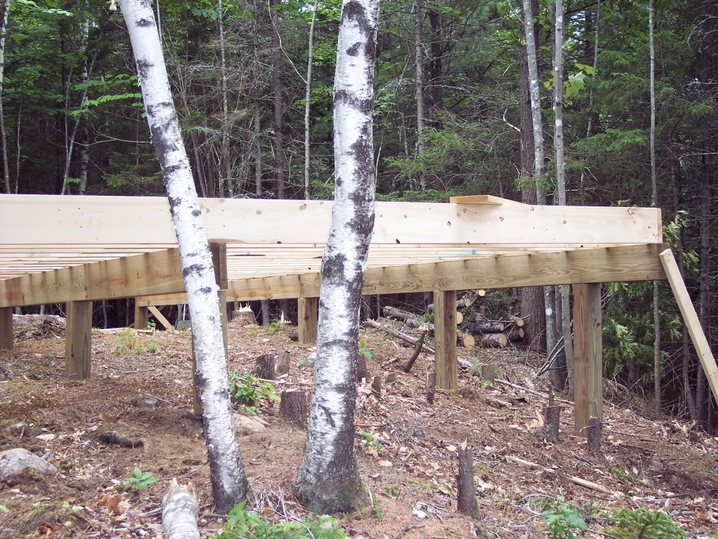

Ours are about 4-5' at the highest point, and less than 12" at the lowest. After this pic was taken we put on all of the bracing.
They sit on concrete or ledge.
