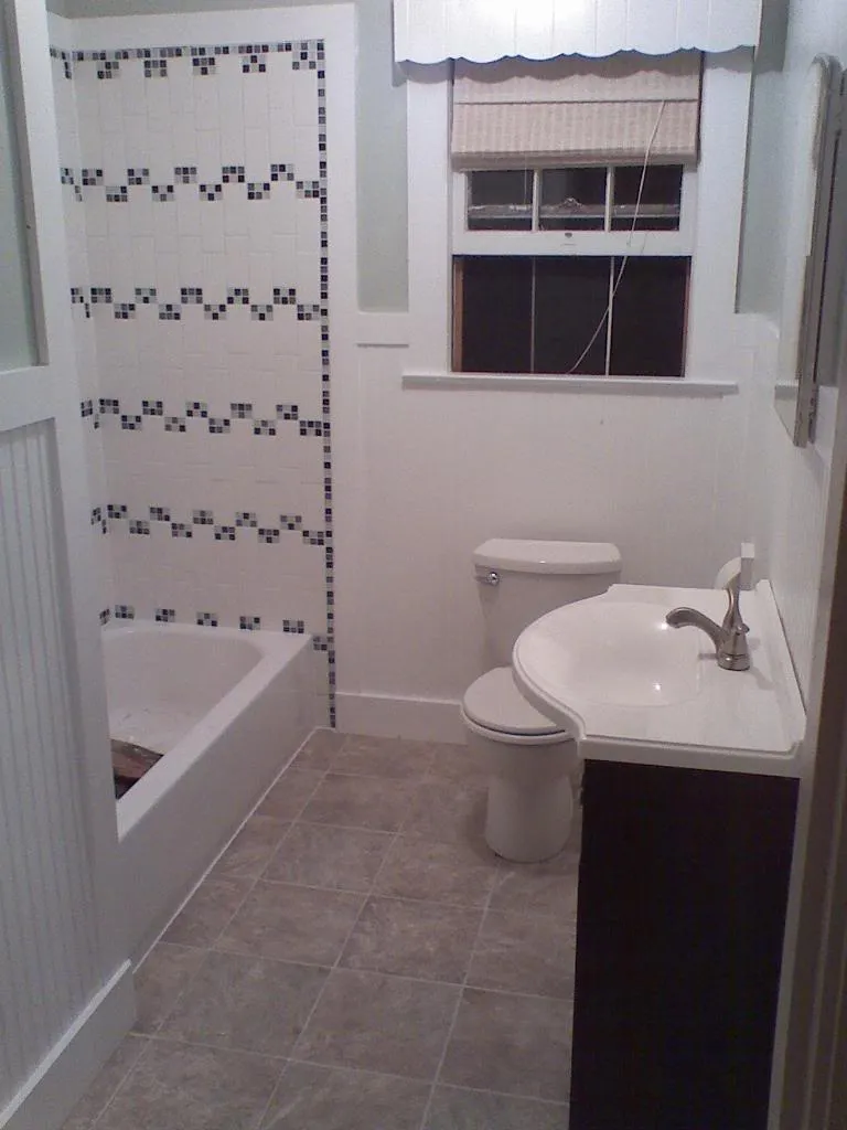

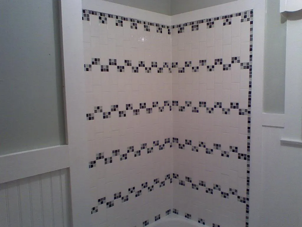

got some updates.  First off, my wife quit her job in the bakery about May, and we switched roles back.  I found work for a month, then had nothing for a couple of weeks, then gutted (all except lath and plaster) and remodeled this bathroom.  49 hours, in 3 days, because he had tenants moving in.

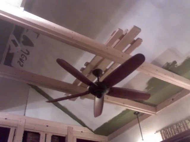

the ceiling fan was first

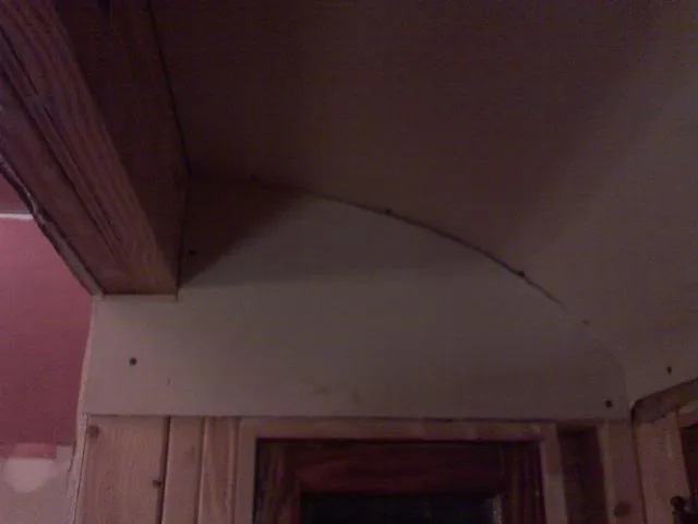

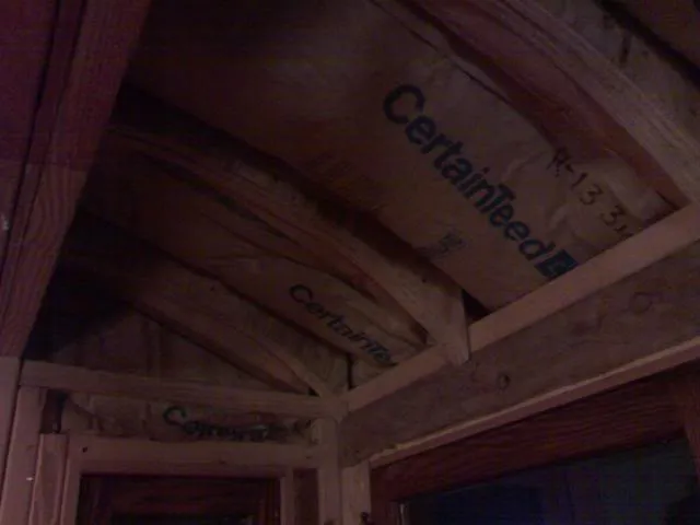

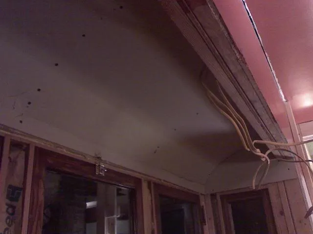

then I worked on the curved ceiling in the bump out.
first framing with two layers of 3/4" plywood cut to the curve and screwed to the sides of the rafters.
then followed with two layers of 1/4" sheetrock

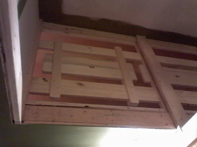

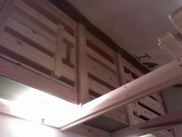

then the loft railing was requested before we hosted a get together the night after Thanksgiving with 5 students from UT's Hillel, and three friends.

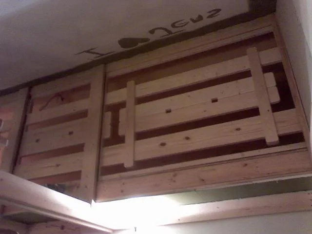

wife was cutting in a bit, and decided to write this on ceiling so that "you could read it when you are sitting on the couch and look up".  I guess she didn't realize she'd written it mirrored

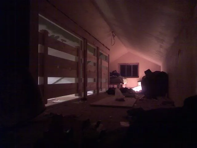

here is the view toward Patrick's (10 years-old) space.
They totally dig it.  It is like a fort.  All three kids have built in beds, which will have 3 drawers underneath them.  The girls beds are head to head, separated by a bookcase for each, and have special valances to make them, well, girly.  I will get photos of the beds soon.

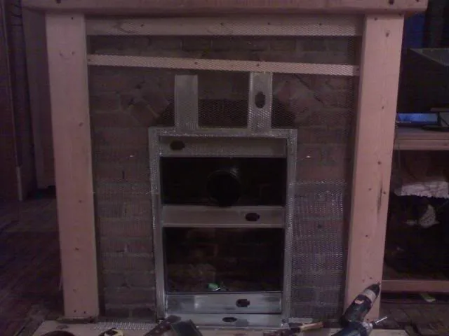

today I started refinishing the front of the fireplace, so that I can get the woodstove back in.  It is now ready for the coats of thinset, in preparation for the local tile we are going to have made.  The heath will be slate, and herringbone slate tiles will be on the panel that blocks off the fireplace opening.
This job I will be doing first, since we need to put the woodstove back in

Great curved ceiling.  Quality work on the railing too.  I wish I could even think of details like those.  Great job.

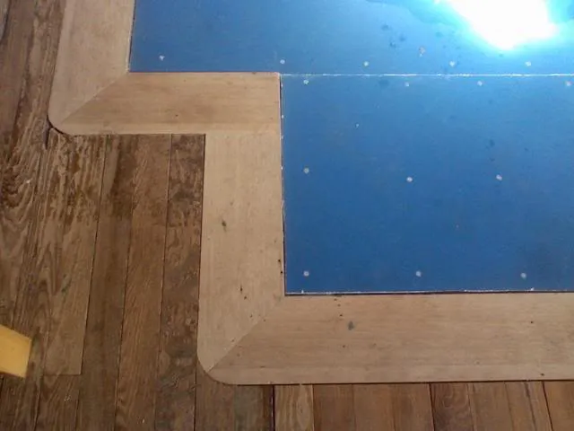

I just finished the oak border around the hearth, and will mud the front of the fireplace on Sunday, hopefully.  until then (next pics), gut Shabbos!

I got the fireplace ready for tiling.  The face is going to be custom made 5x5 tiles from a man at synagogue, the hearth 12x12 slate.  The opening to the firebox will have a panel of 2x6 herringbone slate.  Border is made out of oak salvaged from the big house.

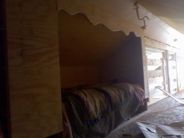

this is one of the built in beds in the loft.  Still needs to be painted, and build the drawers, and add a curtain.  A bookcase for each girl separates the two beds.
Jens nice work on the 45's of the transition.  I hope you allowed the distance of the grout joint.  I always lay my tile first then the transition but that's just me.

yeah, ok, Syd's bed
Didn't figure for grout, will cut tile to be what it needs to be.  The border needed to be what it is to replace some bad floor boards, and get me the dimensions that I liked for the tiled area.  Didn't have time to do tile first, and didn't quite know where it was going to be.  I also find it easier to massage individual pieces of tile, with grout joints, than pieces of wood which need to fit tight.

The kids totally love being in the loft.  I still haven't built the stairs for them, so they go up and down my 8' ladder.  Great part is that if they piss us off, we can take the ladder and then they're stuck! :)
Squirl
Great Bed.  I love the idea.
I like all your beautiful wood working, too, Jens.  Would have loved a loft like that when I was a kid - and the neat bed - you can be a part of what's going on in the rest of the house & still be in bed - best of both worlds!
