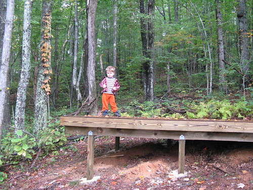

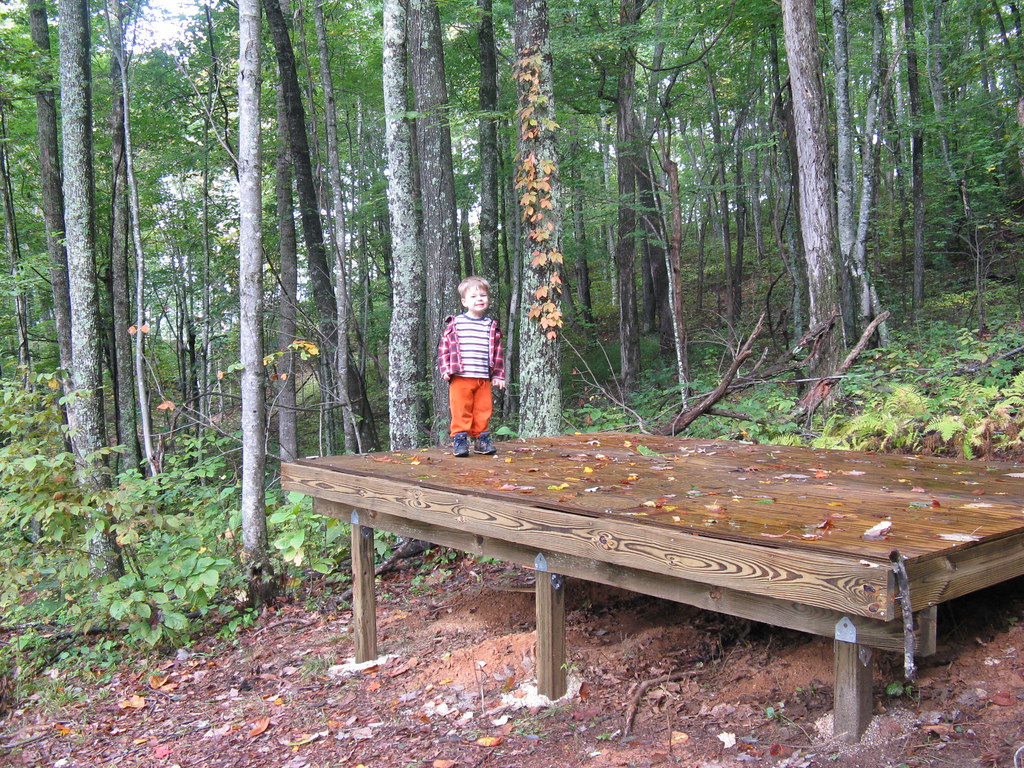

I've also got a deck built for an 8x12 shed.

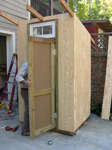

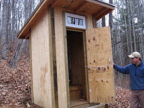

Made it up to the property last Friday - Sunday and got the outhouse installed and some other work done around the place.  I was pretty pleased with how quickly we were able to reassemble the outhouse on site and get most of the finishing touches done.  I still plan to paint it and install a vent pipe, but that can wait.  Now I just have to hope it passes inspection.
Here are some pieces and parts:
And the finished product:
It's not much progress as compared to what some folks on this forum have done, but it always feels good to get up there and get something done.  One small, though necessary, step towards building a cabin.
I also made some fixes to the shed deck.  I made a rookie mistake and forgot to trim the 8' joists down so that the building width would be 8' (instead of 8'3") when I added the rim joists.  I used a recip saw and a jig saw to get things straightened out.  Only took about an hour to fix.

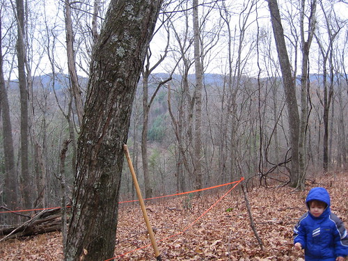

A neat thing that happened on the trip was the discovery of a view I had never noticed.  We've owned the property for a little over a year and I knew that we had a winter view of a short section of the North Fork of the New River, but as I was looking out towards the river this time I noticed that I could see much further upstream than I had previously realized - up to a point where the river makes a sharp turn against a rocky cliff that is maybe 30-40 feet high.  I'll definitely have this view in mind when deciding on the final location of the cabin.

pickngrin any progress is always good progress.  Make sure the privy is bolted tight.  I can just visualize the meditation and the sides fall down.  ;D   As for the view.  When the leaves come off your land usually takes on a new prospective.  Mine is a little on the down side as you can now see it whereas in the summer you couldn't. ;D
Haven't used ours in years but it didn't have a front door, so we could just sit there and look out over our subjects in the valleys below...
pickngrin
Not to worry, it's bolted down tight and walls aren't going anywhere.  Before building this we were using a luggable loo type thing. I went up with a buddy in October to do some fishing and one morning I turned around and there he was sitting on the throne up on top of the shed platform.  Whoa!  Don't want to see that again.
I can always remove the spring from the door to enjoy the view from the seat:
Of course an open door doesn't do much good to keep out the 3 year olds.  "Dad, what are you doing in there?"

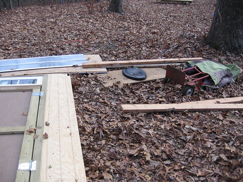

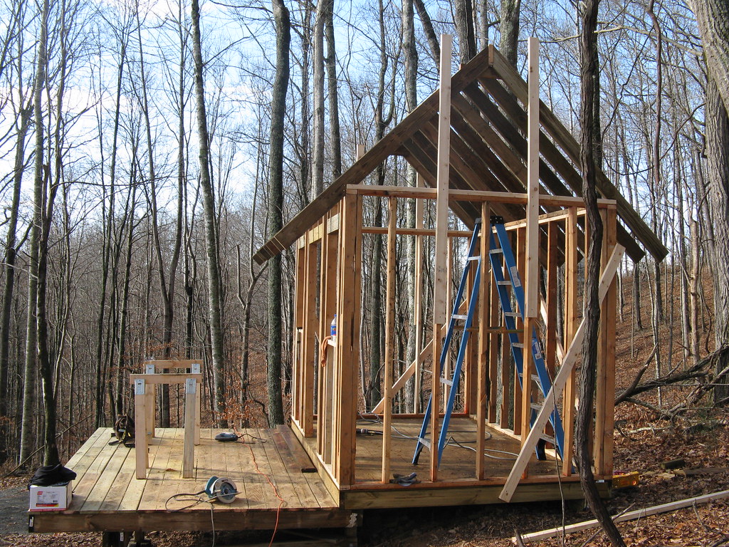

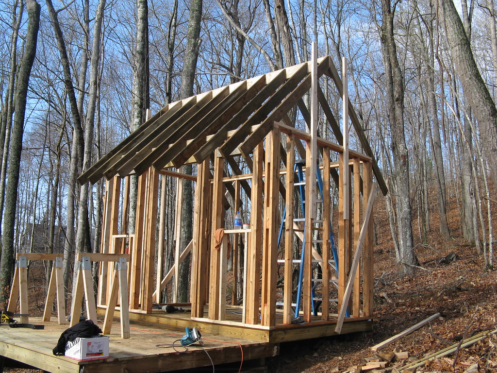

Hope everyone enjoyed the holiday season and are off to a good new year.  I had almost two weeks off for the holidays and got to get up to the property for four days.  My goal was to frame up an 8x12 shed/cabin prototype/future bunkie and build an 8x12 deck off the front.  Of course I let myself think about getting some siding and windows done if things went really well.  I accomplished my goal but no more, which is better than it sometimes goes.
I started with this:
. . . and ended with this:
I have done a very little bit of framing on a similar sized building several years ago.  The first wall on the shed went up in a flash, on the next one - the one with windows and a door - I was breaking out the John Wagner framing book.  I had never measured, marked and cut rafters so I had to refer to the book on that too.
I think I could've made a bit more progress had it not been for two delays.  The first was a dusting of snow the morning after I arrived.  It all melted by the afternoon, but it was enough to make the roads pretty slick and necessitate slower speeds and a bit of caution.  I was out in it early, pulling my trailer and waiting to turn into Lowe's and a guy behind me got sideways as he pulled into the turn lane.  I pulled forward as much as possible and he got it under control before crunching the trailer.
The second delay was caused when I was using my hammer to pound a 2x4 brace off one of the walls and as it came loose and tumbled to the ground one of the nails in the board went right through my air hose.  Hsssssssssss - oh crud.  I had to make two 40 minute round trips to Lowe's to get a new air hose and then to get some plumber's tape since the fittings weren't sealed in the package.  Nonetheless I was pretty happy with my progress, and, working alone, I was happy there were no injuries.
What do you think of the color scheme of my boards?  There are actually only a few new boards in the shed that you can easily spot by their light color.  I got the darker studs and the rafters from the local habitat for humanity restore.  The rafters are pt wood - picked up a bundle of 36 8' 2x6's for $100.  I got most of the decking boards for free from a friend who was having his old deck redone.  I love free stuff and am happy to keep good stuff out of the landfill.
Question for the forum: I'm planning to build a roof over the deck/porch but I'm not totally sure how to tie the rafters for that porch into the building.  I'm thinking of just using 2x4s for those rafters and then 1x4 purlins spaced every 2 feet or so topped off with 5v metal roofing.  It seems like the best option is to rest the 2x4 porch rafters on top of the cap plate of the front wall and next to the 2x6 main building rafters.  If I go this route though I'm not sure how I'll do the bird blocking between the main building rafters since a 2x4 will be running into that space.  I'm hoping to go with open rafter tails and I wasn't planning to build an enclosed porch roof, i.e., there will be no ceiling to the porch, when looking up you'd just see the rafters, purlins, and underside of the roofing.  Hope this makes sense.  Thanks for any suggestions/advice on how to handle this.
One more quick question - this will not be an insulated building so do I need to worry about venting the roof?

A little bit of cutting for the 2X4 in the Blocks but you could do it.  Notch the 2X6 blocks (1-1/2" X 3-1/2") on one end to allow for the 2X4 rafters.  If you went 16"OC on the porch you could just sister them along side of the rafters if you used 16OC on them.
As for the vents are you going to use sheeting or purlins on the roof?  Remember that the metal will sweat irregardless of insulation.  My porch sweats in summer with a rain.  If you are not going to insulate then I wouldn't vent it.  But I would sheeet it rather than strip it w/purlins.
I used 24"OC on mine but I didn't have to contend with sistering on the rafters.  You might also PU a pitch diverter for the metal because you will not have that much tucked under your roof from the porch.
I will also send you a PM
ED: repaired image tag - MD
pickngrin
Thanks for the feedback.  Redover - I'm going to use osb sheathing on the main roof.  I was thinking of sistering the porch rafters to the main roof rafters as you suggest.
I'm not sure I know what a pitch diverter for a metal roof is - I assume it's something to help keep water/wind out where two sections of differently pitched roof meet?
For some reason I can't see the picture in your post, but I cut and pasted the link into another Firefox session and can see the picture that way.  What do your porch rafters tie into on the wall side?  Do they go through the log wall?
A pitch diverter is a piece of the roofing material that has been bent to varing pitches of two roofs.  Usually 12" wide by 12' long.  One edge is slipped under the upper roof and the lower lip falls on top of the lower roof.  I guess you could do it with regular flashing if you  had to but it would not fit well on the lower roof leaving a gap .
I bolted a plate against the log wall and then used hangers for the rafters.
12 inch wide aluminum flashing is readily available and will easily accommodate any pitch change.
That is what I was saying but there is a couple of drawbacks to using it in this application.
1.  There will be a gap left when the flashing sits on top of the peak portion of the roof,  That being the distance or elevation of the peak & valley of the metal roofing.
2.  If you are in a snow region that will be where the snow will accumulate.  There could be a potentional ice daming problem and water will back up under the flashing. I think the diverter is pressed to the same design ( at least one side)as the roofing and a butyl strip is placed between the diverter & the roof and then screws to draw it tight.
But as they say it is just a porch so a little drip probably wouldn't hurt as long as your rocking chair is not placed below it. ;D
