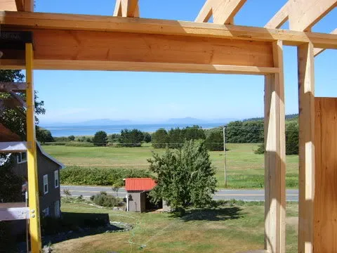

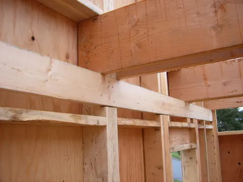

 What we do is nail the 2x's together and add a 2x6 on the flat under the header. The 2x's are held to the exterior side of the wall , giving nailing for sheathing  , exterior window trim/ siding. The 2x6 on flat generally provides plenty of nailing on the interior for any window surround and trim.
Tha being said there may be details of interior trim that would require added backing, each job has it's own special needs. So if your using very wide   casing you may want more backing.
This allows a 2 1/2" space to be insulated with batt insulation stripped down to the proper thickness. So all insulation can be done at the same time.
So no one needs to remember to pick up the   foam insulation.
The foam does NOT get wet , as it's not used in my example. IF you use the foam and it does get wet it could promote mold growth. No foam , no mold a win,  win.
2 1/2" of batt insulation will give a slightly higher R value,  I think , and is cheaper than the foam.
The other deal is the members are nailed together reducing the chance of warping , and common sense would say to 2x's nailed together would be stronger than 2 each , 2x's separated by a 2 1/2" space.
Edited to add the second photo.

My second header is spaced down  from the top plate, with cripples above as well as below the window sill. A header does not necessarily HAVE to be tight to the under side of the sub plate. High walls such as the ones in John's plans that accommodate the let in ledger would all most always have  header that was NOT up tight to the sub plate.
