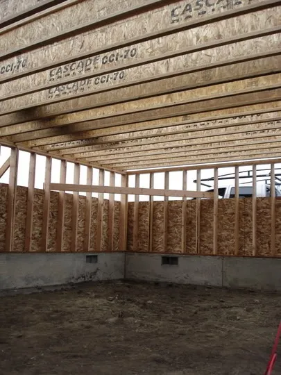

I'll frame a 6' pony wall for the floor system to sit on which will give me 7' to 8' head height in the crawl space after I gravel it in.- add a 12' wide roll up door and I'll have locking storage for Quad / Snowmobile etc.

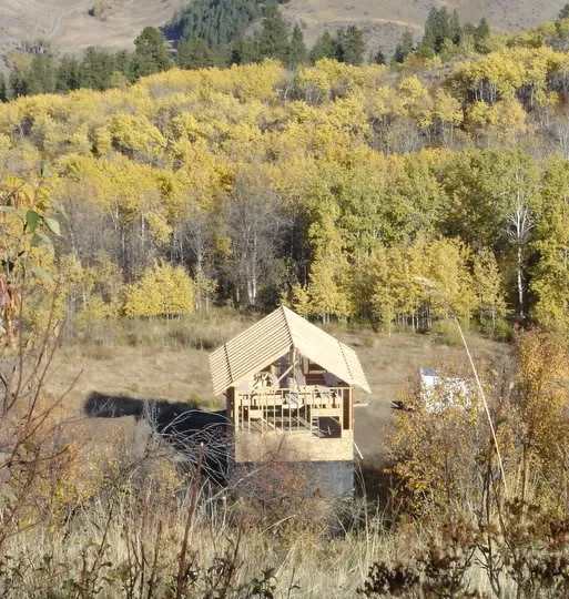

From the hill side above the cabin.  The aspen are really starting to change.

Sorry for the delay Lorangerlife but to answer your question... the lower level is basically an elevated crawl space- The plan is to put a plastic moisture barrier down and 3-4" of gravel on top.  We'll install a roll up garage door which we will be able to lock.  Secure storage for snowmobile, quad, small fishing boat etc.-  no access from inside the actual living space.

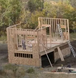

Here are a few pics of our progress- things seem to take longer these days-maybe I'm getting old- NOT!
Loading material for wall framing
First wall up
More walls

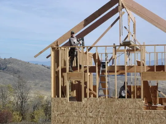

On to roof framing

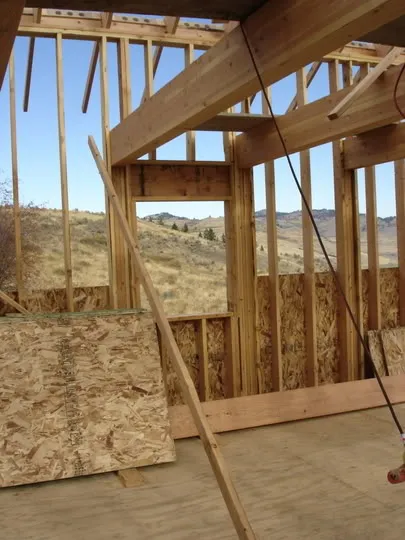

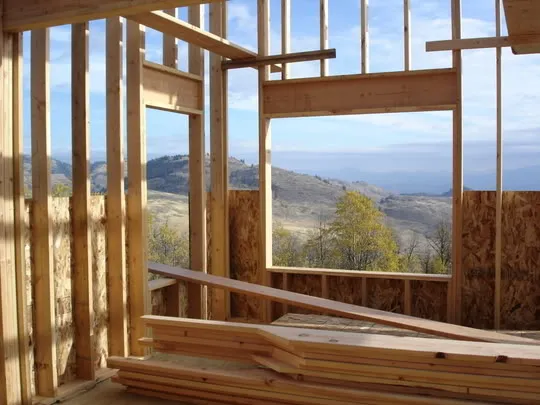

View from inside- note the pile of 2x12 Doug Fir rafters
More roof framing- the hardest part was setting the ridge- 2 2x12 sistered together with 2x4 running the full 30' with a steady 15 mph wind from the southeast
Rafters complete on to bird blocking
This view shows the 5-1/8" x 12" Glu-Lams on 4' centers
