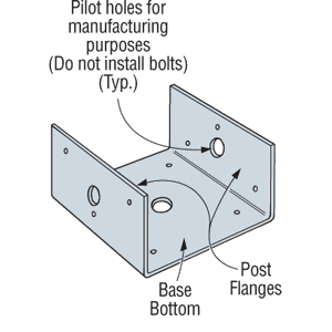

I was planning on using this bracket to attach the beams to my concrete piers. I poured 10'" piers and the built up beams will be 3 2x10's with plywood in between. I was going to use this type of bracket to attach them or 5/8 all thread with a steel plate on the top. The all thread would go through a steel plate that is on top of the beam and then down into the center of the pier by at least 8" and would be epozyed in. What do you thin would be better? Thanks Pete

If the plate is flat it seems there would not be a way to attach it to the beam - unless it extended past the peir.

PEG688 suggested the all thread way. Here is what was suggested
    "Well with no code to meet and what you've described is a solid post and pier setup , I'd epoxy into the pier a piece of Galv. threaded 5/8 rod into the concrete at least 8 " that sticks up at least 1" above the beam tops ( if it's to long you can cut it off , the projecting rod , later with a sawsall) then you could use a piece of steel bar stock 1/4 thick and as wide as you built up beam , so a 1/4"x 5 1/2" x 5 1/2" steel washer at each post to beam connection."

PEG knows what he is talking about - he is talking about putting the all thread all the way through the beam for the connection with an inch above for the nut..  I'd do that.
I was assuming the plate was on the bottom.  We have talked about adjustable anchors also - could work with a nut - top and bottom and 2 plates I think.
Looks like he recommends a full size plate washer on top.

  #1: ya what Glenn said all thread epoxied into the concrete pier say 6 or 8 inchs. Then a square bearing plate washer the 3"x3" type  on top or let in along with the bolt so it doesn't stick up and get in the way of your sub-flooring and wall plates.
