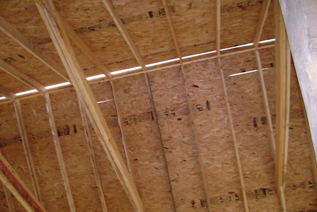

I am contemplating the idea of having cathedral style ceiling in the loft area of the 20x30 1 1/2 story cottage, as demonstrated in the illustration. Have any one done that? If so, what was the hight used to put the rafter ties? what lumber dimension was used for the ties and rafters. Note that I live in Quebec, Canada were we have lots of snow.

Heavy snow load would likely make you want to keep the ties as low as possible for more bracing -- although you may want to have a local professional review it to make sure you are strong enough.  Do you know what your snow loading is?

Welcome Sharbin. I stated building my 20x30 1 1/2 story cottage in Quebec last summer. I used 2x6 for the rafters and 3  2x8 side by side for the ties and I went with an 8 12 pitch 35 degrees roof.  I went threw this winter with only 2 ties I will be adding one more closer to the loft .

Our camp is just like that. We added a center post, eliminating the need for collar ties, although we will still use very short ones. We have a 8/12 pitch, and there seems to be plenty of head room. By the looks of your plans, you are using 10' walls, correct?
We also had a massive snow load this past winter. The upper post was not in place all winter, but it did not sag!

Yes MaineRhino, I have a 10' walls and as per plans, the top of the loft floor is 1' 3/4'' below the top plate and the roof pitch is 12/12. Why did you choose the 8/12 pitch? Wouldn't the 12/12 give you more head room? Also isn't the higher the pitch the lower the snow load effect is ??? Are your rafters lying on the top plate?
MaineRhino
An 8/12 pitch was easier to work on. A 10/12 would have been better for headroom, but it feels very roomy up there with the 8/12 !  Also, I like the look of what we chose to do.
And yes, the rafters are attached to the top plate.
We had record snowfall this past winter, and we had no collar ties in place, and no upper post to support the roof. We had no sagging or spread from the snow load.  No worries now though!

Not sure if my information will be of help, but may provide some insite.  I installed 2 x 8 rafters with a 2 x 10 ridge board in my 16' x 20', single room cabin.  It has a 6/12 pitch, and is vaulted below, with 4 exposed 2 x 10 collar ties, at every-other rafter.  The walls are 8' and the peak is 12', so I put them half way at about 10'.  The inspector had no concerns when he was there, and did mention that snow loads in that area have been measured as high as 80lbs/sq.ft.  My place is in central WA, about 15 miles from Canada, at 3,000 ft elevation.  The cabin has now gone through two winters, including this past one, when there was about 3' of snow on the roof for an extended period.  Roof has been solid, and no bulging of the sidewalls.  Exposed collar ties are a bear to sheetrock around, but well worth the effort, in my opinion.  Just finished hanging the ceiling rock this past week, and will be posting new pics in my thread soon.  As a local sage from up the hill told me when he saw the roof framing:  "That place will be standing longer than you care to use it."
