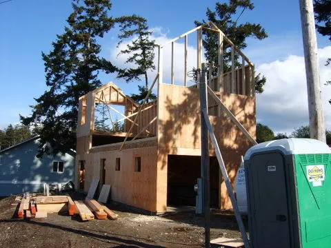

Our "front" (20') wall of the 20x30 has 9' walls with 12/12 roof, i.e. 19' high in the center.  It's also built of 2x6s and a fair bit of bigger stuff thanks to snow load (6x6 post, 4x6 studs for shear wall sections, 4x8 over windows).  Is this reasonable to pull up in one go with 4 or 5 (reasonably strong) people?  Do we need jacks? I've done 20' 2x4 walls before without problem but this seems to be a lot bigger and heavier and I don't really want to build it then have to bring in a crane!
You won't be able to reach high as it goes up - seems it may want to smash you as it goes over center.  At least some thought about how you will handle it may be in order.
This will be long and hard to follow but here goes.
  #1: Wall jacks will help a lot .
     I take it you are going to frame the gable with a  modified balloon style.
Like this ,
I jacked this at the blocking line , not on the rafter slope. Worked great.
     What I do in this case is frame the wall , then lift it so you can first get a 2x4 block under the wall.
      Back up a bit , this assumes you have toe nailed down the bottom plate so the nails act like a hinge of sorts . This also assumes that you've done that toe nailing before you sheathed the wall , it ensures the bottom plate is straight , because of course you snapped lines and squared the walls up on your box sill .
Lots of assuming in all this.
So assuming all thats done , we've squared  up , snapped lines , toe nailed the lower plate down , sheeted the wall , now where ready to setup to lift it.
So up a bit , 2x4 block under top plates , now take a 2x6 and use it as a lever  and hoist the wall up so you can sneak a couple or 3 saw horse under it in as far as you can put then.
#2 : As Glenn mentioned it gets high fast so ladders need to be ready for the jack guys.
Have you used wall jacks before? Do you know the basics of how they work? nail a block behind the post so it can't slide out , etc etc??
  #3:   Once that wall is up about 8 feet attach a couple , maybe three One right at the peak or as close as possible , with one nail driven all the way in . They will pivot and act as a hold backs handles  (when  the wall is all the way up ) , they also can have blocks nailed behind them to act as breaks IF the wall gets away from you for some reason .
Run like hell if it does , no one will stop it IF it does and NO ONE needs to get crushed by it . Just let it fall and start over  IF this happens .
  #4: So as it gets higher the weight sort of gets easier to deal with , I also attach one 2x4 brace on each end of the wall , you can do this right away , again one nail  , near what will be the top of the wall , lay the 2x4 the opposite way the wall is raising as the wall come up those end wall braces just follow along and  are there to hold the wall without the old , "Find me a stud for a brace deal , and hurry the heck up !" if you do it right it's hanging right there all you do is nail it to the block sill and then add another nail at the top .
So all that is more than likely confusing as hell.
But if you read it and think about whats happening at each stage you'll maybe figure it out.
Nothing is ever simple to write out like this . I can do it in my sleep , but writing about it is another thing.
Ask questions , try to be specific about whats not clear.
This shorter wall we just lifted , 3 of us I think , with two guys the wall jacks would be easier.

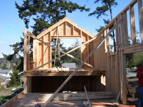

Thanks a lot for all of the great info - the description was pretty easy to follow.  This part of the project is still a way off, but it is definitely one of the most intimidating parts of the build and a part where experience beats any amount of thinking about the problem!  Having a picture in your head of how the hard parts happen makes it more comfortable moving forward on the easier stuff.
I've not used wall jacks yet but can try them out on the shorter walls first.
And I guess this wall is modified balloon style.
(apologies for the bad scan).
I'd suggest,
  #1: moving those two 4x6 outward 3 1/2"  so they could be one piece from the bottom plate to the under side of that upper window header.
  #2: I'd also use 4x6 LVL for those , as they will be stronger and more importantly will be straighter and STAY straighter long term than a D.Fir 4x6.
  #3: Then use standard 2x6 trimming under the , what I assume is , front door header.
#4: Yes that will change the upper window sizing a bit , at least the two outer ones will be smaller , the center one could stay the same size if you added the same type "trimmer" inside the 4x6 LVL's , the mullions would be wider , and the outer window smaller.
It might look cooler if you stepped those two outer window down a bit at the top only , so if they (all 3 where) where 3'0" windows keep the center one at 3'0" but get the two outer ones a 2"6" . That will do a few things , all good IMO.
#1: Make that gable Look better.
#2: Give you a stronger wall by one piecing  the 4x6's .
#3: Move the two outer window down and away from the rake board trim.
  You'd still have the same look just  a stronger, straigher (long run),  better looking wall.

This all seems a great idea.  I guess with the current framing there's not a whole lot preventing the wall folding at the top of the window/door headers (pretty much nothing until the roof's sheathed!) - something I hadn't thought about before.
I think I should probably do something similar on the other gable wall.  Currently it's platform framed (due to a loft) and simpler 'cos the center line is free of openings.  It's currently drawn with two sections of 6x6 to hold up the main roof beam, separated at the 9' high top plate.  I'm thinking I should really run the 6x6 all the way up so that it's also less likely to fold at the top plate there too.  And make this LVL too?
With this stuff, I guess there's a big difference between a "house designer" and someone who actually designs and builds houses.
Thanks again for the great advice - I'm gonna print out a copy of this thread and keep it with the plans so I don't forget any of the details.
Your welcome.  BTW I don't do much design work , I just tweak whats given so it works better.  ;)
  I just noticed your side window are dropped down :-[   , I guess I was rushing , well,  I know I was rushing to get off to work  ::) and missed that detail.
  Yes the  longer 4x6's will stiffen that wall and make it easier , well stronger to raise with the jacks.
I had thought about in my mind using continuous header over the door and lower windows , BUT I think the longer 4x6 "give" you more of a stiffener for that wall.
Big walls like that tend to flex a little in the wind and they really can flex when being stood up.
Remember to take other point loads / under 4x6's , all the way to direct bearing.
In other words IF you have a box sill , block with solid blocking directly under those two posts , all the way to your sill plate / or to the beam that also may be under the post. Depends on your foundation really.  But that load should be transferred to  soild / direct bearing. Lots of point  load there!
