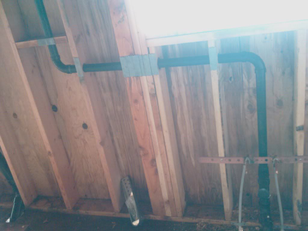

Here is a picture of what the pros did on the Oregon Coast.  This passed inspection on a job just down the hill from me.  This is not my project, but perhaps a picture is worth a thousand words.
It's not uncommon to see pipes installed like that. Not the best practice but it usually passes inspection.

Mike it looks as though they cheated a little by cutting a channel from the face of the studs rather than drilling.  Personally I wouldn't want that even if it would pass inspection.
