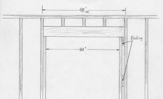

I'm making some drawings to night. What's another one?  :)
Rather than use a full extra stud to space things out correctly, how about this...
Studs are all 16"OC. I'm always interested in saving on materials as well as improving insulation. Yes, I know I'm splitting hairs on this at times...  :D  Use blocks to space the one trimmer stud out the extra 1.5". It might also simplify things a tad by cutting the header as illustrated.  :-\
