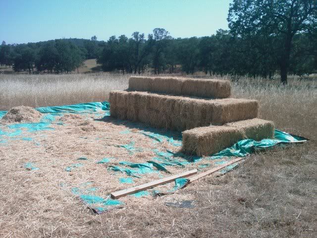

They even let me help unload and stack the bales!

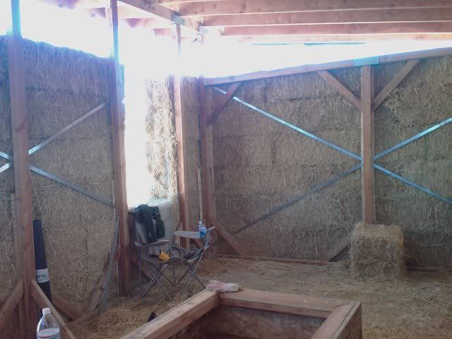

Pieces of vinyl flashing made placing partial bales WAY easier.
It sure helped sliding them along the courses, too.  After the first course we could place them all from inside the building.  This made the work a whole lot safer.

The waiting window bucks make a great place to put tools out of the way.
Once we got the air to stop running through the sun, it cooled off a lot.
We blocked a window with bales so we could slide other bales on top of them to build the back wall.  That was another great idea from Dave.

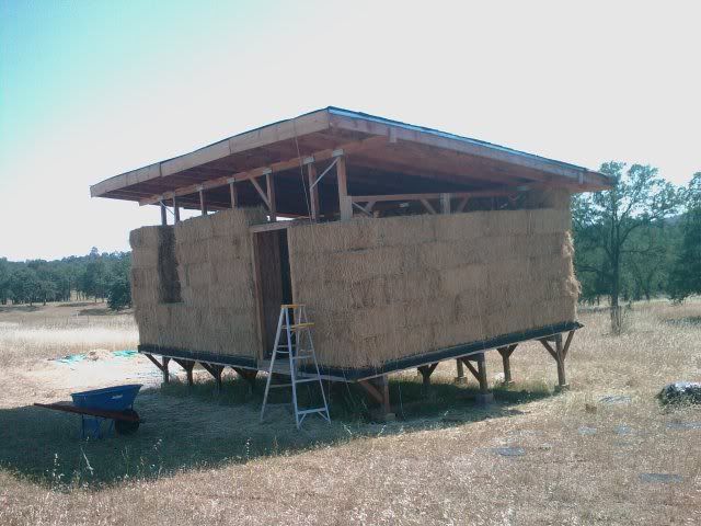

We're not done yet, but here's the 28 bales remaining from the 126 we started with.
An elevation.
Another.
Another.
And another.
We have a few more whole bales and a bunch of partials to go.  We've filled in the cracks between the bales, but we still get to even out the faces of the walls a bit and get the stucco lathe on the outside.

Drew you are past my area of expertise when it comes to building with bales.  Most of my life I have baled, stack and feed straw and hay bales but never built with them.  My hats off to you.  I do have a few questions.  Is there any structural security until you get it parged or stucco?  I think I would have to use some baler wire through the bales and anchor them to what structural support you have.  The wire would be easy to punch through the bales on either side of your post and diagonal bracing then twisted to secure. Even noticed that you have chicken wire on the interior.  I could even be wired to that.  I would be afraid that given the right amount and direction of wind that they could be blown out of alignment.  Bales stacked interlocking in a pile are usually secure but in a course stacking there is not much support.   How are you going to attach the wooden sills for the windows if there is plans for any?

Thanks for the good word.  The first course of bales rest on two PT 2x4s laid flat and parallel with gravel between them.  The outside 2x4 has a bunch of 20d nails sticking up to hold the first course of bales.  The bales are tied to the posts with plastic twine and the whole treatment gets stucco lathe inside and out.  The bales are also stacked in the interlocking pattern.
The windows will come out flush to the outer edge (No sill) and I'll flash, caulk, and trim the edges.  They'll have that nice curve on the inside, but not where the water can give me trouble.
