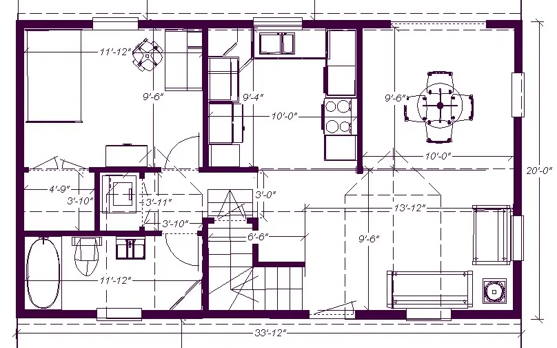

Here's my rough ideas...
[/img]
[/img]
The 2nd floor has a full shed roof in the back.
I'm planning on doing platform framing with 2 ft kneewall upstairs.
I will probably redo the 1st floor bathroom to make a hvac closet in back of the bed closet.
Let me know what you think.

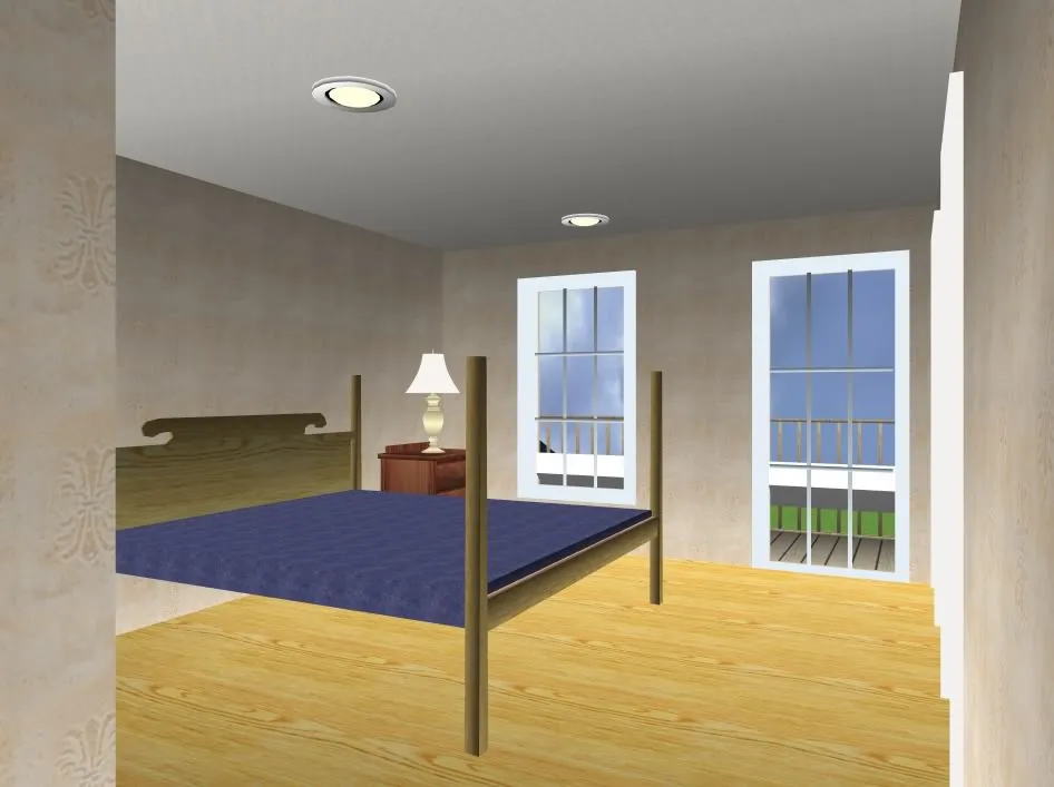

I rearranged the whole 1st floor....
I have to have code stairs, I coudn't make it work the original way.
I also have some renderings....
2nd floor is next....

Looking good. The layout seems well dimensioned.
Looks like you're getting more skilled with the program each time you post images.[cool]
