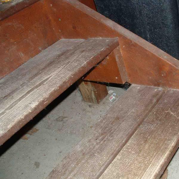

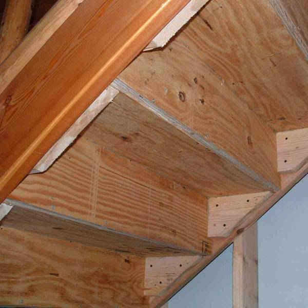

I have had good luck cutting wedges out of 2x wood and gluing and screwing them to uncut 2x8 stringers to create supports for the treads and risers. For outside applications I then attach 2x treads to the wedges.  For inside applications I use 3/4 plywood for the treads and the risers.  I screw and glue the plywood joints between the stringers also.  This creates a box beam effect which provides strong and squeak free stairs that only require a pair of 2x8 stringers that do not get cut.  This method allows stronger more squeak free stairs to be built with less material.  (From John R: I'll post the 2 pics below.)
BassLakeBucki
Thanks for the ideas! I built the steps a few weeks ago using treated 2 X 4 stock bolted to treated 2 X 8 stringers as you show in your pictures. The strairs came out great. I will get a picture on my next trip up. Using mostly scavenged treated lumber, they cost me less than $50. I had to buy 4 X 4's and some landscape timbers. I took John's advice and adjusted the rise adding an additional step.
